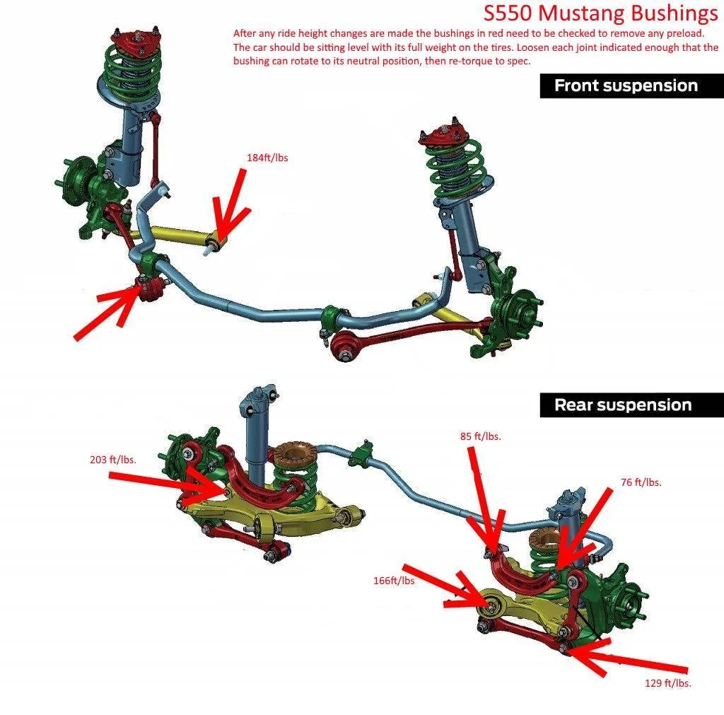

Did you clock the bushings when you lowered it?

Which bushings would need to be clocked? I don't remember if they were or not.
To be honest I'm not sure. I'm still factory height but I've seen other threads pop up over the years having similar noises after lowering their cars due to this not being done. Hopefully someone with more knowledge can chime in.
I found this recently as I need to do mine :
WD :like:
Damn so now i need a pit style garage so i can get under the car to do that work. Here it is i bought a lift to be able to work under it. LOL.
WD :like:
Thanks man. Very helpful. Will look at it this weekend and give you guys any updates. Hope the S650 takes all the s550 issues and fixes them lol.
