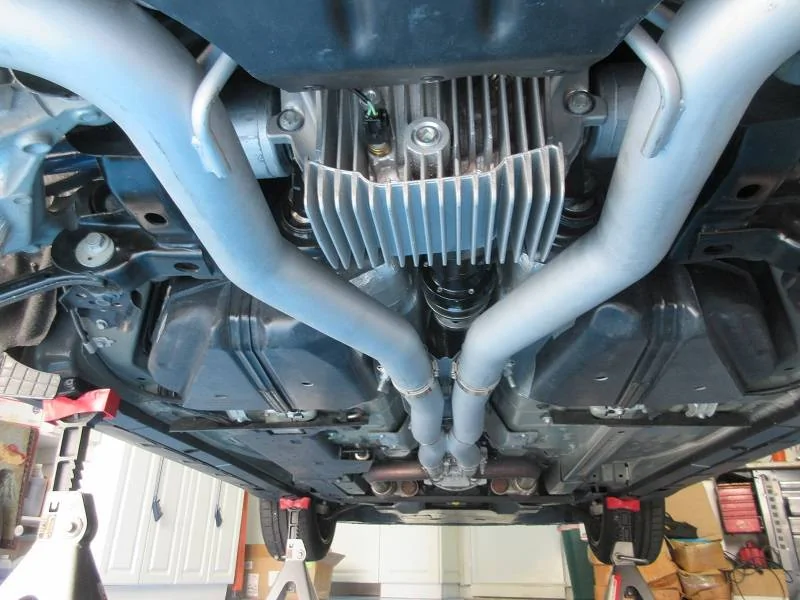

The FluiX rear diff cover is now installed, and ready for some temperature tests.

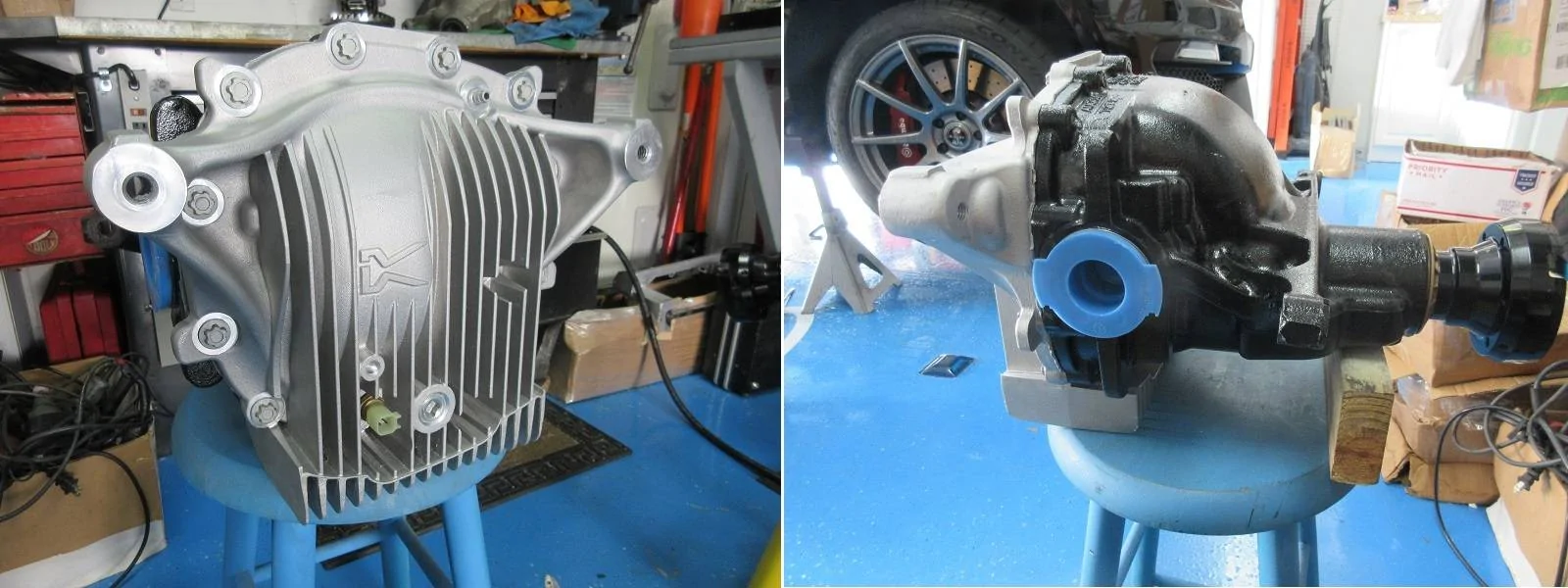

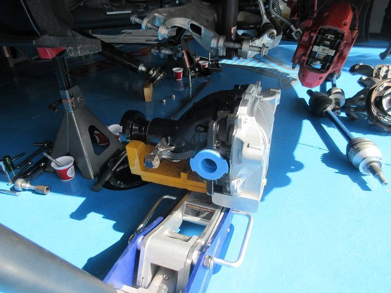

The carrier w/New Diff rear cover ready to go into my car.
Carrier: (Iron Housing, 3.73 Gear w/Torsen) Car: (2016 GT350)
The Install went smoothly and the fit is very nice.

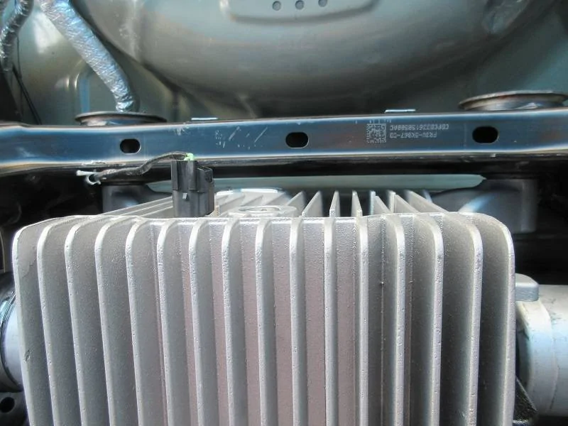

Here's a picture of the Clearance between the rear of the cover and the subframe. About 1" of clearance.

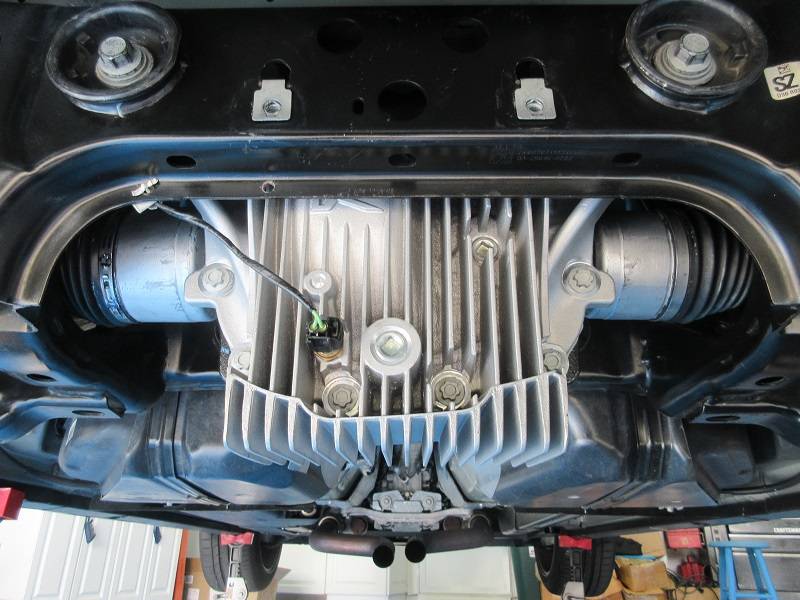

Picture of carrier installed before Exhaust went back on.
Here is finished installation with everything buttoned-up. Now I will be doing some temperature comparisons and tests against my previous readings from the "Stock OEM Cover"
One thing is for sure: This is a nice looking piece!

I think the filling hole needs to be extended outward like the draining hole.

The FluiX Diff Cover is now installed, and ready for some Temperature Tests.
The carrier w/New Diff cover ready to go into my car
Looking good!!! Eager to see if it keeps your GT350 cool.
This was a consideration. The problem with this is that you may not be able to fit a standard tool between the oil plug and the subframe to twist it out the oil plug. On John's pictures it looks that there is more space than in reality.
