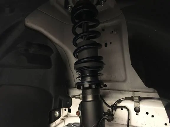

Bumping this with some tid bits you may be interested in.
1. You can flip the L and R struts to move the swaybar mount to the front in order to use stiffer bar settings.
2. Camber plates. I'm going to try adapting Pedders camber plates. The reason is: you can leave your camber settings even when changing springs. Just have to get the ride height the same and your alignment won't be affected. How: the thread for the Pedders is M14. Ridetech is 9/16"....just slightly bigger. I'll test fit before, but my plan is to drill out the spring perch adapter of the Pedders plate that goes into its top bearing from 14 mm to 9/16".
