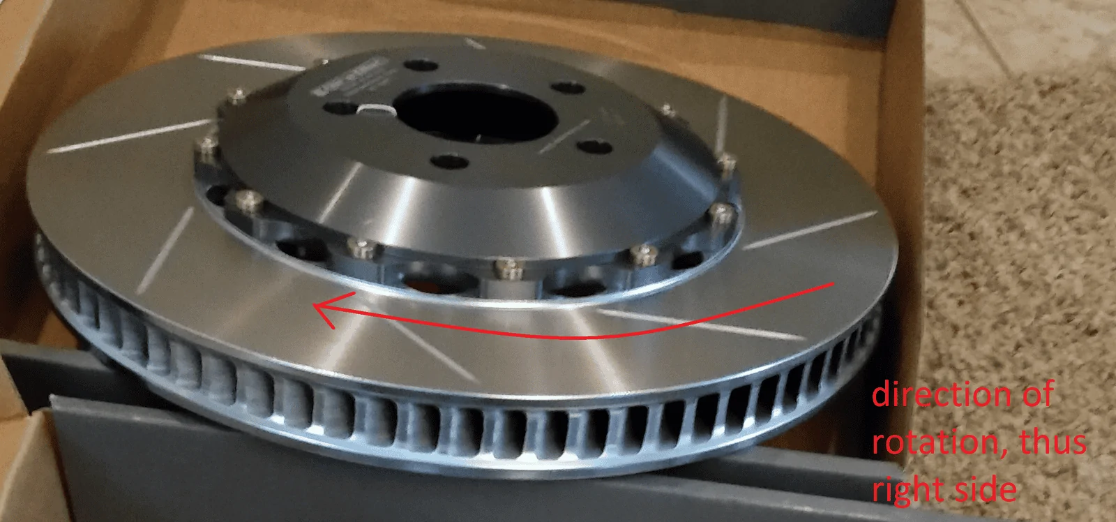

Its OK, unless we don't want the cut of the rotor to access cool air, right? the opening of the veins should capture new air, no?
Looks like I arrived with the right handle haha
This was my thinking or lack thereof.

I think ive earned a knickname. :doh:
EDIT: Can we hide this thread lol
EDIT 2: These rotors will last forever with this unique break-in procedure! Totally planned this!

It happens, just ask my first car with a BBK (bought it that way though). Didn't know til my first trackday that they were backwards. And even swapped last minute to forwards, they still had pad deposits after 3 laps. Rotora is show, not go... but, lesson learned.

Appreciate the non-flame! Too kind, I laughed at myself quite a bit and deserve a few zingers :)
Hopefully not too harsh :D

we all live and learn, I've seen much worse on this page.
:cheers:
watch out for GT_Roadcourse_Expert !!!!;) thats a joke, son
good thing im easy on brakes haha
easy on brakes was quite important, as it turns out, sheez. how to live this down.. :)

John, your first picture of the Girodisc's in the box, the one with the right tag on it. It is correct. The leading(outside) edge of the slot should contact the pad first. Curved vanes should appear to run backwards (like the air is folding over the vanes) from the outside. I can't see the picture of them on your car but if you put them on by the tags you had it correct. People always think the outer edge of the vanes catches the air, its opposite. Don't get hung up on the slotting, vane direction dictates installation. Install them like THIS (for curved vanes)

One more link - directional vanes in a rotor are just an automotive application of a centrifugal fan. In a rotor the whole business rotates, not just the vanes but the "sides" as well. There is no peripheral containment (save, perhaps, for some effect from the inside of the wheel barrel) making the outlet "nozzle" everywhere around the circumference.
https://en.wikipedia.org/wiki/Centrifugal_fan

I'll be honest, I did not have the opportunity to focus distinctly on the rotors / wheels difference as so much was going on with the car. I can say that I was not able to register markedly better performance acceleration-wise with the butt dyno... I was enjoying breaking in the rotors though. Should be interesting to see if this was a good break-in with them in reverse orientation :headbonk:
edit: I will break in fresh pads and treat it like a new break-in of rotors as well, at time of correcting the orientation.
