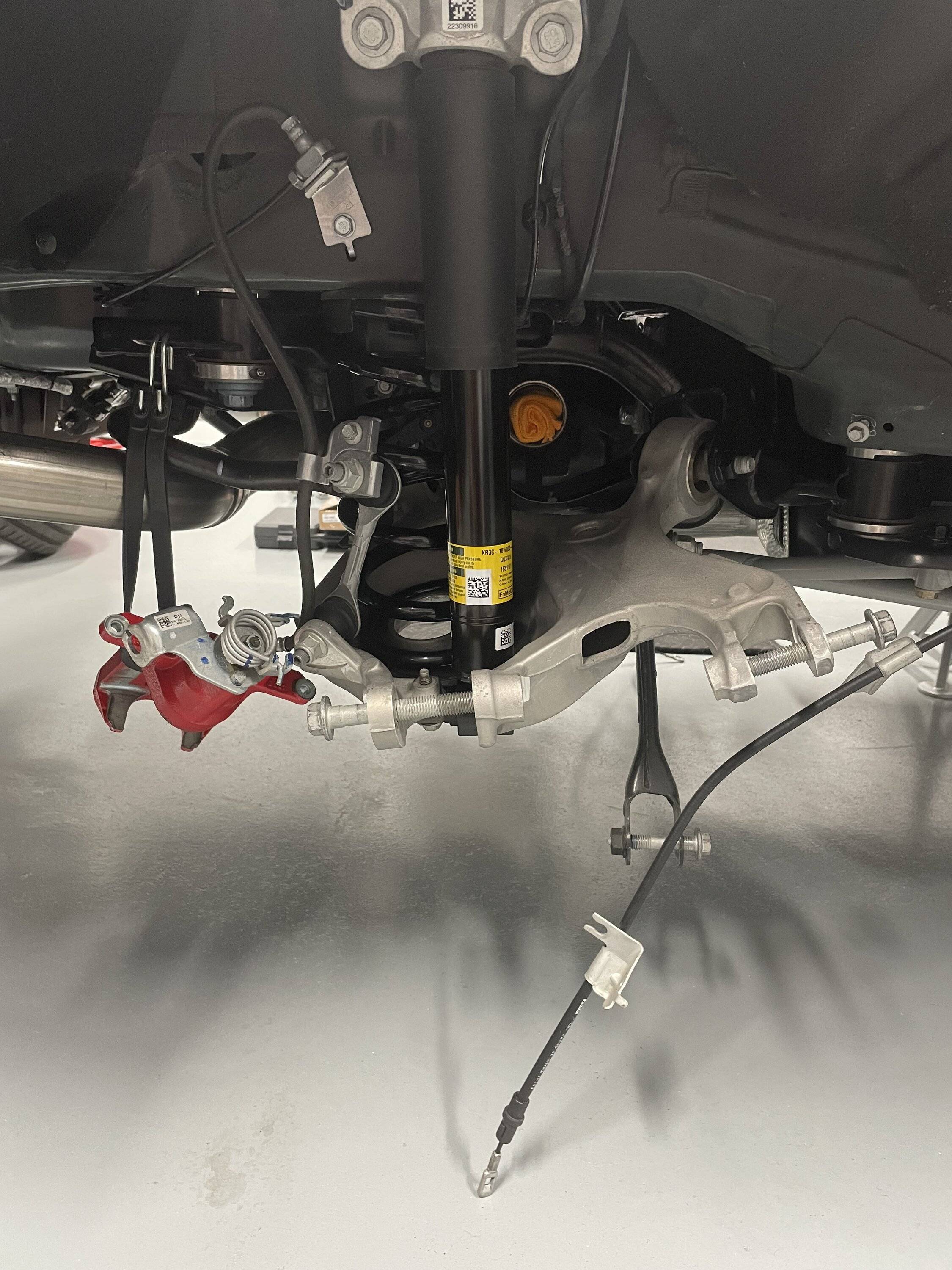

Hi All,
I am trying to remove the rear lower control arm. Found a great how to with pics, have the arm totally released from the knuckle, subframe etc. Just cannot get it out as it’s hung up on part of a subframe on top, and on bottom don’t see how to get the magneride through. The write up is for an s550 but obviously not a gt350, as for example the shock mounts are on top so for that example the arm just drops straight down. Ours it mounts on the bottom.
Also any chance anyone can send a shot of the owners manual for the control arm removal?
Thanks!

Please post pics of how far you’ve gotten, so we can see how to help.

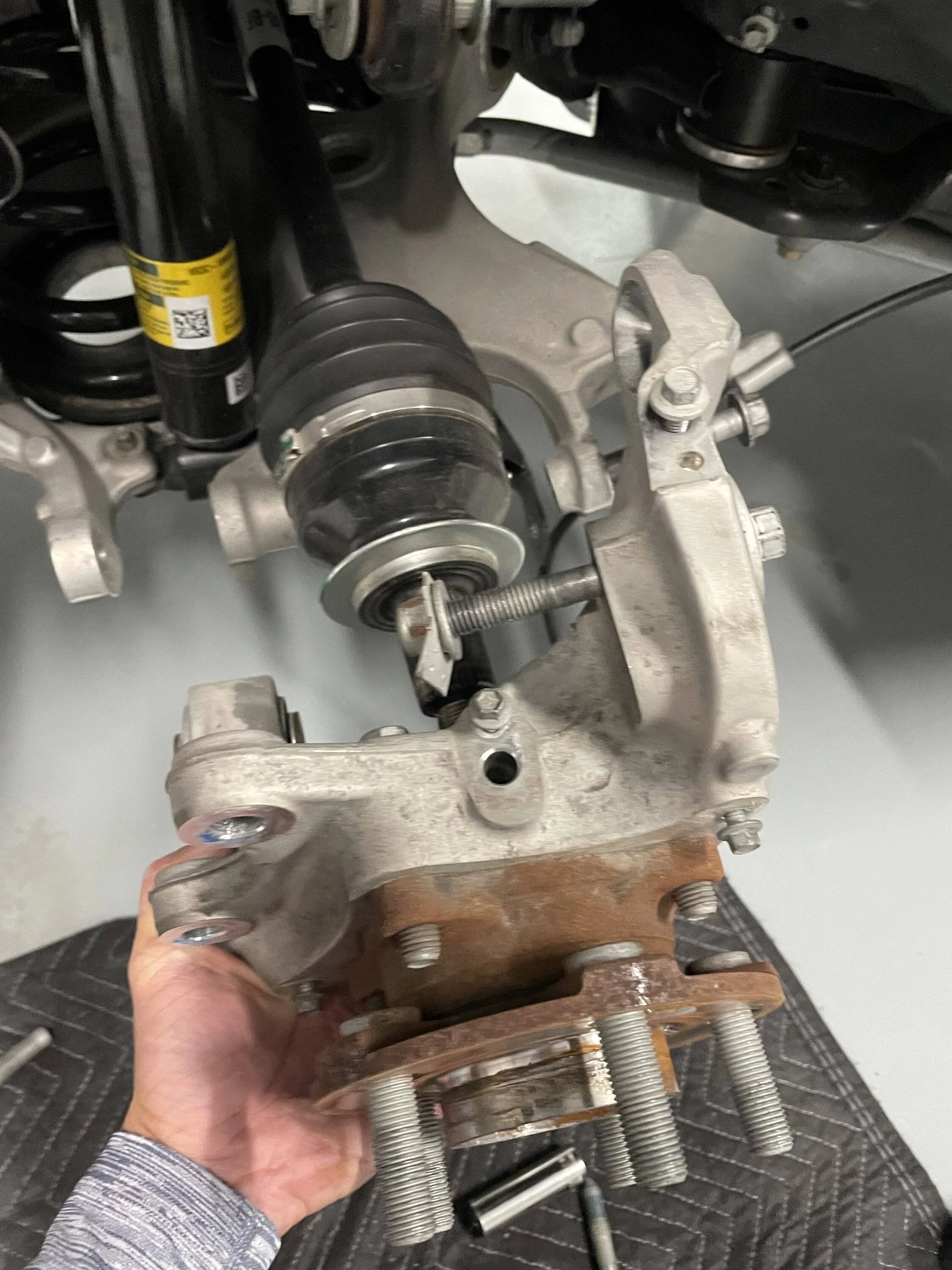

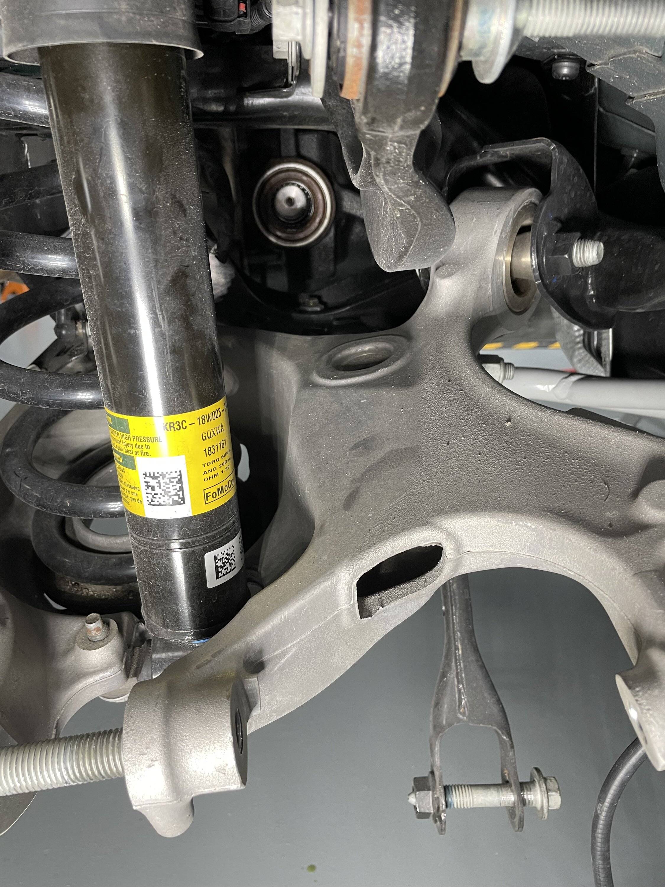

Here are some pics that will hopefully give you a better idea on disassembly. Note: After removing my rear shocks and axle nut, I pulled down on the spindle and pushed in on the axle to remove it from the wheel bearing and let the spindle rest on top of a 5 gal. bucket. I also made sure to unbolt the magneride linkage from the control arm. This should allow you to remove the control arm.
