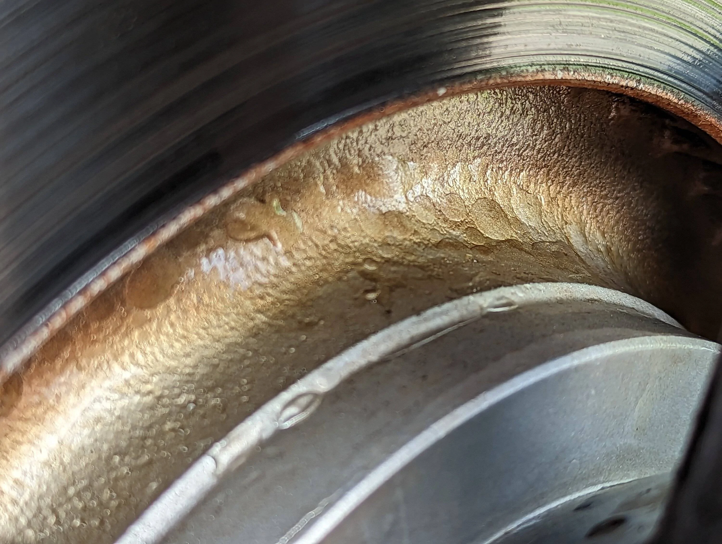

New oe pads, and rotors. They've been dragging from get go. Not enough to matter, but you can hear them when you go by a fence or wall. Just enough scuffing, to trigger my ocd
Only thing I can think MAYBE is parking brake over adjusted, but wouldn't that eventually wear enough to stop at some point?

It just drags enough to hear it, and I double checked parking brake with a feeler Guage on the caliper, it's correct.

Sometimes you bump the water/dust shields just enough to kiss the rotor. I removed all of mine.
