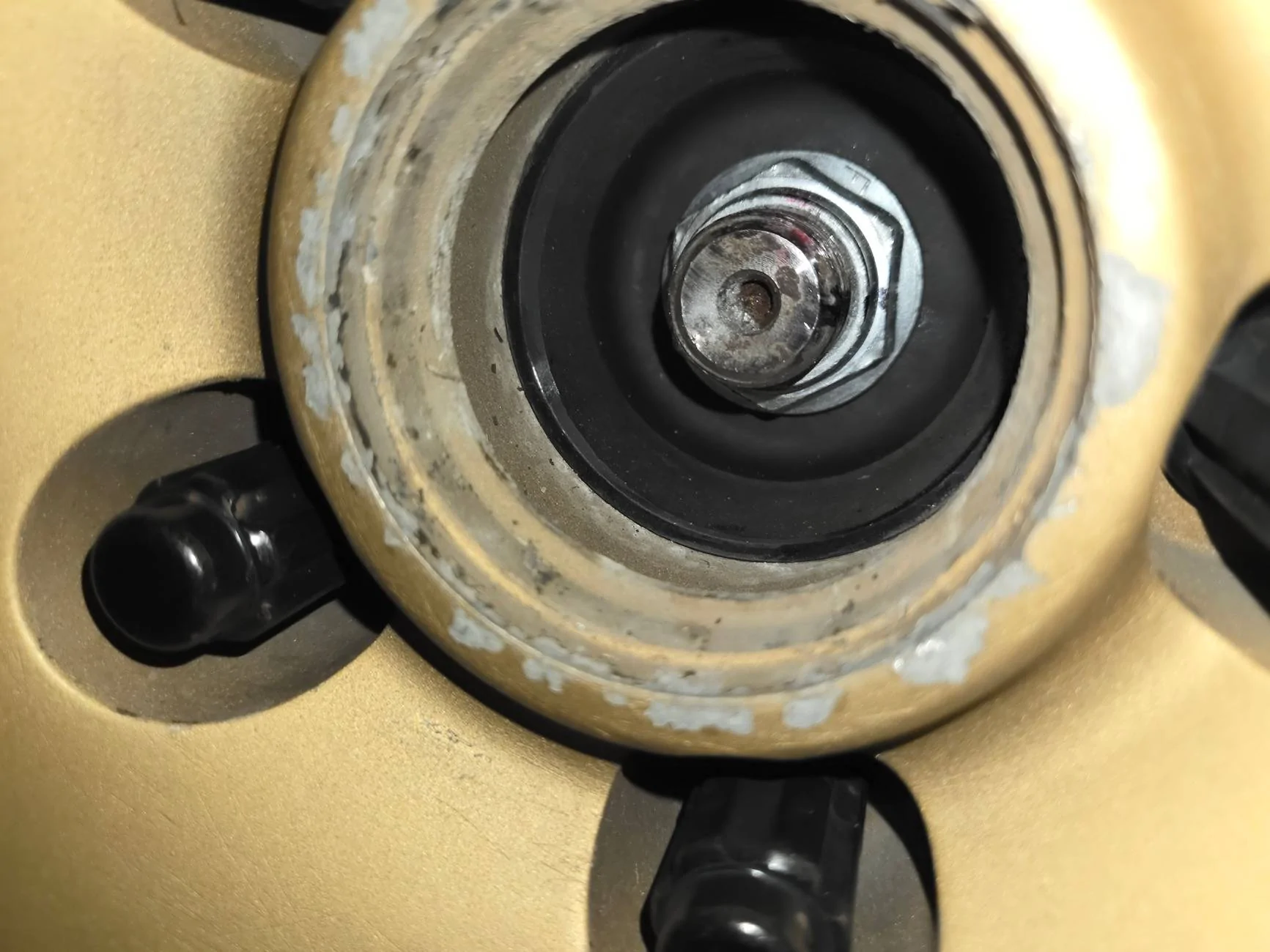

Marks didn't move at all. Pic from today.
I gotta repaint the wheels from the looks of it ha-ha.
Looks good to me. I think I witnessed marked mine as well. I’ll take a look this weekend.

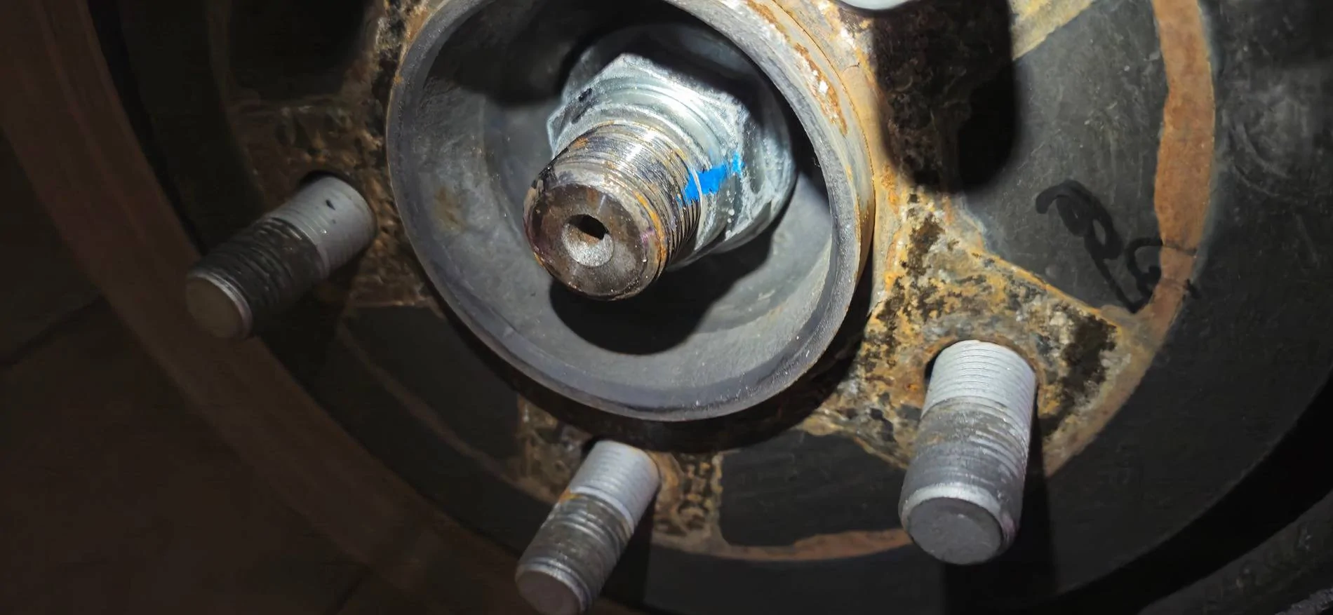

Near the end of the season for me.
Hasn't moved. I repainted over the original line for clarity.
