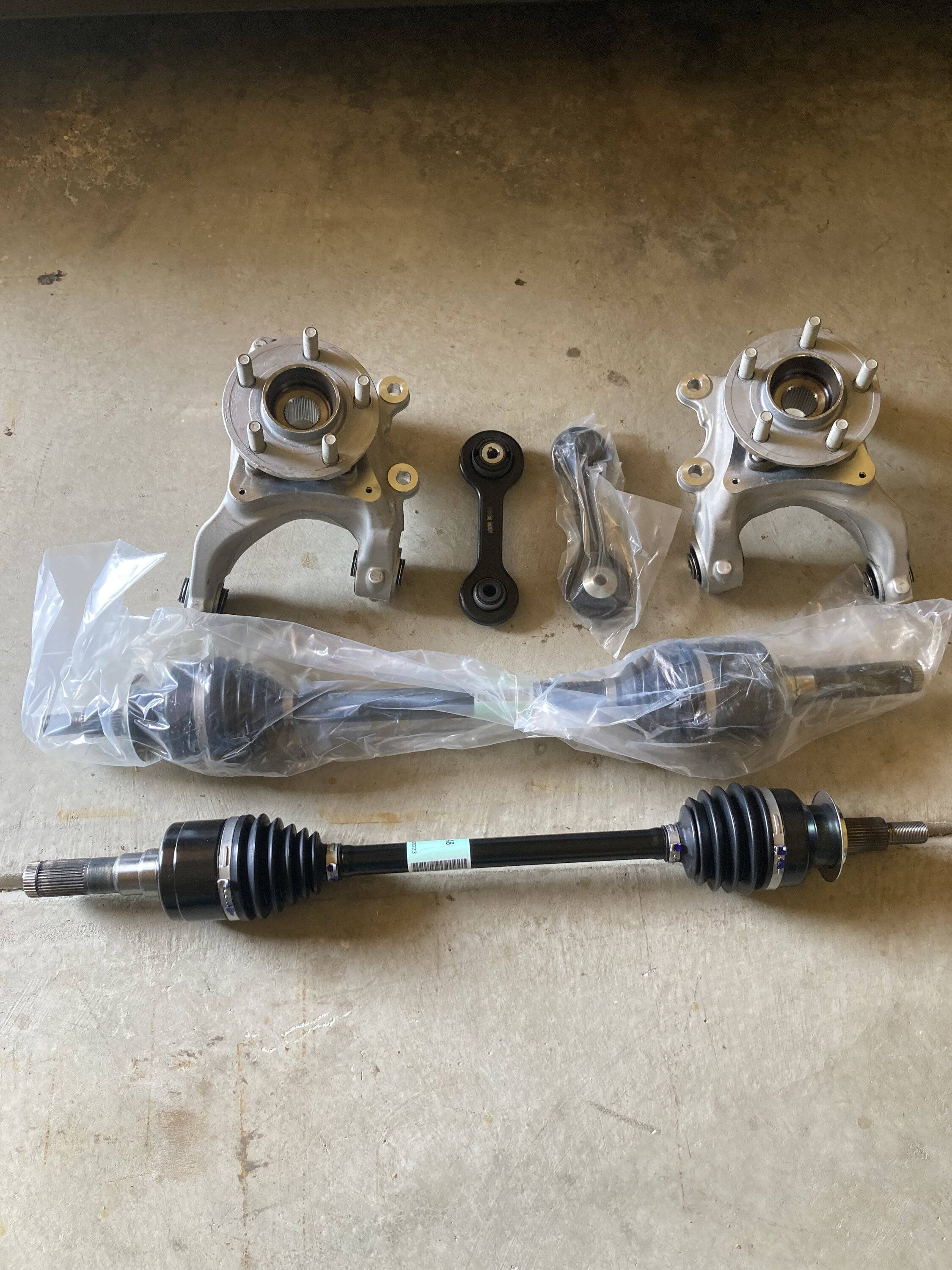

i installed a lot of kit in addition to the axle seal

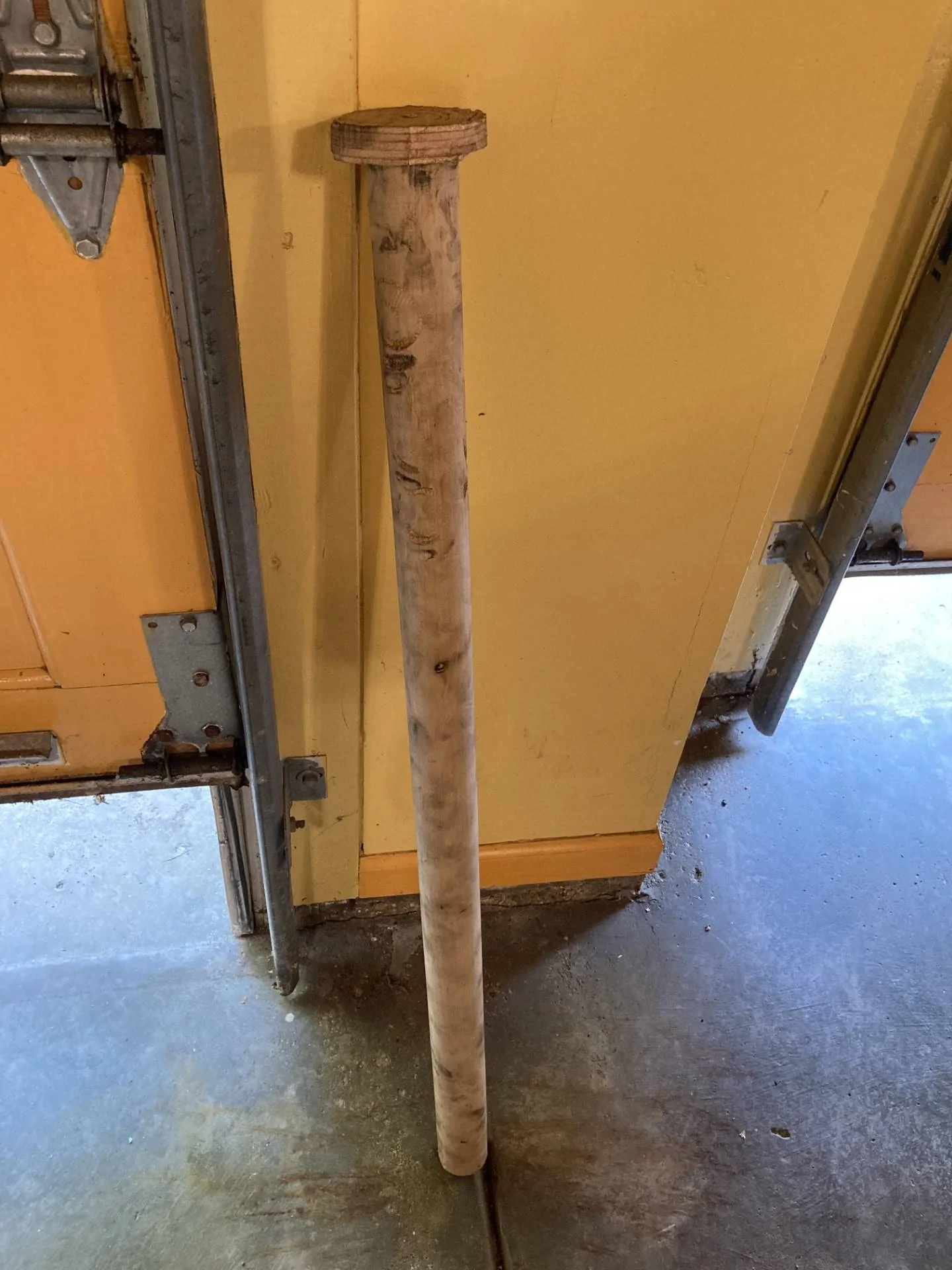

3)you need to make a tool to do this easily with the exhaust still on. here is a pic of the one i made. you hammer the seal in with this. it goes in where the axle used to be.

@thornclaw brotha...that tool is awesome. Where were you last week when I needed you, LOL?!?! Mine is buggered up just a tiny bit around the outer perimeter from tapping in, but it's purely cosmetic. Already drove it--works like a champ. But that woulda been an awesome idea.
