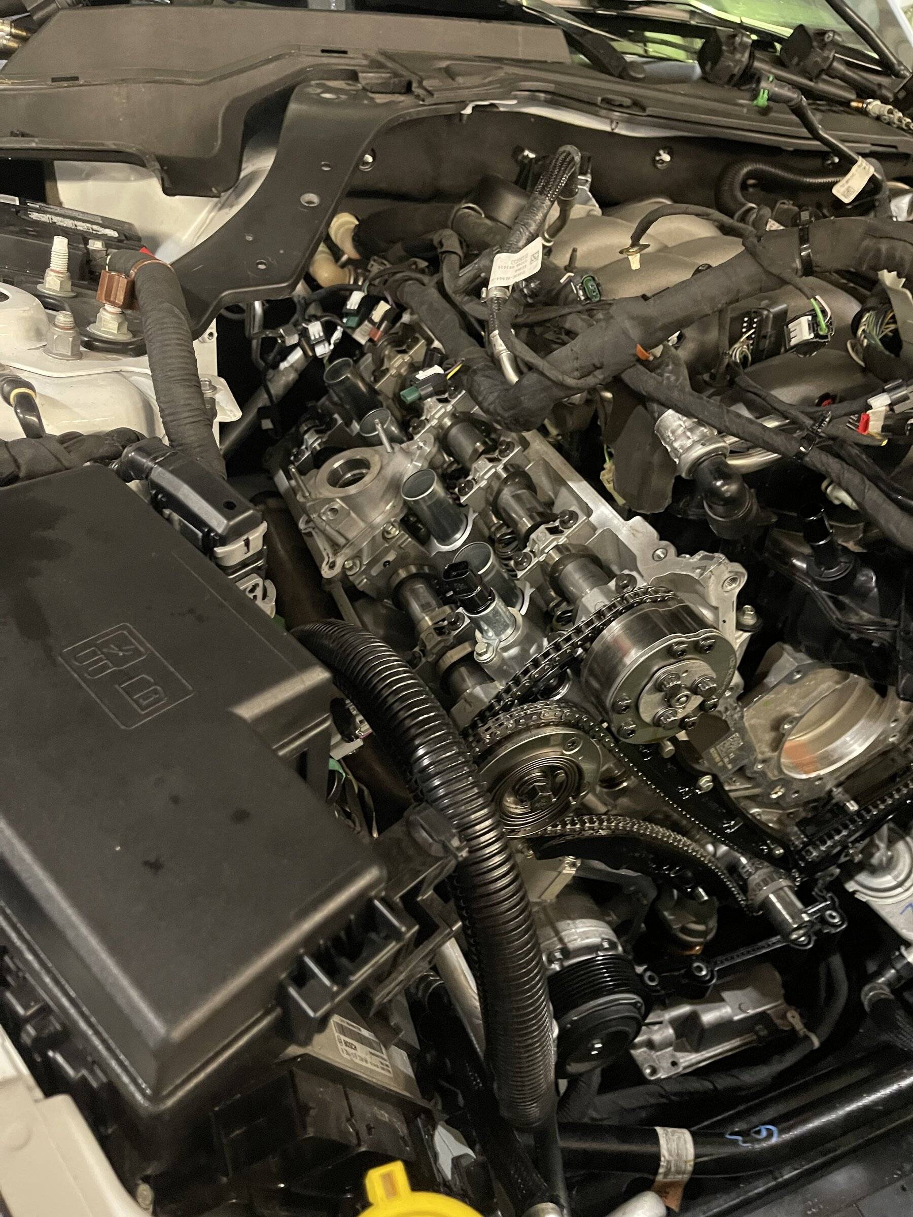

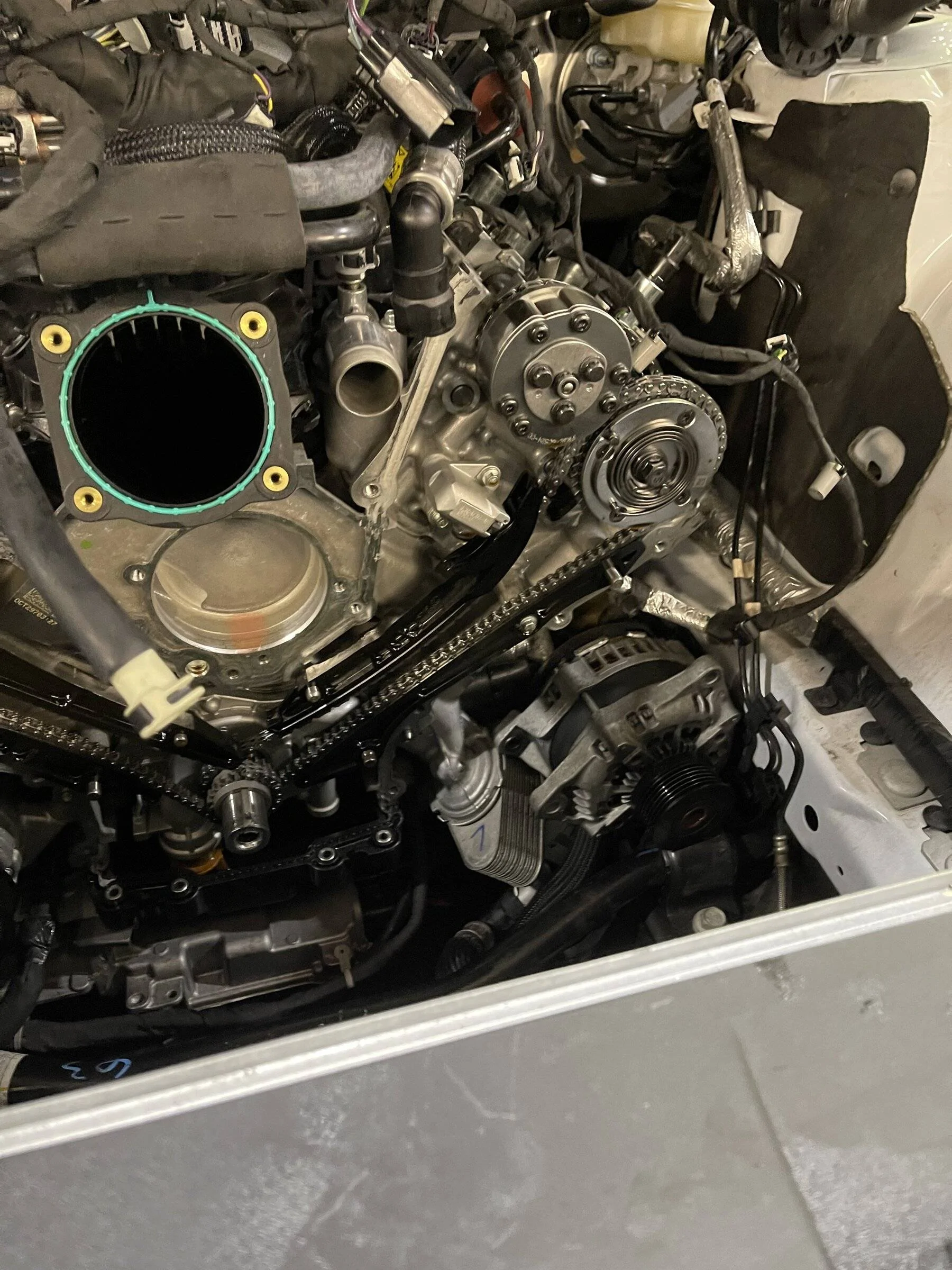

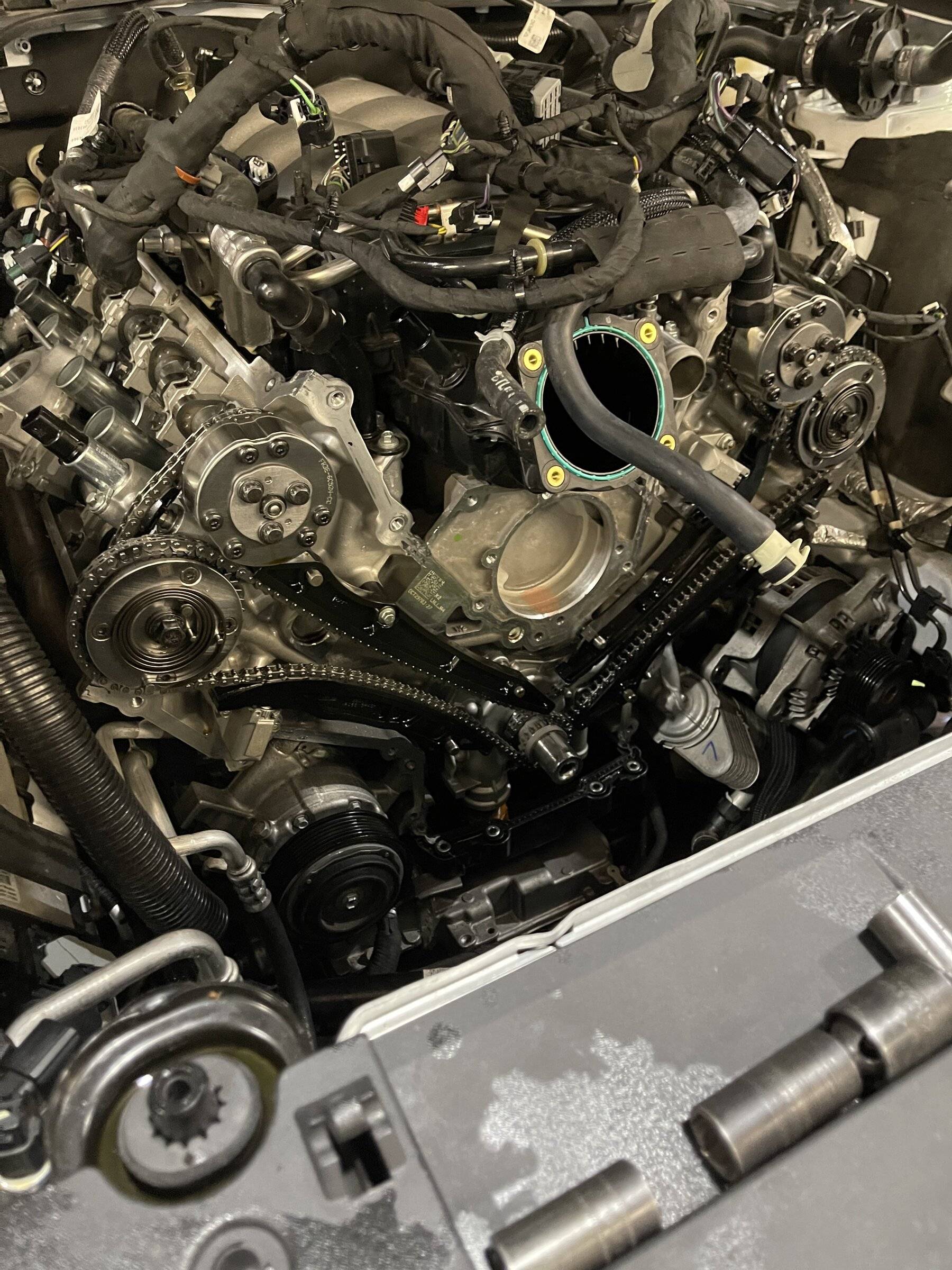

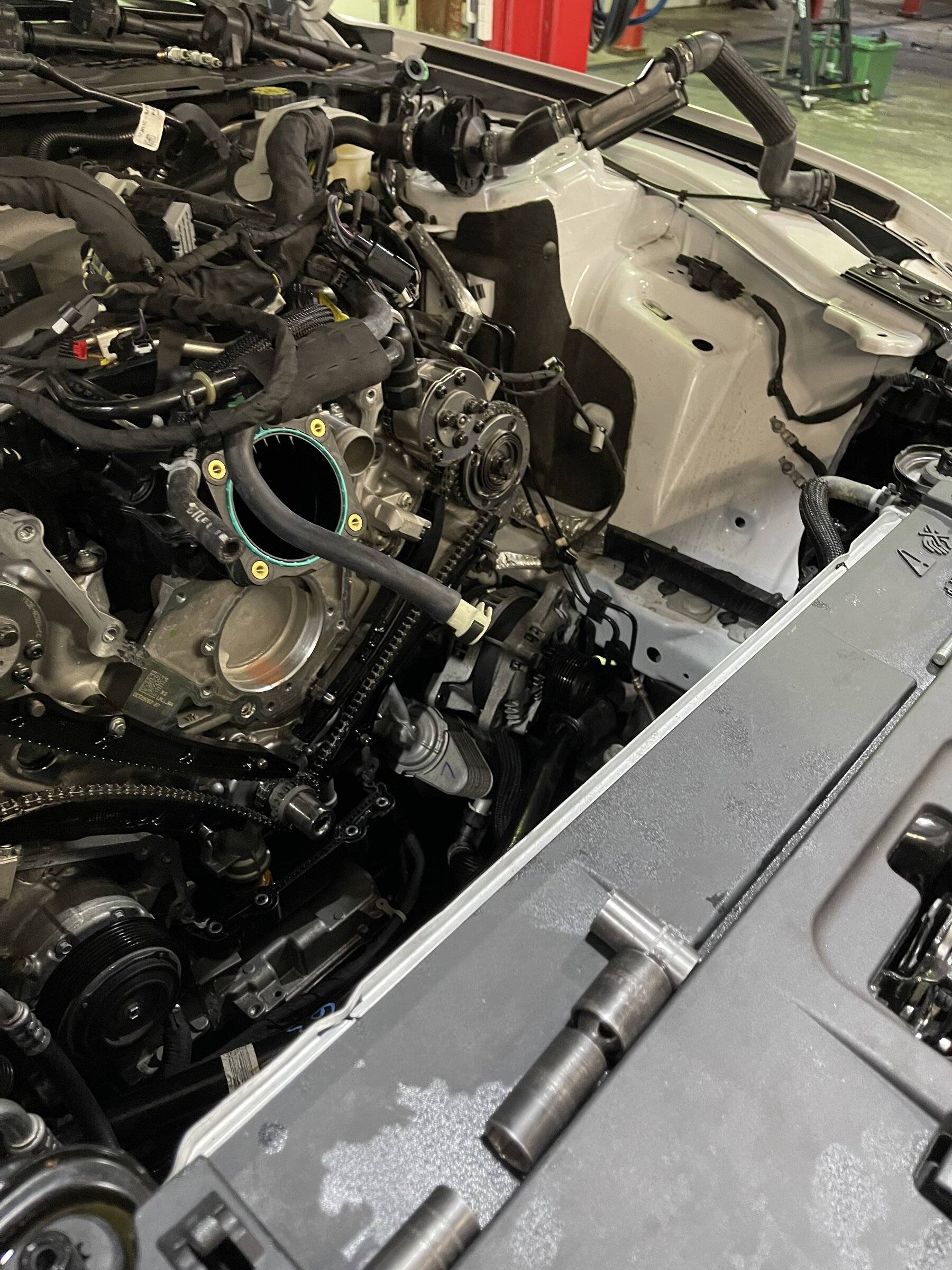

Well… I went to dealer today. It’s torn apart atm. See pics… they said they are putting it back together and if makes noise still it’s engine time. This was said by my service writer and the ford escalation tech. Who knows though…

So far can phasers 3x, cam phaser solenoid and chain tensioners.
