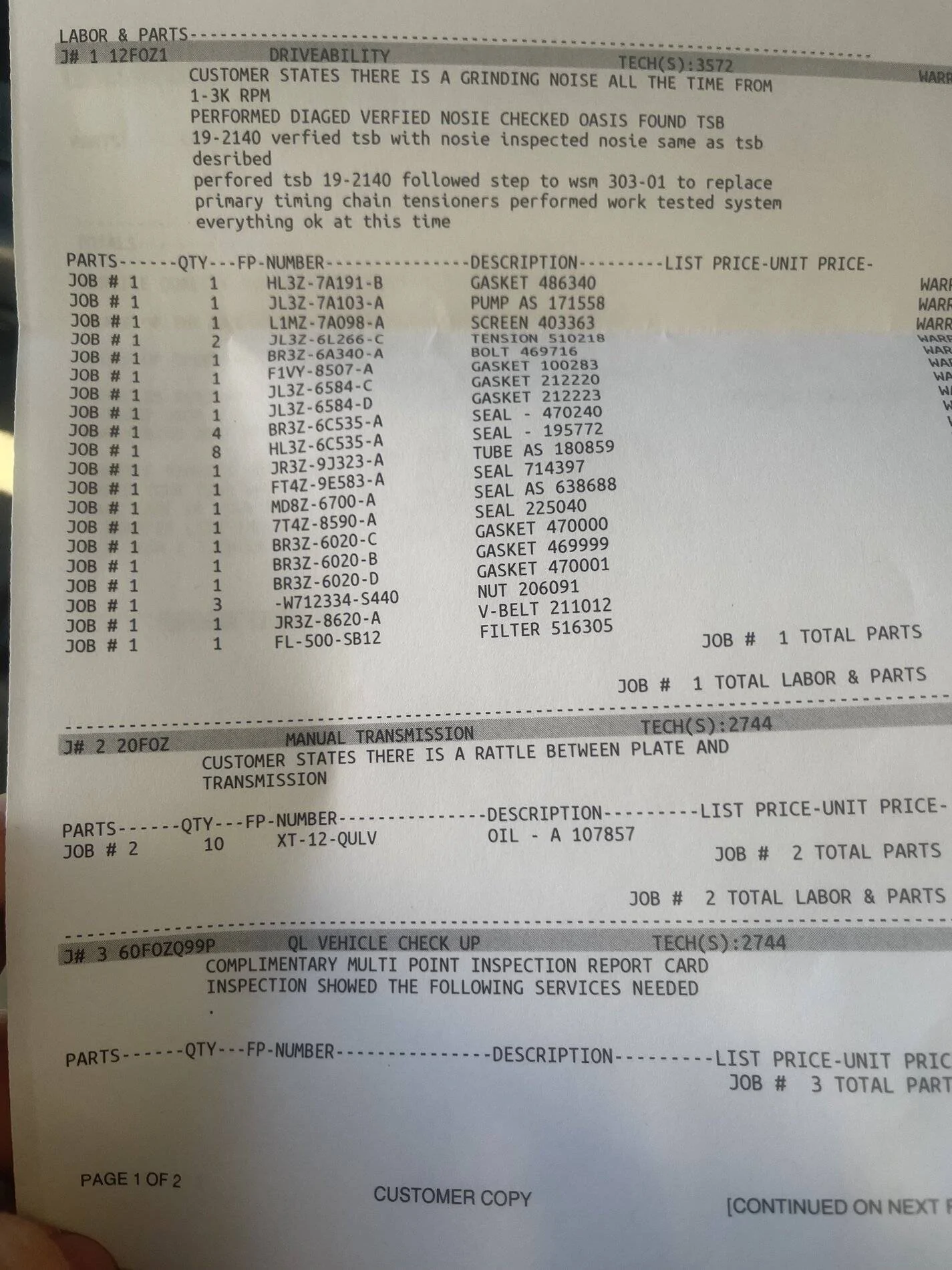

2018 GT Premium and a 1966 c10
Went to get car - they were test driving it. When they got back they said its still doing it. They are calling Ford in am to start the next troubleshooting steps. Invoice i have is below. Tech said 16hrs of labor so far. Invoice amount was 0 obviously.
