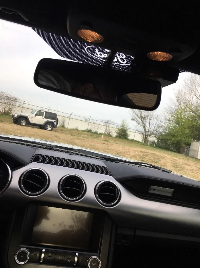

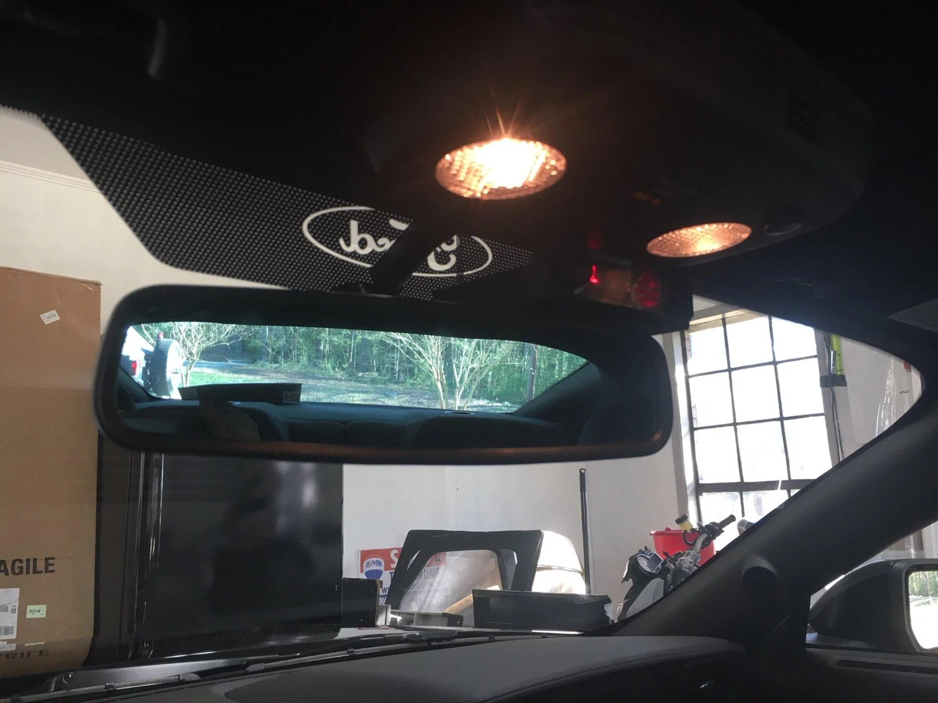

Every time I visit VA from AL, I don't worry about my Valentine 1. It's mounted high up above the rear view mirror and wire is put away, hidden behind the dark sun-blocking OEM tape above the mirror. I've been stopped in VA and it was never noticed by the officer -- no one bends down to look up inside the cabin. Most radar's are suction cupped and visible mid windshield and below.

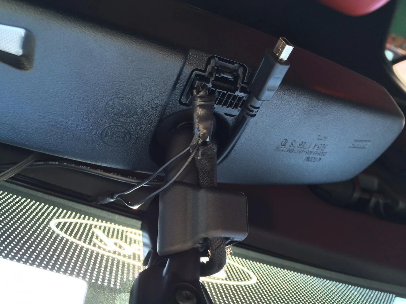

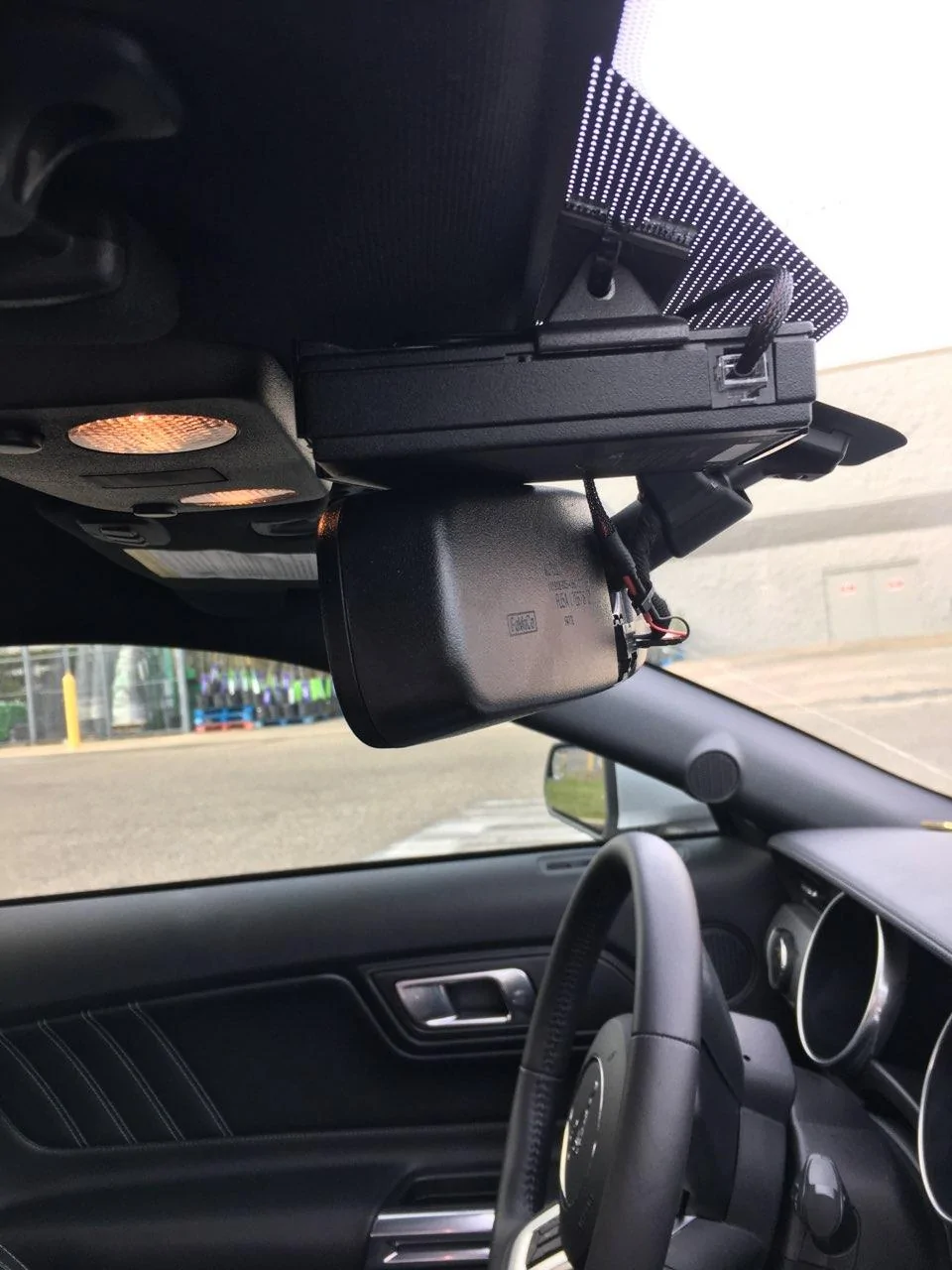

Instead of tapping into the harness with a prong, I cut a very small hole in the harness wires and taped it up from there. Then I tucked the extra wires and circuit board under the headliner. I say circuit board, because I like to open up my cigarette adapters and take the circuit board out. Saves a lot of room.

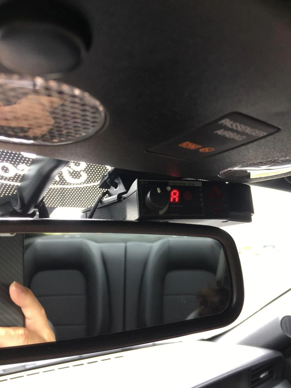

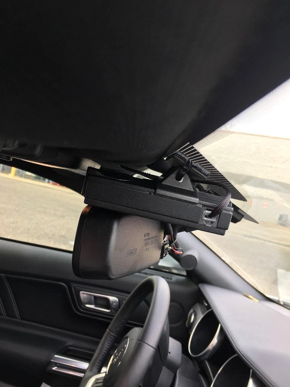

Stuck on with 3M tape.
