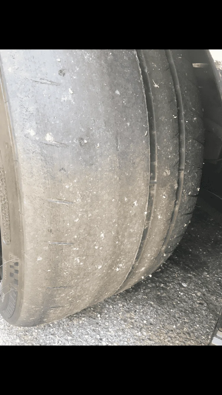

Mine look to be getting towards the end of their life with 5500 street miles judging by the outer groove depth.

How can you tell :confused:
Don't look gone too me. Another 1-2 days. I've seen a few folks toss them as soon as the outside edge tread is gone. In my experience, you'll have another 1-2 days after the outside tread disappears depending on track and driving style.

+1
Plenty of time left on those.
Also, they're not "chords" they're "cords"

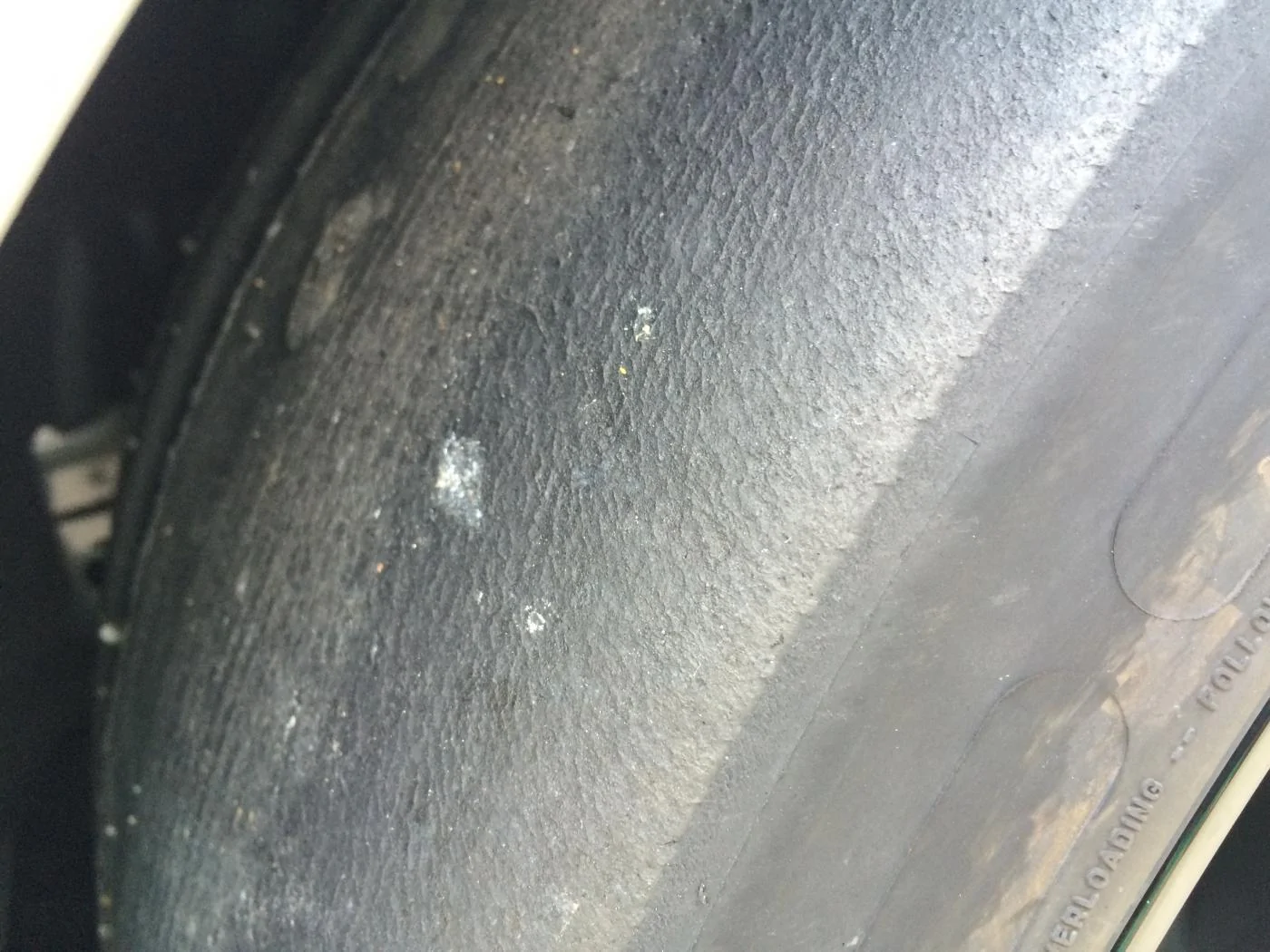

1550 miles including 2 track days (one of which was 1/2 in the rain so not even full track day). Everything stock, so probably need to do camber plates for the front. This pic is driver front now, the worst condition tire with no outer groove and middle groove nearly on wear bad --- others still have the outer groove showing clearly and abovewear bar on middle. I guess this makes sense on clockwise tracks, and maybe camber plates will help. I'm hoping to get one more full track day out of the set and will watch close for chords, but no loss in grip.
I have a spare set from the winter Walmart deal, and love the performance of these cup 2 tires but was really hoping for 4-5 track days, a season for me, instead of 2.5 -3 track days. It also would suck to lose half a day if chords start popping out.
I am considering running PS4 at 295 front and 305 rear size --- about the same price but nearly double tread wear rating for 3rd set. Not sure how much performance or wear tradeoff will be though. Best thing you can do is stock up during winter months though as prices are 20%+ cheaper.
That tire pictured has some track life left in it. The outer tread groove starts out very shallow and the tire gets more of an "R-comp" tread profile as it wears. But that is about where they get sketchy on the road unless you can totally avoid rain.
