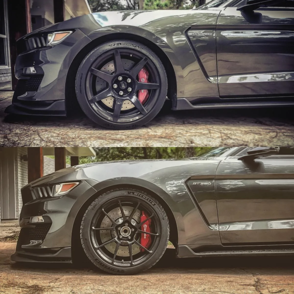

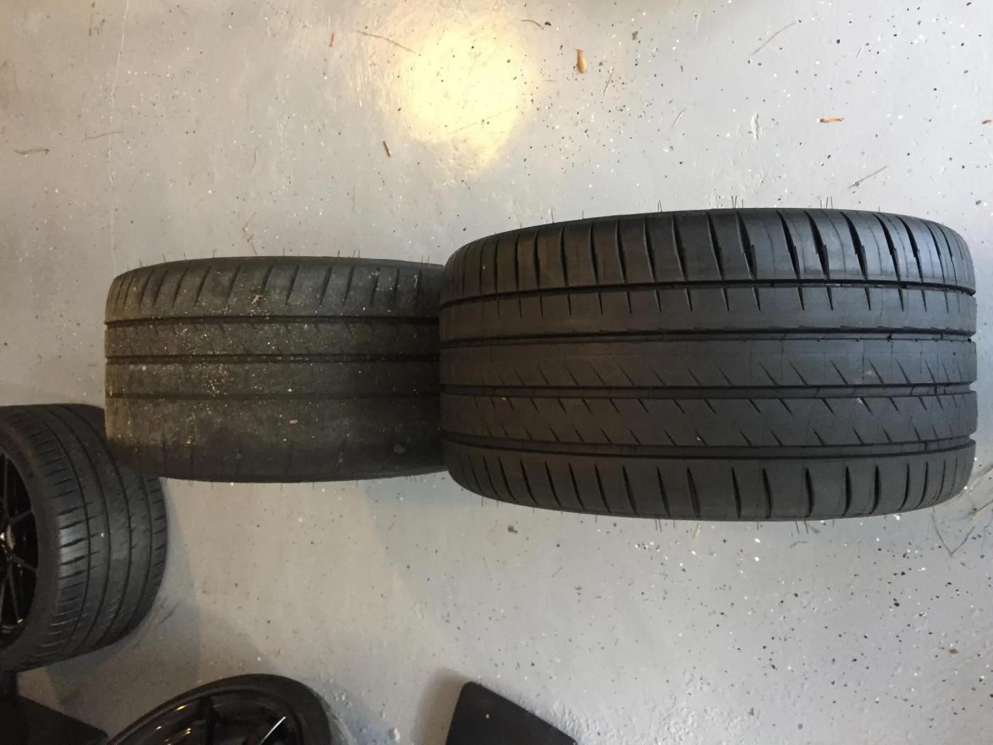

I've got them on my car. On an 11" wheel, and my ride height increased. You can see the taller sidewalk when compared to the same sized Cup 2. I know what TireRack quotes as meaurments, but it's not accurate to real life and how the tires are sized and fit.
The 305/30/19 4S mounted on a 11" width is as wide as the 315/30/19 Cup 2 mounted on a 11.5" wheel.

Stock 315/30/19 Cup 2 on 11.5" Carbon R wheel in rear, 305/30/19 4S mounted on 11" Forgeline GS1R in front.
which is front ans which is rear???? LOL
Zitrosounds
Oct 20, 2015
67
3,407
2,163
Madison, AL
Harold
16 GT350R/16 GT350TP/15 GT-PP/12 GT-PP
Dammit. Stupid photo uploader spun the photo.
Left-Rear/Right-Front.
I figured due to the tread pattern just wanted to be certain.
Thanks

No, it isn't.
TireRack doesn't "quote measurements" they take actual accurate measurements of tires on wheels... You might gain a mm here and there, but it is negligible. You claimed to gain 0.25" ride height, which would mean the tire is 0.5" taller than the same sized tire in a Cup 2... that is almost 13mm difference, which I don't see happening. If you said 0.25" total, i.e a 1/8" ride height difference, it would be more believable IMO.
And if we're splitting hairs, the 315/30/19 Cup 2 is 11.7" wide whereas the 305/30/19 MP4S is 11.5" wide sooo... yeah, you're not going to be able to perceive the difference of a few mm over almost a foot.
