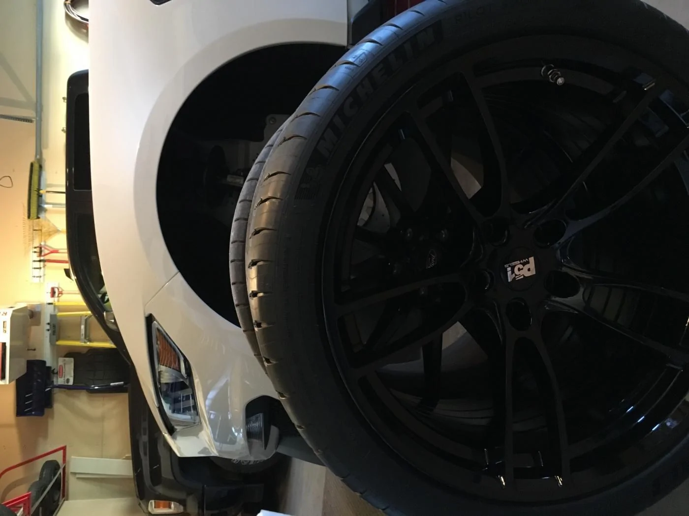

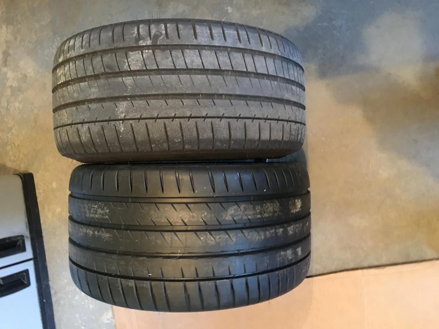

I can also confirm PS4s dominate in width.
The 305 is much wider than the equivalent in cup2 or MPSS.
I'm running 305/325 on R-spec P51 wheels and there is some poke, but everything fits well.
First pic is 305 PS4 vs 295 MPSS fronts. As you can see the PS4 are over an inch wider give or take a mm.
They should only be 10mm wider lol. My ride height dropped just a touch 1/4" or so. Looks more in the pic but isn't.
Actually they are only wider when comparing the PS4S to the GT350 specific MPSS. The "specific" MPSS for the GT350 are VERY narrow, i.e the shoulders are well rounded to offer better daily driving / wet driving characteristics.
Actual tread width measurements from Tire rack (i.e contact patch width):
GT350 specific MPSS:
295/35/19 - 10.0"
305/35/19 - 10.7"
GT350R specific Cup 2's:
305/30/19 - 11.0"
315/30/19 - 11.7"
So for just a "10mm" increase, the R's tires are a full inch wider on both front and back (25.4mm).
Now for the MP4S:
305/30/19 - 11.5"
325/30/19 - 12.2"
Standard MPSS:
305/30/19 - 11.7"
325/30/19 - 12.1"
So yes the tires appear wider than what you are taking off the car, but it is only because the OEM GT350 tires are very rounded and narrow for their size. The standard Super Sports are actually marginally larger overall compared to the MP4S in a 305/325 30 series fitment. The difference with the regular MPSS and MP4s is that they are much more square in how they fit on a wheel.
