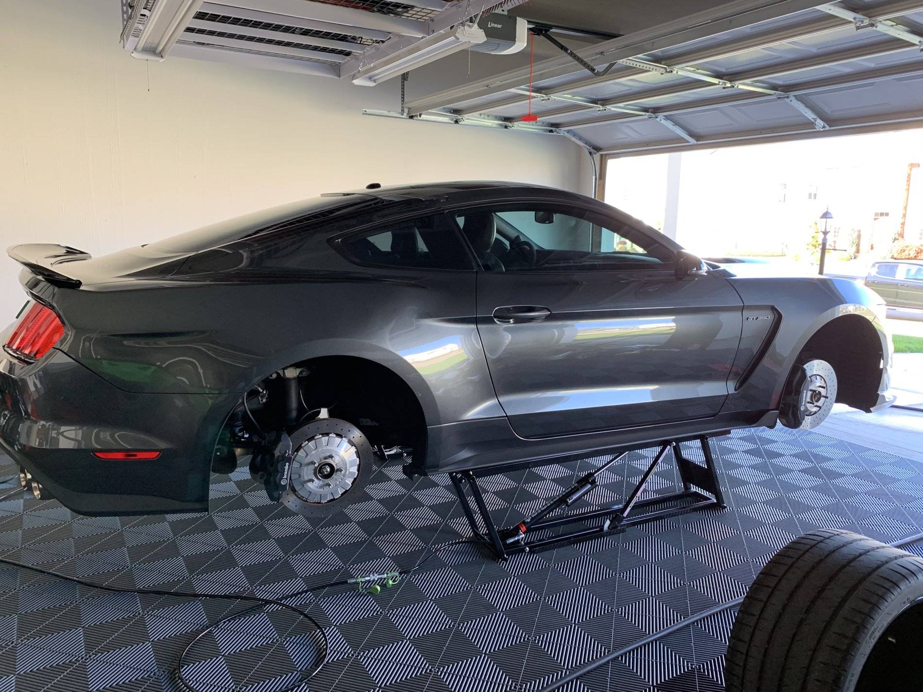

Anyone know the distance between the jacking points/pinch welds on the S550 without using jacking rails? I'd measure but car is in storage for the winter and considering a quickjack for other cars too. Is the shorter SLX long enough?
The spread is 60" on the BL-5000SLX and 66" on the BL-5000EXT They picture a Mustang on the EXT on their website.
https://www.quickjack.com/car-lifts/bl-5000ext/
I have the 5000 slx and it is more than enough. If you want to future proof your purchase, I would invest the extra funds for the 7000 model, you don't need the ext model for the mustang

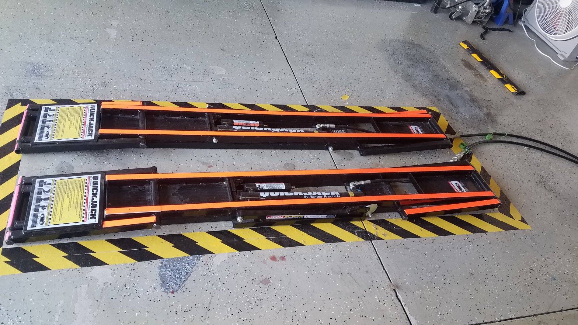

Here is my setup. It is perfect for all my cars. I pull in over it and when the tires his the tire stop I just pull the quick jack out and position it for the width.

Thanks all for your quick response just to confirm the 60" SLX reaches the marked jack points?

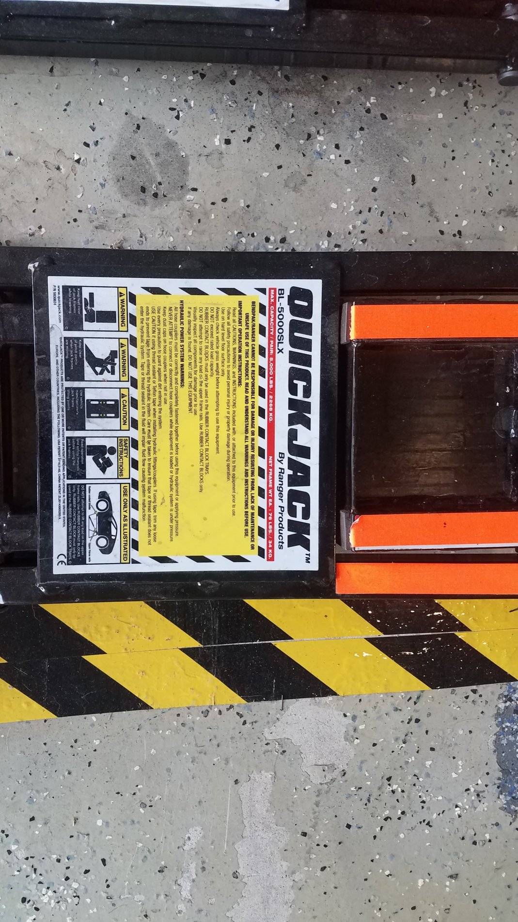

Don't drive over your quickjack. There is a warning in the owners manual warning about doing this. You have a chance of crushing the air cylinders.

Hahahaa, I dont drive on my quick Jack's. I drive over it. They store under my cars. The taped storage area on the floor and the orange tape on the Jack allow me it back in using the center line on my backup cameras to keep things centered. And when I pull in straight in I have a mark on the far wall that I keep in my eyes on to keep everything perfectly centered as I pull in. I also have a glued wheel stop that stops the car right in the perfect spot.
Gotcha! You had me worried there for a second. :whew: the guideline tape is a great idea!
