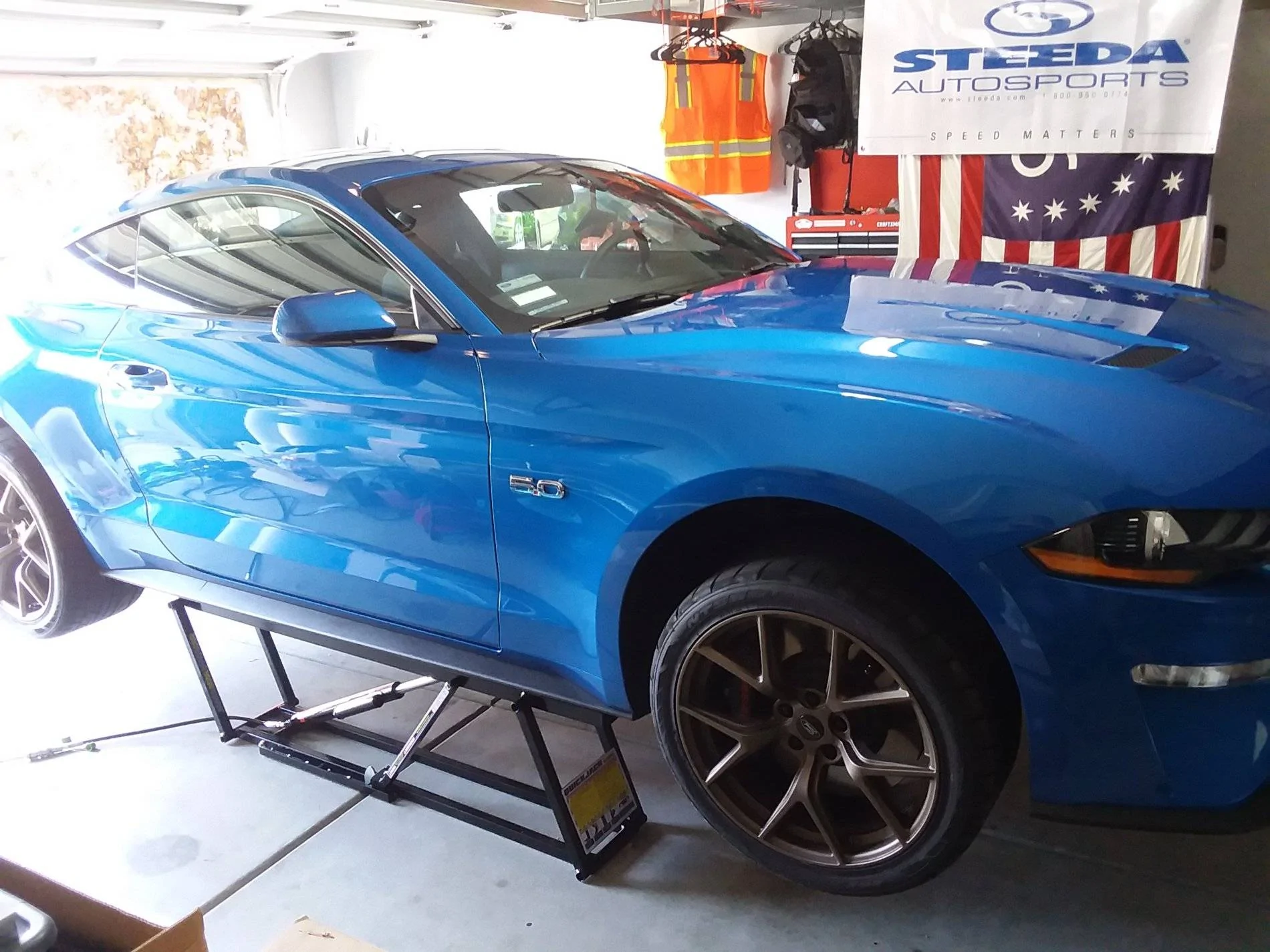

For those who have a Quickjack and Steeda Jacking Rails, how well do the two work together? Would you recommend the 3/4 Jacking Rails or the full length?

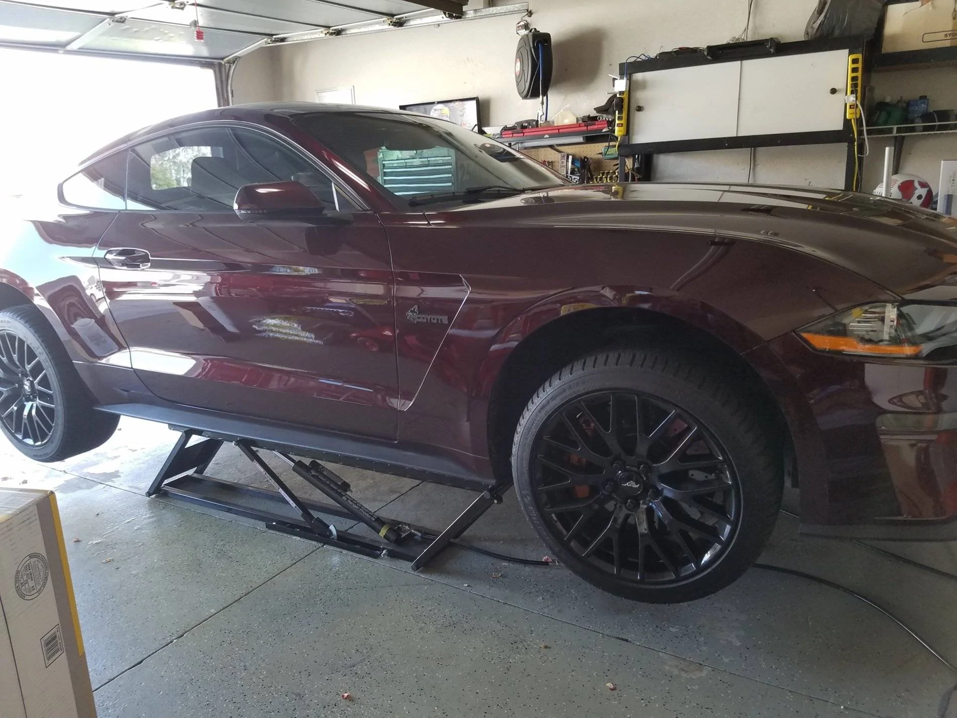

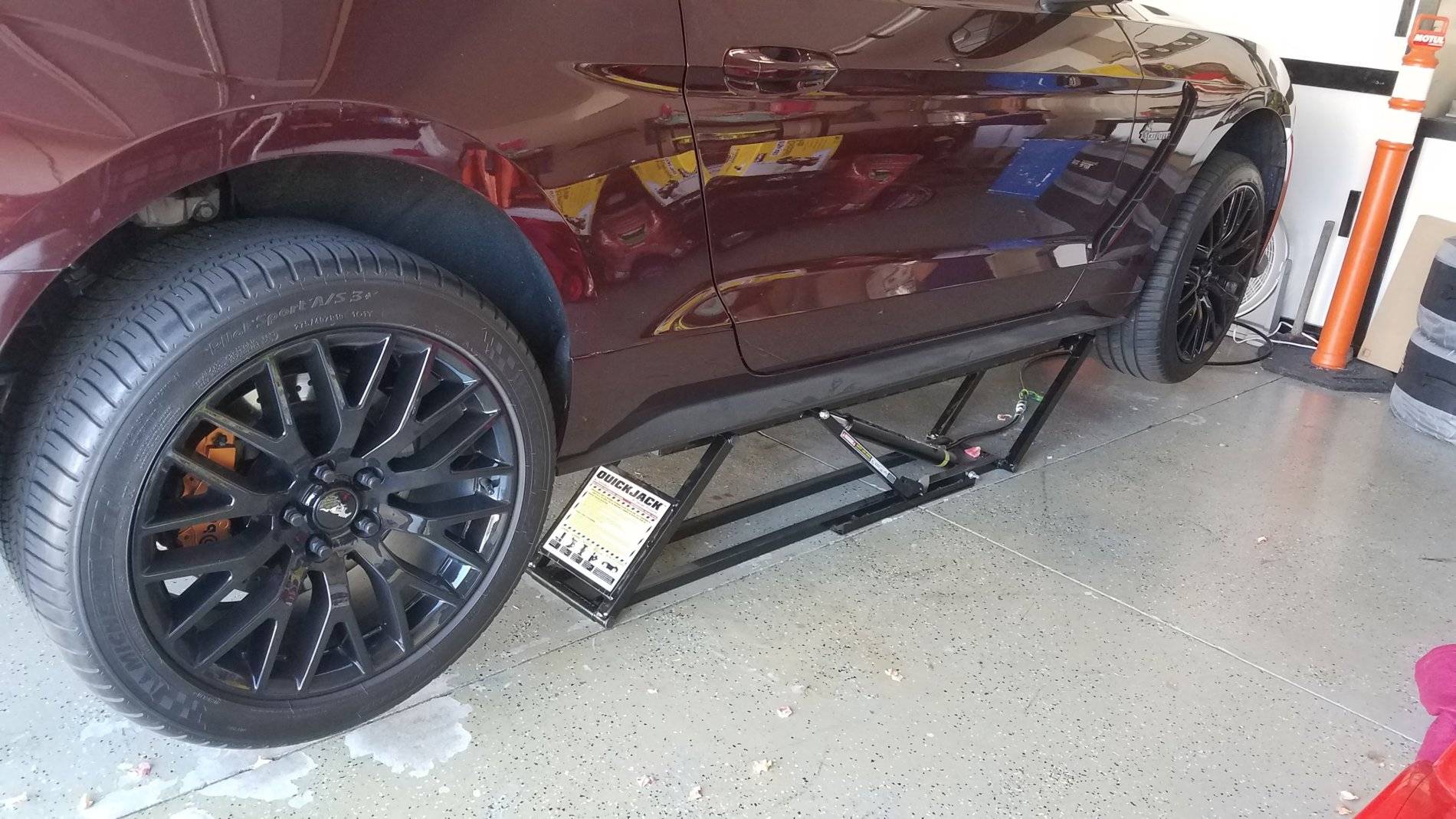

I have a Quickjack and Steeda full length rails. When the car was up on the jack the rails extended a bit out of either side. I'll try to find a pic that I took with the car up. Full contact with the platforms on the Quickjack when I don't use the rubber spacers that come with the kit.

I have the Steeda and I also use the quick jack rubber blocks,(but you really donr need them). Works perfect, and allows a little wiggle room for the quick jack placement.

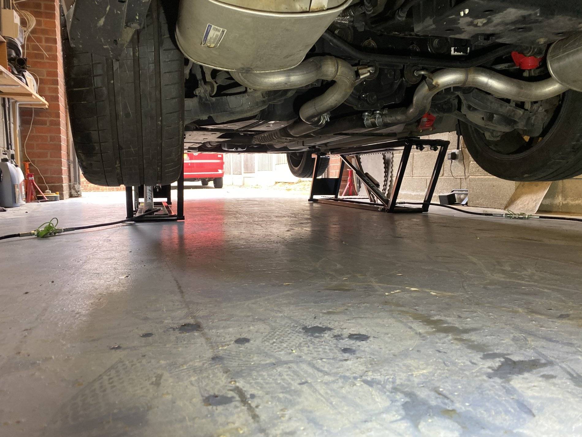

BMR rails here with quick jack and no issues.
