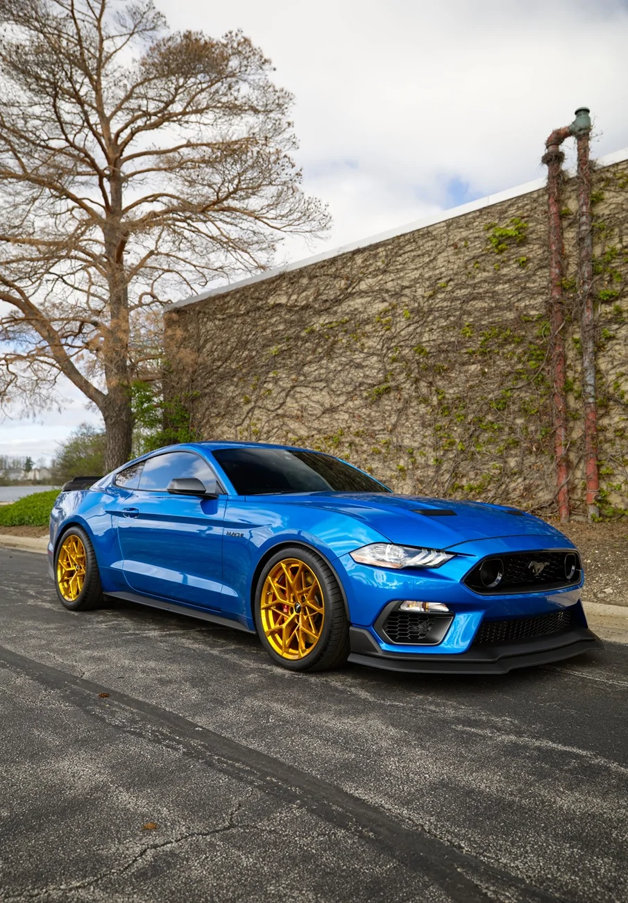

It’s a car, it’s meant to be driven and enjoyed. I’m lowered on Steeda Dual Rates and sometimes scrape on weird inclines. Just try to avoid steep driveways and when you can take things slow and at an angle and you will be good. Worst case you have to buy another.

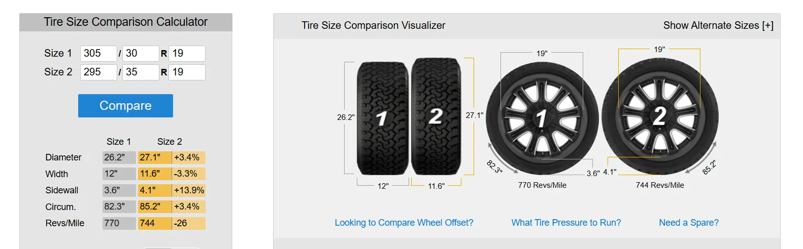

Next time you need tires you could consider a 35 profile instead of the 30 series profile.
A 295/35 front & 305/35/19 tire combination works well with HP rims.
Comparison below of 305/30 Vs 295/35

wow! I didn’t even know you could order a Mach 1 in Velocity blue! It’s my favorite blue ford has offered the last 5 years.
No clue either! I am not the original owner of the vehicle, I was initially shopping for a gently used Green Eruption Metallic but this popped up first with all of the goodies I wanted so I jumped on it.the color is awesome, I get a lot of compliments on her.
It was only 2020-2021 colour and Mach 1 started in 2021. So only OG's could get it. It's a fantastic colour :clap:
