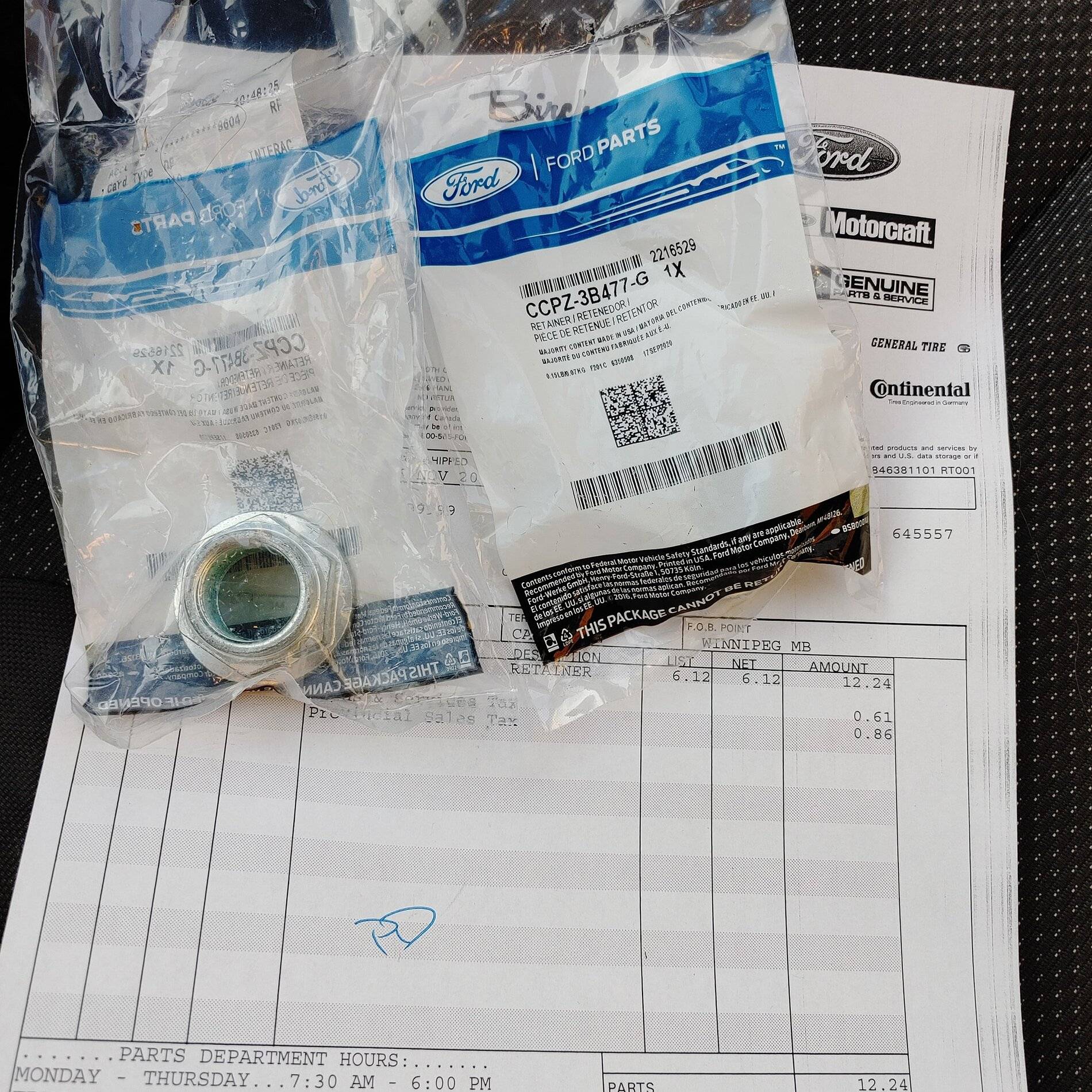

12 bucks for some cheap insurance & marked. Replacements are notably heavier.

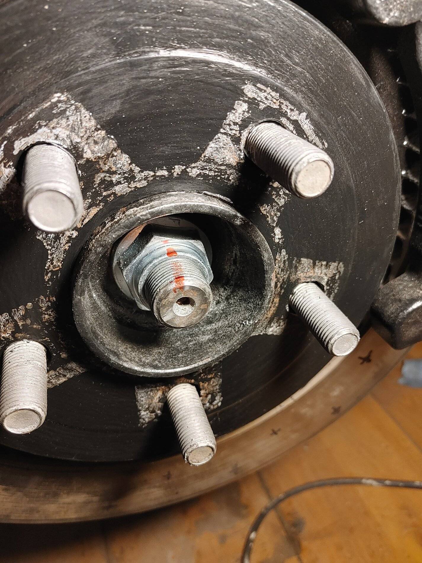

The picture on post #17 shows the factory put some kind of markings on the nut and axle, so if that's present on my car, and they line up, no need to even check things, right? Since I don't think the factory would mark the nut and axle without tightening them, right? Even with Ford's lousy QC standards, I doubt it'd happen. Or am I being too optimistic? Ha ha.

I marked it. Those are the new retainer nuts.

Oh man. Well, never mind. Factory marks almost everything, so surprised they don't mark more critical fasteners like those. Oh well. I'll put about 150 ft/lbs of torque on them if not marked, and if torque wrench clicks, then mark them myself, for future reference. Thanks.
