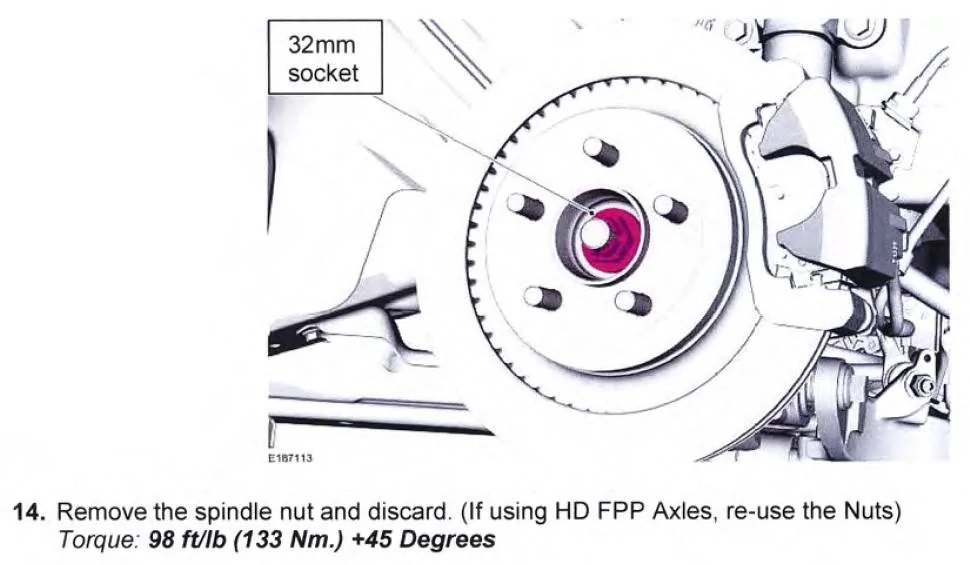

The shop manual says 98 ft-lbs, plus an additional 45 degrees of rotation. Keep in mind also that there are two types of torque - static (breakaway) and dynamic. When you torque something till the wrench clicks, then try to torque it again, it takes a higher torque to get the fastener turning than it does to keep it moving. So torque till it clicks at 98-100, then turn it another 45 degrees. I did this on both new rear axle nuts after the 4.09 installation and have had no problems with them loosening after 18 months of driving on them, with no addition of threadlocker to what was already on the new axle nuts.
