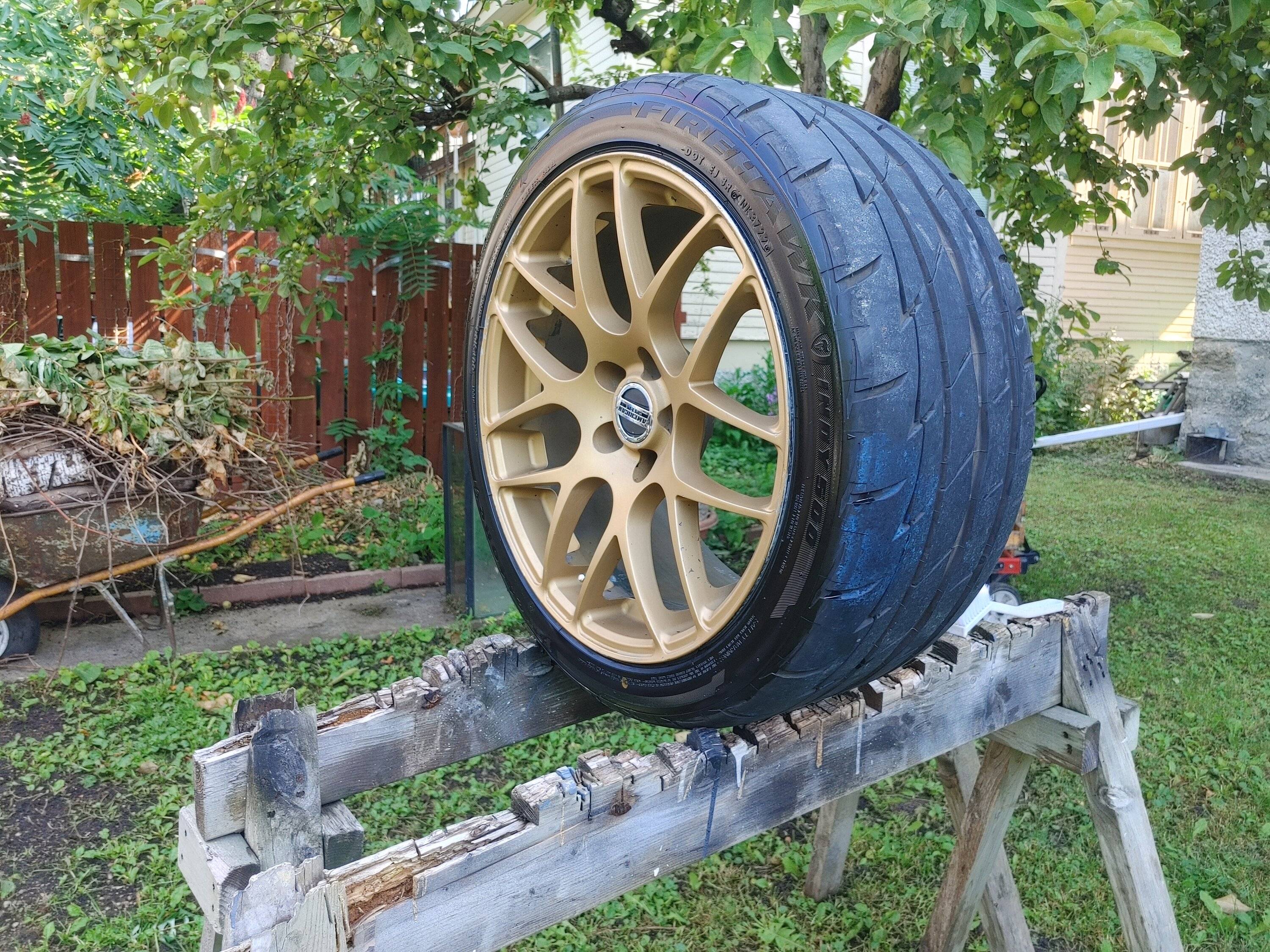

2 years after doing my gear swap, and replacing the nuts with new ones, I decided to take my wheels off to clean and detail them. Should say I also marked the nut to the shaft. Anyways, passenger side didn't move at all. Driver side however, the mark moved about a 1/4 inch over a 2 year period. Had to re-tighten it. Anywho, check them nuts at least once a year !
