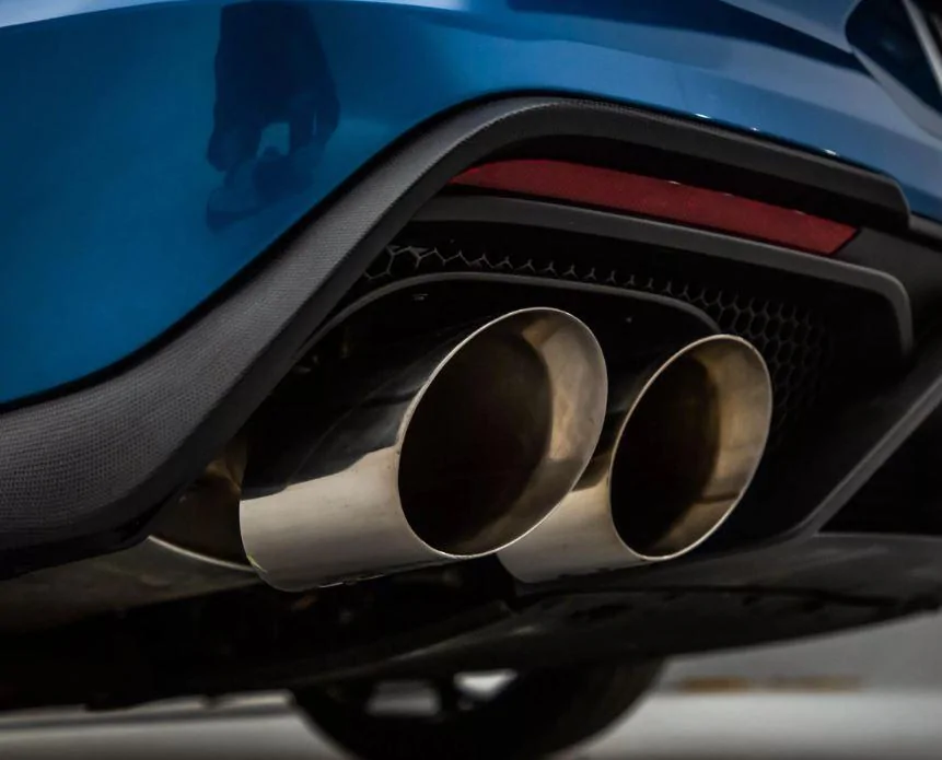

Might be complicating things since I have active exhaust, the valve is too close to the start of where the industrial style single wall Ford tips start from the pipe, probably very little margin of error if trying to cut the tips and try to use something else nicer. the exhausts are like OD 3.5" and the piping out of muffler might be 3"? not so sure, but tips are oddly slanted in beginning to stick out correctly. no universal tips slanted like that and the straight examples would end up probably not lining up good or hitting the valence. That is why I feel for my case, it can only be a slip on sleeve like the black powder coated ones that the other poster put on over the existing tips. For the Corsa/Borla actives, they have a different muffler that lines up their tips correctly from the start, but that is changing out the entire system as only option.
But I am still curious about how the 20+ GT500 muffler / tips are constructed, since the rears in the photos show almost same slanting but with a nice wider polished double wall sleeve? possibly if its exact same sizing, those 20+ GT500 polished tip sleeves could be used to get a better stock look?

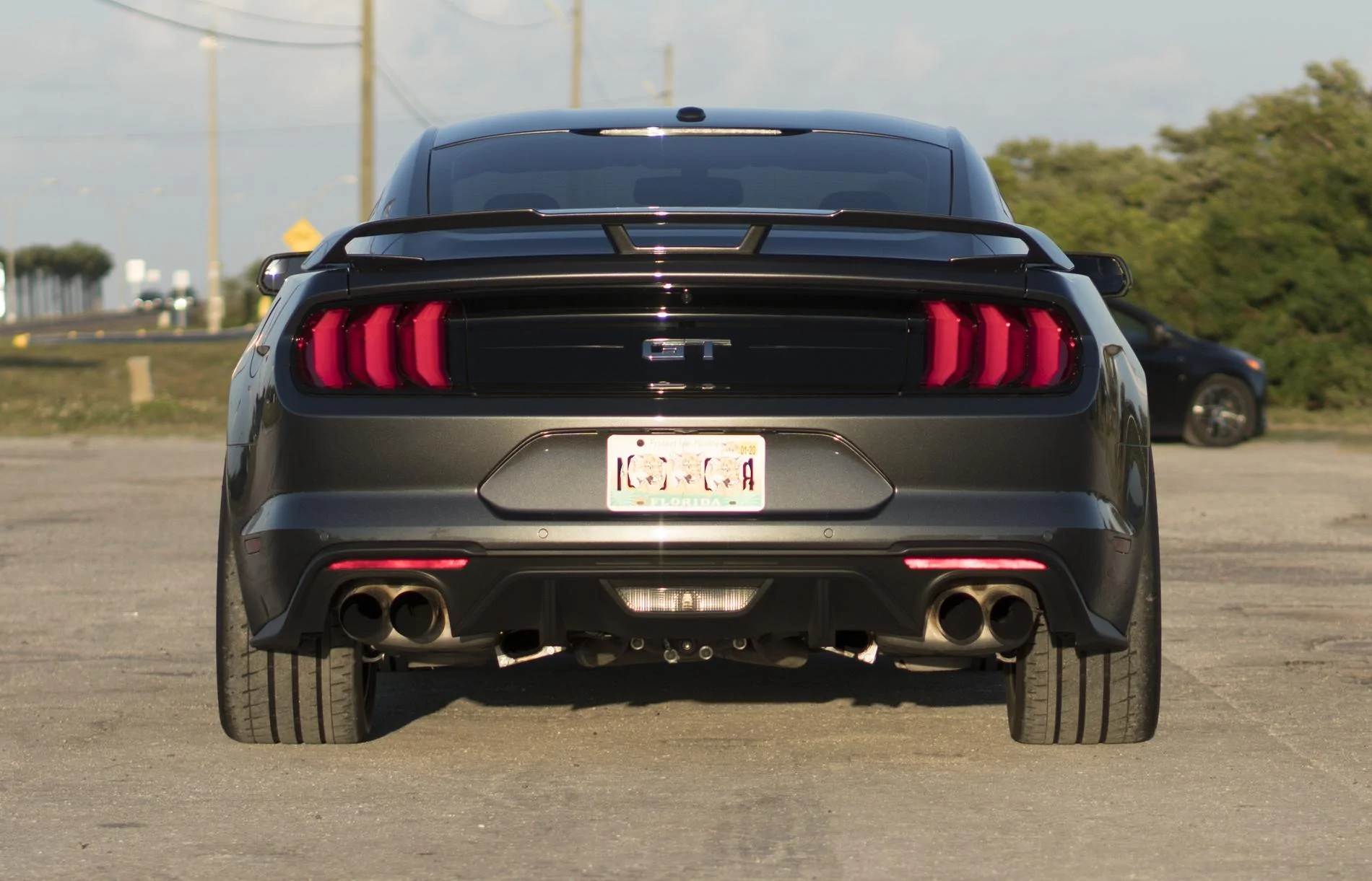

The active exhaust's muffler tips are nicer than the non-active, they look fine stock. I do think the non-active muffler tips could be better but they look fine from the sides and have a good slant
Heres my non active, you can see my cutouts too. Atleast those are shiny lol.

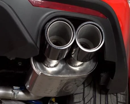

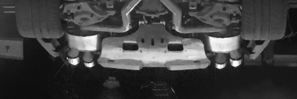

I did more research. will have to wait till GT500 start to show up and see the part numbers from the catback factory diagram, if the tip is a separate part from the muffler system, however I bet it is welded on and must be sold as the full system. It has drain holes and looks double walled and tacked onto the pipes which seem like the GT in a similar fashion, since GT350 use fake tips. But to make matters worse, I read somewhere that the tip covers that make up the 2020 GT500 are 5" and I am sure that is not gonna work well and they would most likely be touching each other if tack welded onto the factory GT exhaust. I am sure the GT500 pipes probably have more clearance from each other and also better positioned with the GT500 valance not to melt anything, (Ford also put insulation and heat resistant material in the new valance for a reason, not that a GT would get as hot vs the 500, but still.)

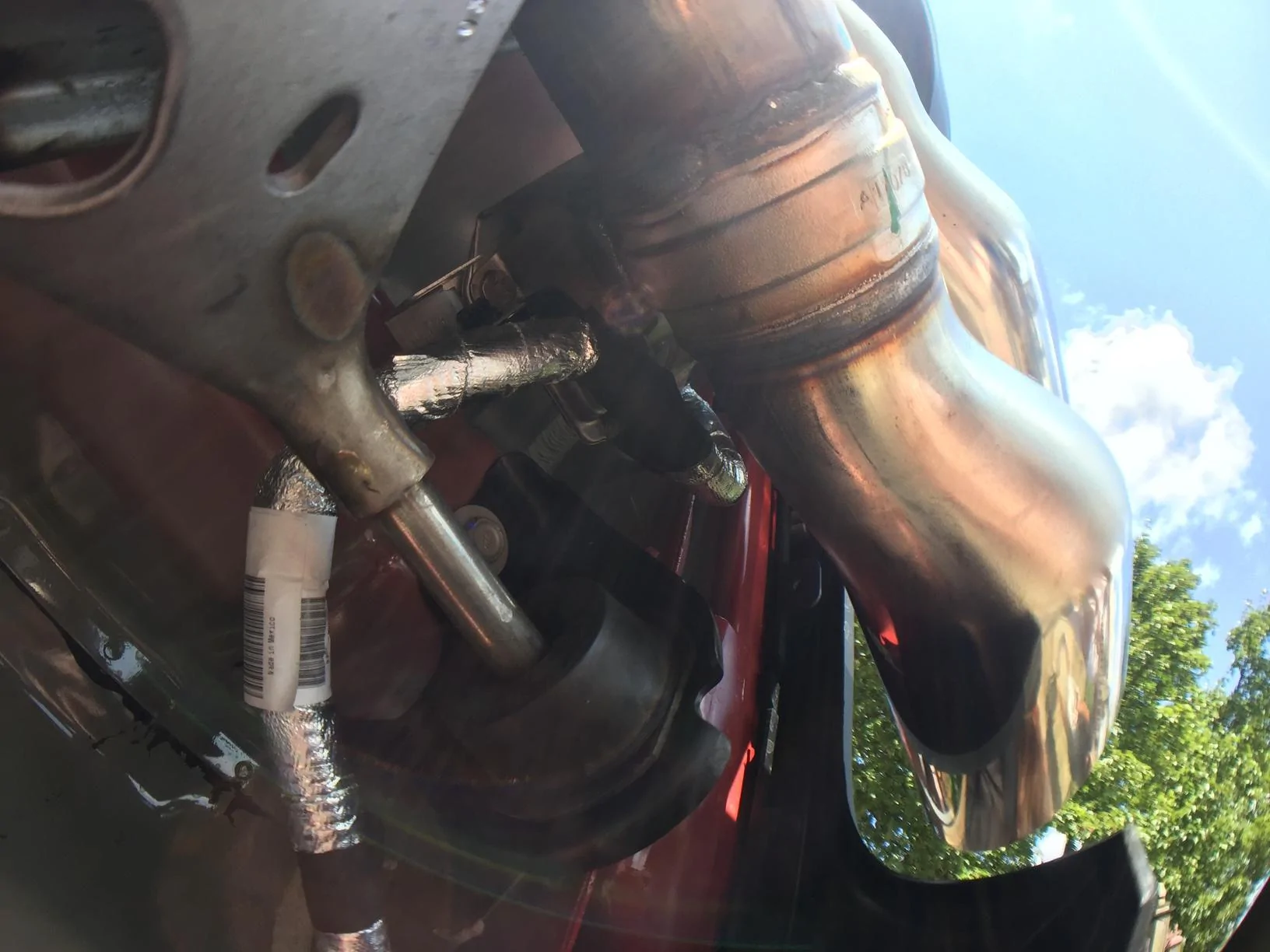

Here is my fix.took a little time to find the right tips as the originals are oval not round.Then figured out away to stop an vibration using header wrap and then off to powdercoating and I used allen screews to hold in place
Would really like to see a shot from u
The tips are from Go Rhino part number GRT3410B.I cut them to the desired length and used 2 strips of header wrap on each factory tip to create a tight fit.I drilled and tapped 2 holes in each tip and used allen screews which tighten into the header wrap.There is about a 1/8 of an inch of space between them.

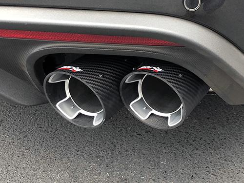

Maybe some company could create a stainless steel tip for sale with support brackets closer to .5" like the FP CF active axle backs which are on a smaller exit pipe though, But it seems the Borla FP extreme do have some sleeve that looks nice, over a borla stock tip. I am not crazy about CF since it can age over time and de-laminate, but the bridge style allows you to unbolt the sleeve off the brackets to replace if needed.
