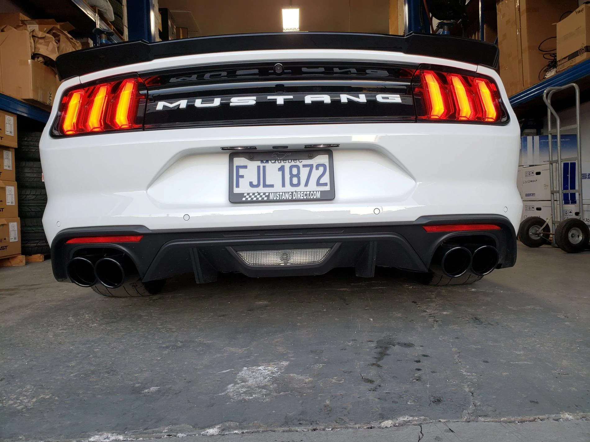

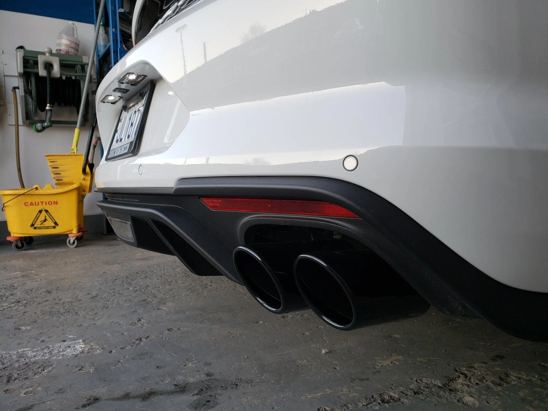

Here is my fix.took a little time to find the right tips as the originals are oval not round.Then figured out away to stop an vibration using header wrap and then off to powdercoating and I used allen screews to hold in place

Can we have some more info on this please? So these tips are sitting on the outside of the stock active tips, and you've just bolted them on somehow? A pic from underneath, or showing how/where you've put the screws would be great. How much space is there between each tip now?
It looks awesome btw, really really good work.

The tips are from Go Rhino part number GRT3410B.I cut them to the desired length and used 2 strips of header wrap on each factory tip to create a tight fit.I drilled and tapped 2 holes in each tip and used allen screews which tighten into the header wrap.There is about a 1/8 of an inch of space between them.

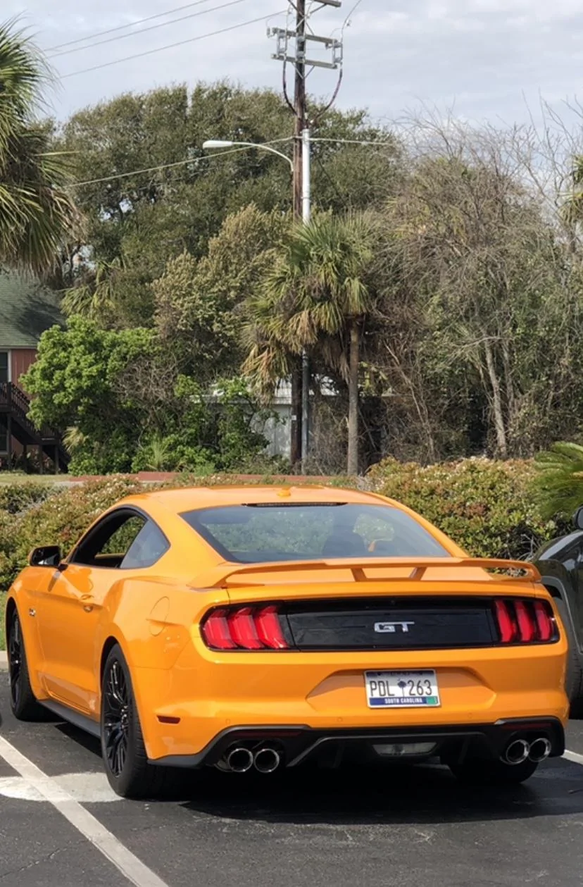

I have some big 4" Corsa tips on my Roush AB. They fill in the gaps pretty well.
