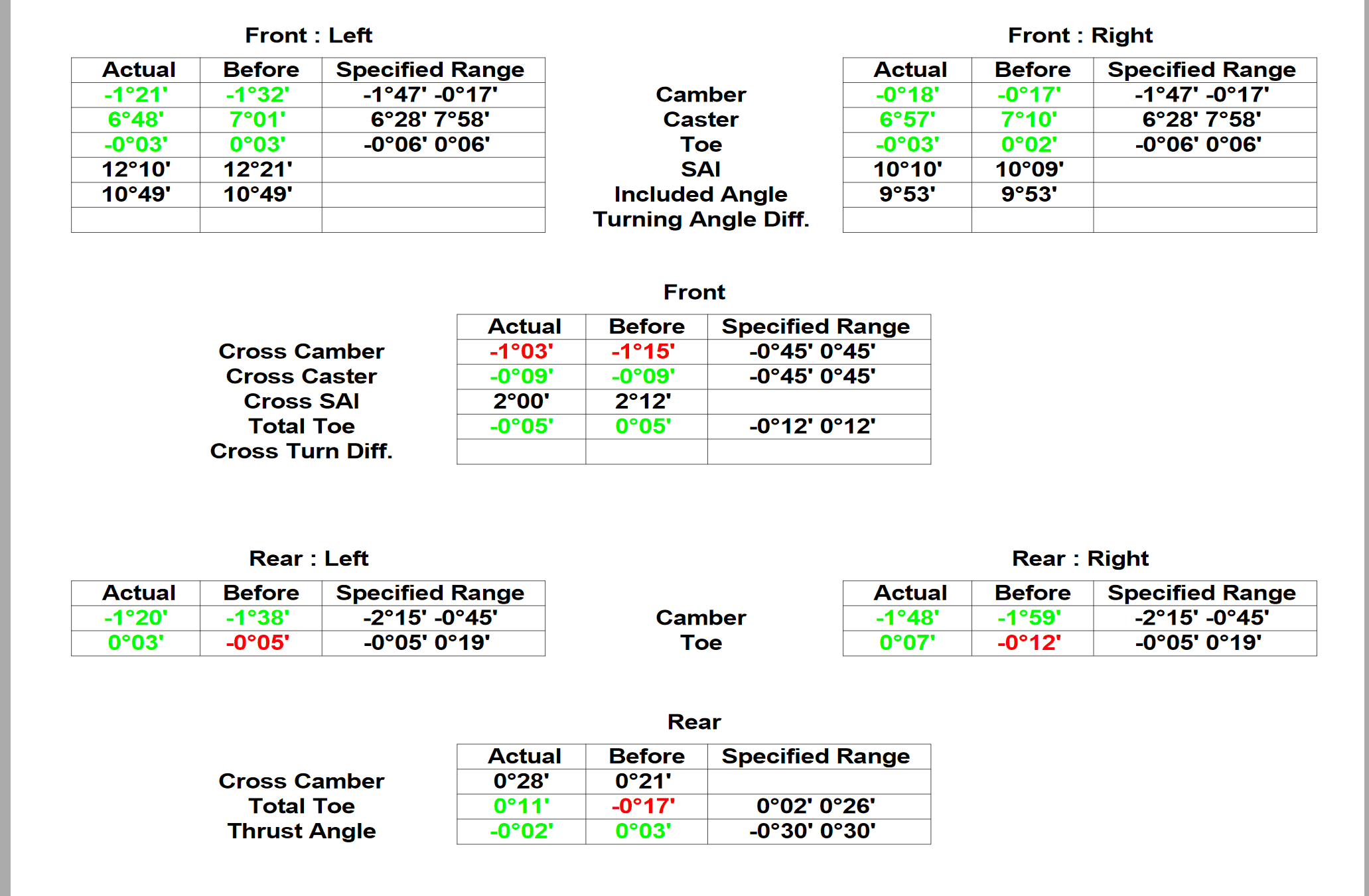

Post a copy of your alignment sheet. In spec does not mean correct.

I don't have a printout of the alignment, though I'll ask them if it's still on file and have them email me a copy.

He did say that sometimes they could play with the camber to allow for it, but Mustang has no camber adjustment. I guess you need to use plates or something?
THinknig about it, I think he maybe said camber was on the edge of the allowable spec, so perhaps that could be something.

From what I know about it (which is not that much!) front cross camber is your problem.
The difference of left and right camber, with the left wheel leaning more to the right, makes the car push to the right.
The values are simply too far apart.
Can be fixed by bringing both values closer together, as the protocol already says (the value for front cross camber is off spec).
If they do not succeed in making the camber on the right side more negative, something may still be bent.
As far as I know, you can't really adjust the camber on the S550 unless you install special top strut mounts or struts with slotted holes (is available for some coilover suspensions).
https://www.mustang6g.com/forums/th...ustment-in-the-stock-front-suspension.170356/
One solution could then be the installation of adjustable camber plates.
And maybe someone else can confirm the reference values.
Wouldn't be the first time that a repair shop is just reading the cards because they don't have the correct reference values specified by Ford.

From what I know about it (which is not that much) front cross camber is your problem.
FWIW, differences between left and right caused me interest/concern as well. The left wheel is leaning in more, towards the right, versus the opposing tire. The differences are more than 1 degree.
You're working on a complex issue. I'd change one variable at a time and see how things go. Can they balance/even out the front camber settings?

I agree and would fix the front right camber to match the left. It s an easy solution if it works.

The toe is wrong, unless you want toe out. Buy some camber bolts and find a better shop.
This may also play a role in how strongly it pulls to the right, but for my understanding the real problem comes from the camber.
But I'm with you, toe in would be preferable and could reduce the problem.
