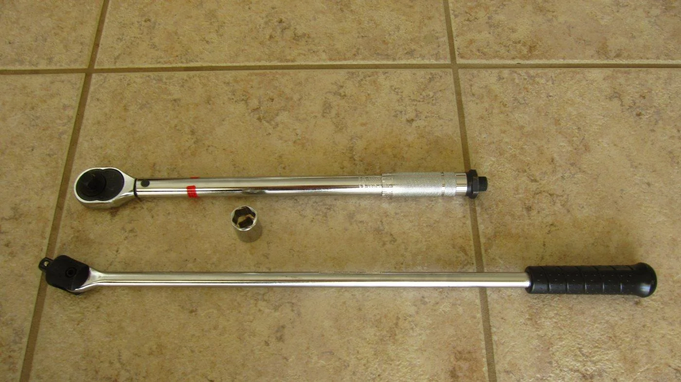

Thanks for the help guys, I ordered a 24 inch breaker bar yesterday, hopefully that will be able to handle the jobs I throw at it.

Impact wrenches are valuable and awesome tools. I hse a DeWalt corded model. Its not as strong as an air-powered impact wrench but its worked for most jobs (but not all) that I've needed it for.
To remove wheels: Breaker bar or large torque wrench to loosen the nuts /slightly/ while the wheels are on the ground (with the car in gear or parking brake on.
Then you can jack up the car and use the impact wrench to remove the nuts.
The impact wrench alone will do most nuts, but an unsecured wheel off the ground will just spin if you try to use a strong impact wrench to take a wheel nut off.
A torque wrench is preferred for tighteneing nuts after you've gotten them close with the impact wrench.
Using a torque wrench for anything other than to torque something to spec is a great way to ruin it......
