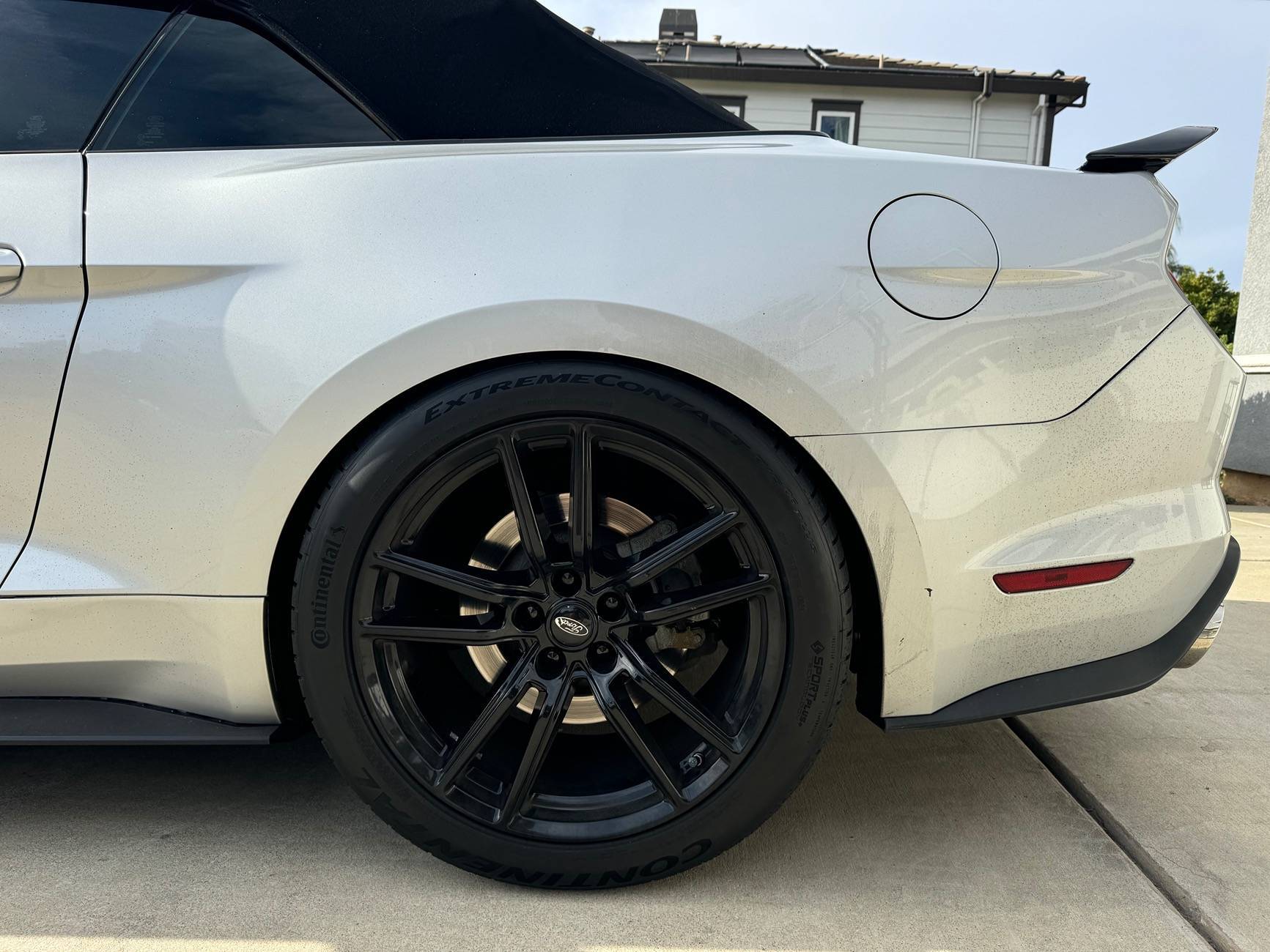

Hey, I have a 2018 Mustang convertible, I was running squared summer tires, Michelin PS4S 305/30/20 all around. After the front tires wore out (alignment issue that was fixed now) I moved my back tires to the front and installed a new set of All Season Continental DWS06 Plus in a size of 315/35/20 in the rear. This was for mainly ride comfort improvement which it was a huge improvement over the PS4S, but also for the look and fitment.

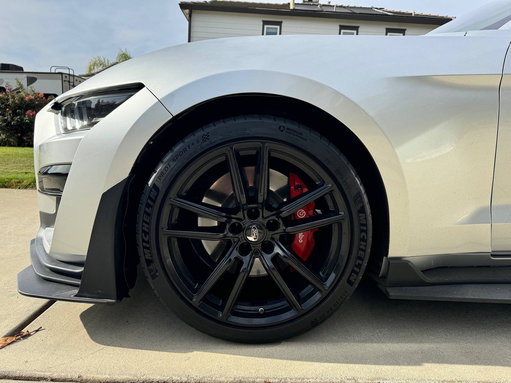

Currently the rear sits perfectly and I have no desire to lower it, the 315/35/20 tire is 1.5” taller in diameter than the 305/30/20 so it’s sitting 0.75” higher up in the rear I’d assume. But up front the wheel gap is a little much, I’ve been eyeing about a 1” drop to improve the look without compromising comfort.

My front springs are the softest OEM made, so I’d guess probably 140lb upfront, so if I went with say BMR 1” front lowering springs it’d be 170lbs. I’m personally not worried about the front being too high of a spring rate, I think the 170 BMR upfront with the rear OEM would be close to a PP setup as that’s a front 165 just without the 1” drop.
I do like that with the OEM front springs when it sits higher it clears speed bumps, curbs and almost never scraps. It’s 80% a looks thing though and 20% for the extra handling as I can tell mine hit their limit with GT350 sway bars on tight turns.

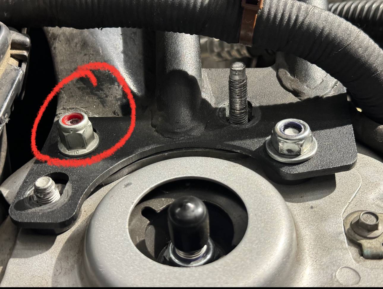

Is this a safety concern/dangerous? The moron who I had install the struts and new strut plates stripped the bolts and only the circled bolt actually holds anymore. Should I just order new strut plates to install asap? I don’t have the money to be spending carelessly but this seems like it could be kinda serious potentially

Yes, I would definitely get that bolt replaced.

11X20 front and rear, fronts are 305/30/20 currently and I maxxed out the rear at 315/35/20.
The front 295/30/20 tires I just ordered are the same Continental’s as the rear tires I have.
I wanted to try the staggered fit first and replaced the rear tires before doing the front to see how I liked it. I have had the back end try coming out at times (first time wasbraking around XXXMPH 🫣) mainly in cold weather where the summer tires are hard though.
The summer or AS Michelins I have had in the past seem to be pretty harsh on all my cars,(great grip though), I can’t really fit anymore sidewall upfront due to already getting rubbing on tight turns, even going from a 30-35 would be too much in the front.
I’m making a trip from SoCal to NorCal today, I have a set of BMR SP089 minimum drop springs for the front I’ll be installing along with the new front tires and I just read about being able to rethread a stud since it’s not broken, so I’ll try that for the strut plate while I’m working on the front end.
