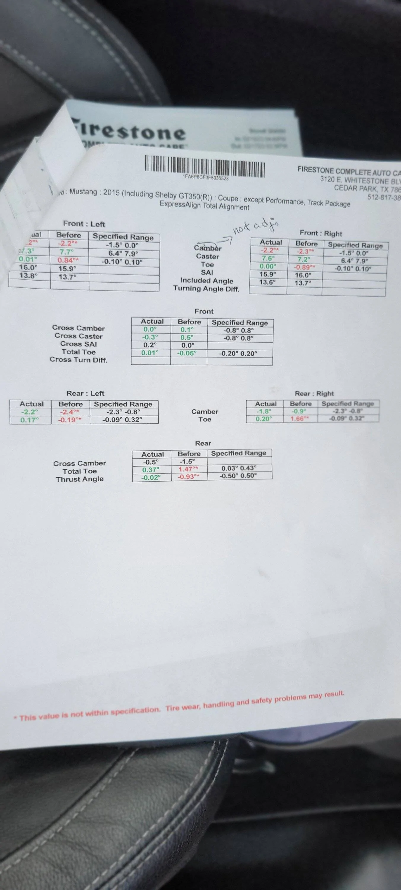

Hey guys, hoping for some insight.
2015 gt pp1, roush 2.3 blower, lowered steeda progressives, bmr cradle lock out L2, bmr vertical links.
255/35/20 ps4s up front (32psi)
305/30/20 ps4s in rear (29psi)
Before alignment I was pulling to the right, after still am. I had alignment done at the same place after doing the cradle lockout, previously was running 19 inch wheels and tires.
Last night I rechecked torque on cradle lockout. The bolts were in spec and cradle was lined up properly. I also recently had wheels powdercoated , and rear left wheel had a wobble that I had fixed. When the tire was mounted there were no issues.
Attached is the alignment. Could the rear camber difference from left to right be causing this?

You had a bunch of RR toe out. You bet your ass it'll pull to the right on the gas.
Right now, I'd look at the cross-camber you have in the rear. You've got -2.2 on the RL and -1.8 on the RR. That's enough to make it pull to the left. Stand up the RL to -1.8 and reset the toe. I bet it tracks straight.
That's what I thought. These firestone mechanics have no pride in their work.
