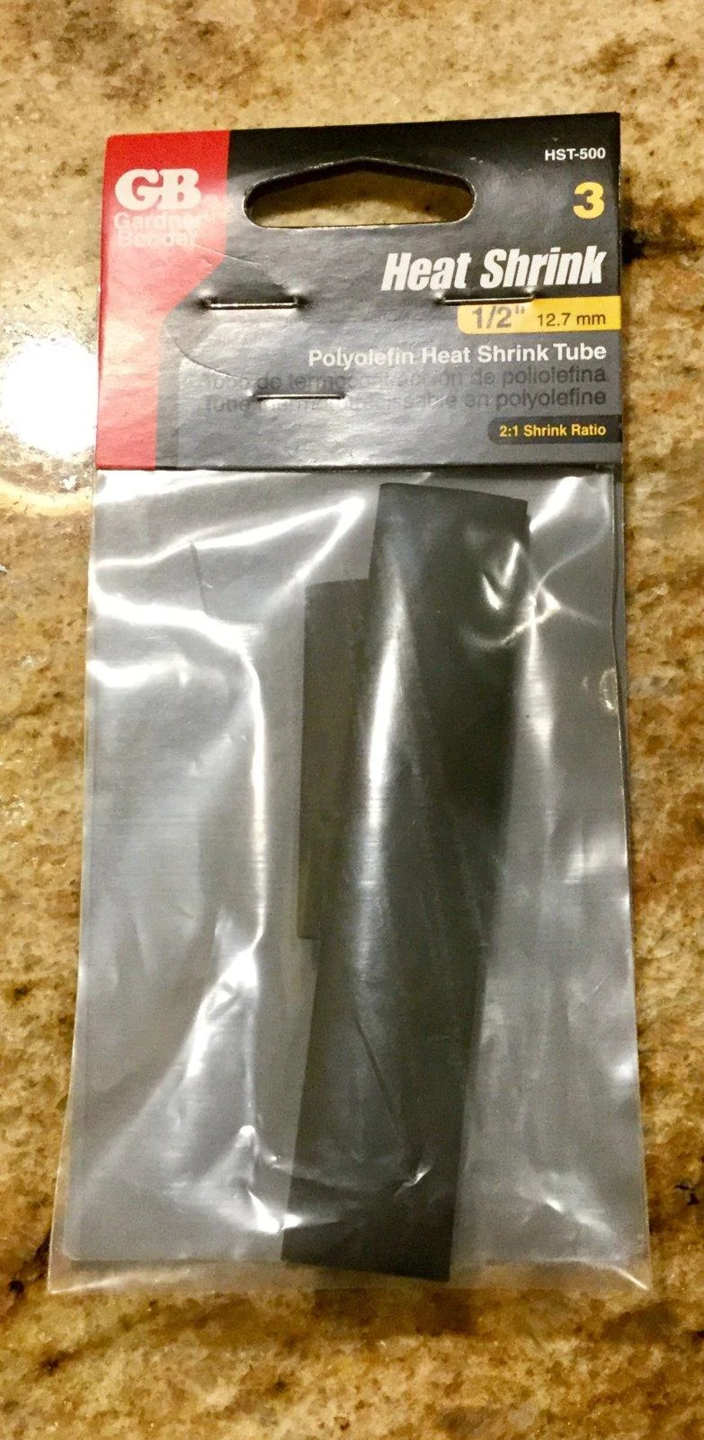

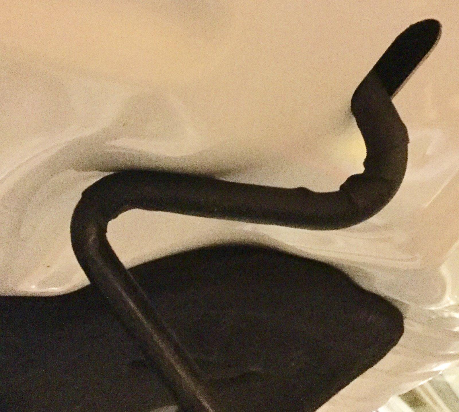

“Real Mustang enthusiasts use prop rods”. So...here’s what I did so the rod would not mar my white hood.
I bought some 1/2” shrink tubing from True Value Hardware ($3.50), fitted the first piece just past where the rod contacts the hood, then shrank it into place with the kid’s blow dryer! They will never know.
Then, I cut a second piece to cover the every end of the rod, so that the tubing did not stop half way around the last 2 curves. Shrank it down...and was done!

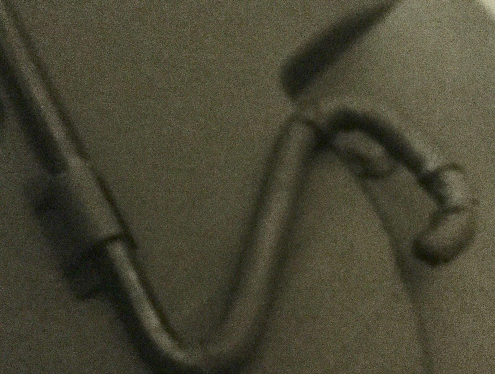

At a recent car show, I saw a GT350 with hood up and he had a bungie cord that hooked into the hood rod slot and to a ring mounted on a point near the rod base. Looked like a cheap simple solution for those wanting to keep the hood rod.

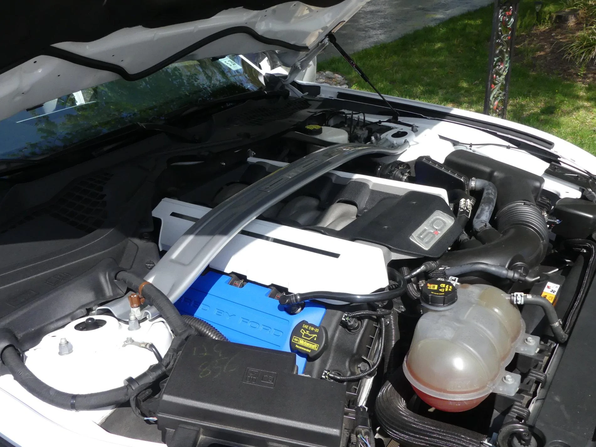

The prop rod or "In the way Rod" is hanging on my garage wall. The set of Redline hood struts are in place on my 2018 GT. By the way they were installed new on my 2011 GT, then on my 2015 GT, and then onto my 2018 GT. They don't seem to be failing and just might make an appearance on my 2020 GT. But I'm thinking why push my luck. I'll probably purchase a new set for my new car. Just Saying.
