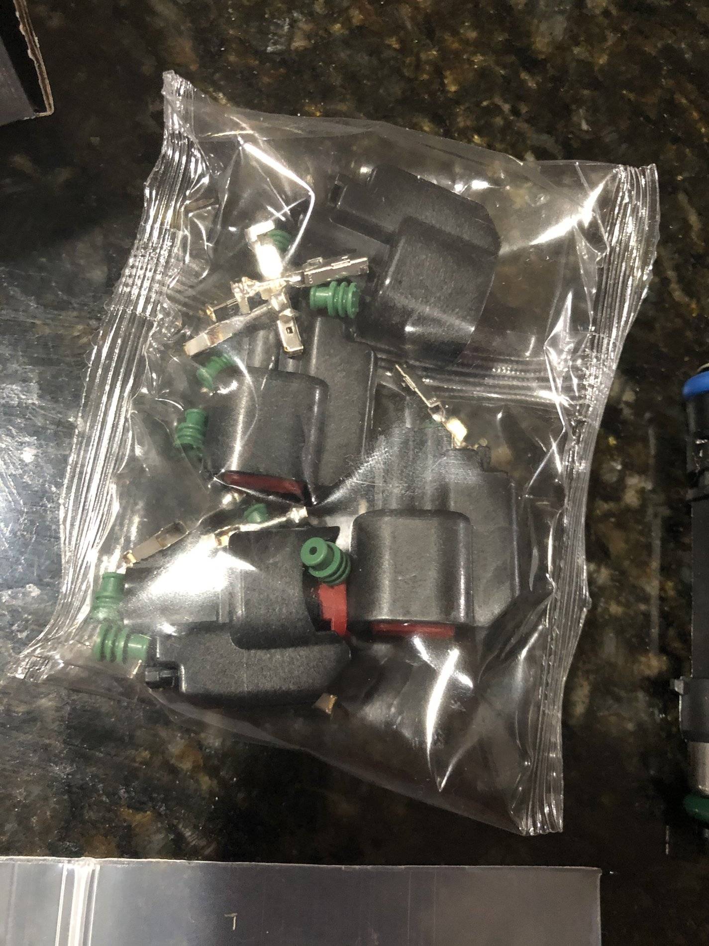

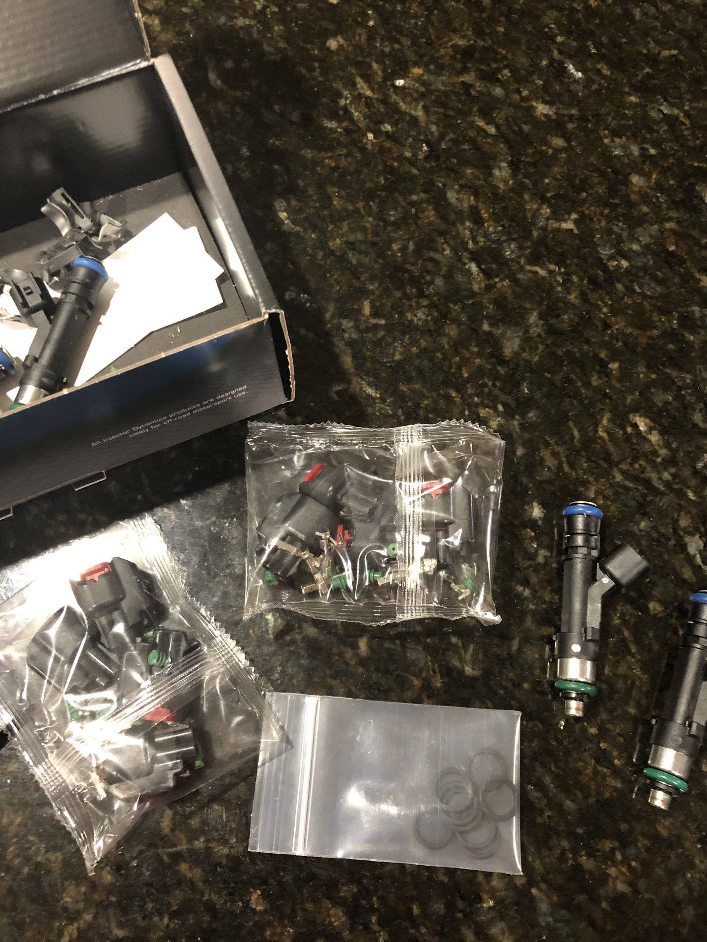

I swore the length of the ID1050x and these 52 lbs injectors are the same. Here is the picture of the leftovers brother.

They are the same length, when the extensions are on them. Notice on your old injector how you can see the spray nozzle? Look at the end of the ID1050x and you will see that there is an aluminum extension on them. In between that aluminum extension and the body of the injector, is another O-ring. Those thin o-rings go on the end that goes into the intake manifold

Extension?? This is the end that went in the instake manifold.

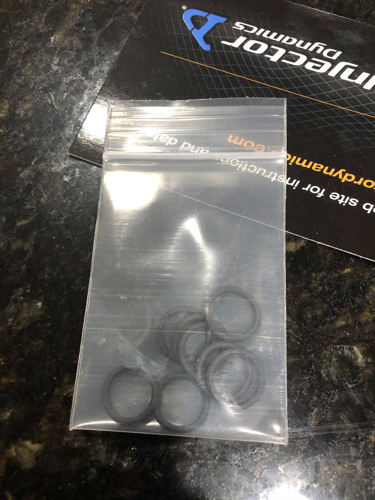

Wtf! I should’ve installed these o rings instead??

These

It’s slightly bigger from just looking at it really from what are installed on the ID’s

Yes sir. I’ll double check and see what’s going on in there. I may have to remove the thinner o rings and replace them with the other and check. It’s only releasing the fuel pressure, rails and injectors anyways like you mentioned.
