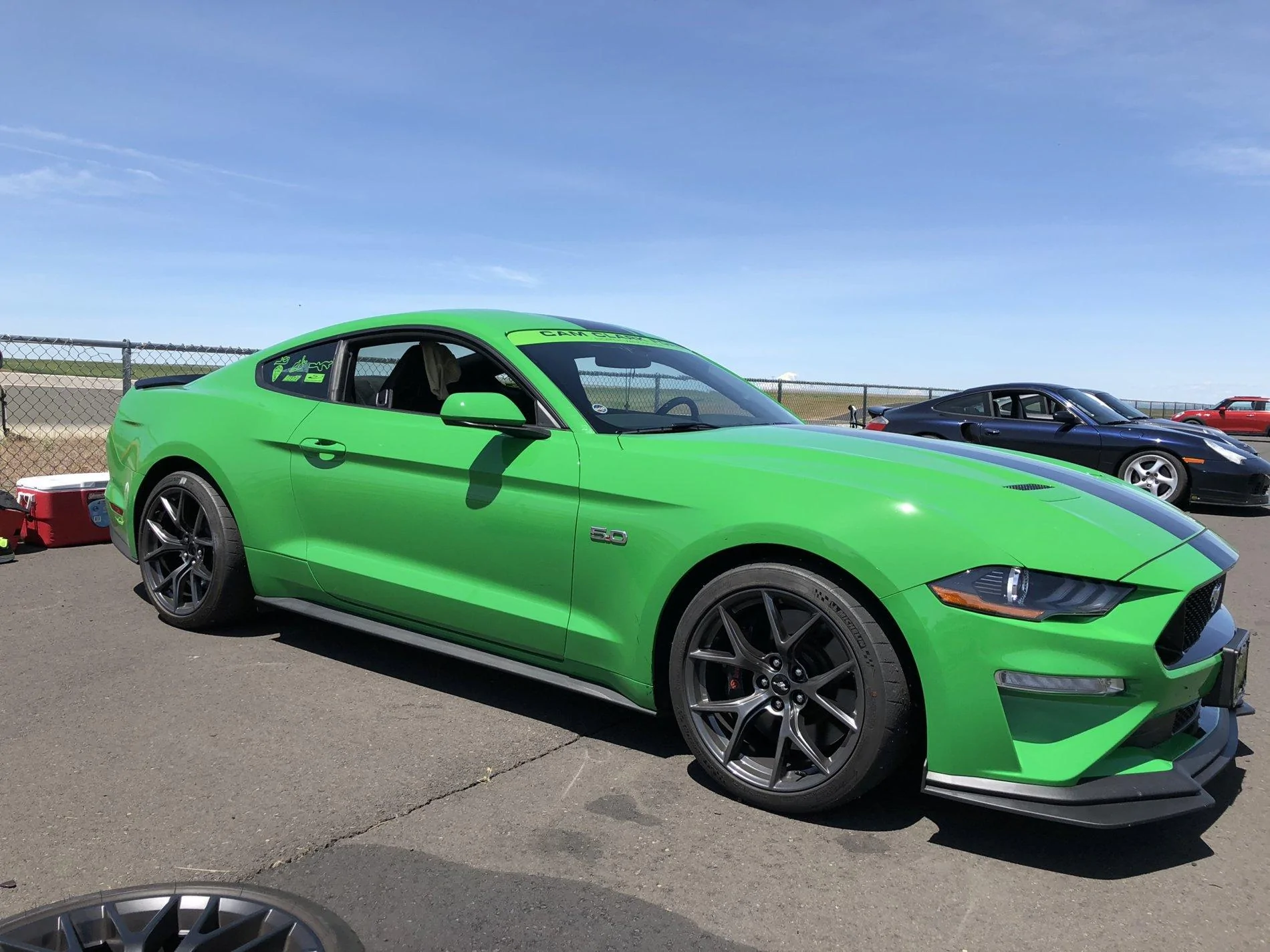

I just returned from two days at Oregon Raceway Park where the ambient air temperature was about 95 F. The car is a capable track car and having installed the Full Tilt Boogie diff cooler allowed me to run often and burn two full tanks of gas driving the tracks. The diff cooler was flawless and if you are going to track your PP2, get one installed. These are my Cup 2’s after the first day and I am running -2.8 negative camber on the front. These cleaned up after the first run on the second day and are generally a resilient tire but would get greasy after 5 or 6 laps and then sometimes you would do some drifting at high speed. Slicks would offer a big advantage, probably 3 to 4 seconds a lap. I loved driving the car on the track and it was great driving 7 hours each way to get there and return through central Washington. Great all around car.

Thanks for posting the info and pics!
