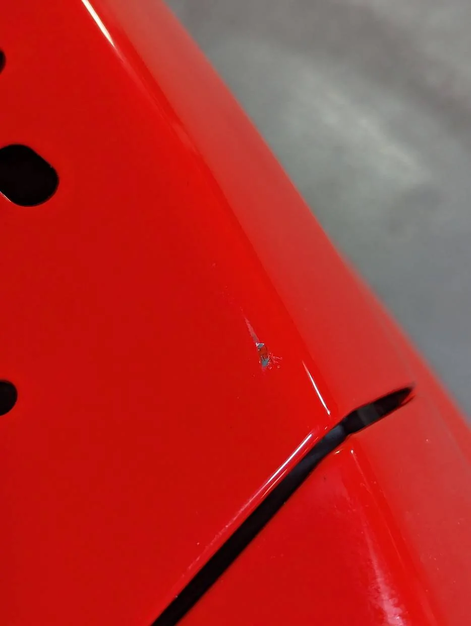

Did you ever get Ford to fix the trunk problem?, my 2019 gt350 has a similar chip on both corners where the spoiler meets the trunk

Yes, Ford covered mine under warranty too.

I just bought a used PP2 and noticed chips on both ends of the spoiler (car has less than 5k miles). Looks like its a poor design, but I was replacing the OEM spoiler with a different one anyway so just used touch up paint to fix it.

Oddly enough, my PP2 has the same chip as the OPs. I tried touching it up, then covered it with PPF but it looks like 🐕 💩.
This must've been some factory install trend.

Yeah, I've even seen it on the PP1 cars as well. When I brought it up to the Ford dealership, they took the time to apply extra double sided tape to the outer ends of the spoiler when they reinstalled it. No issues since. :rockon:
