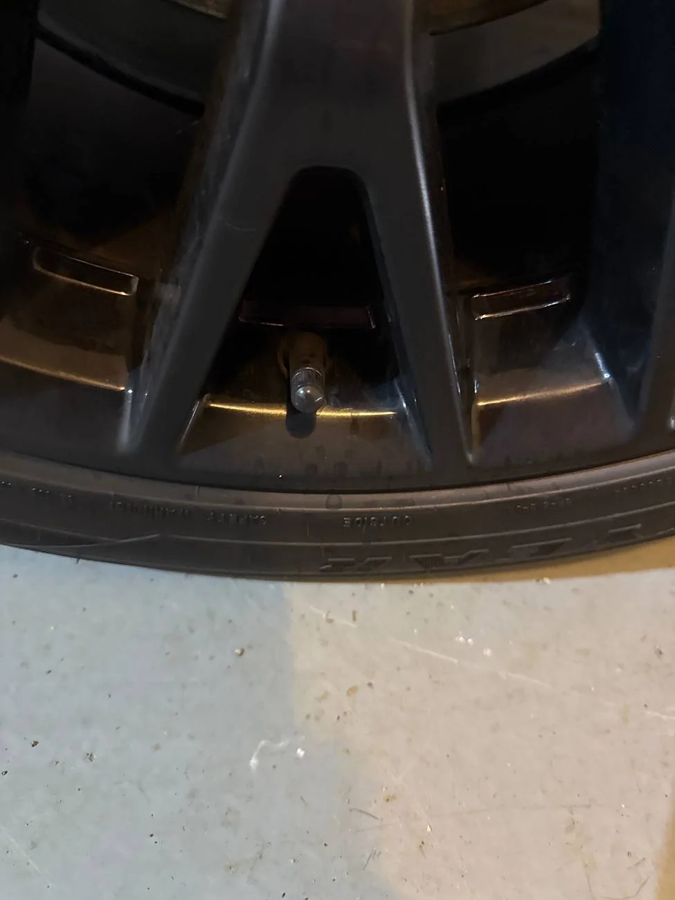

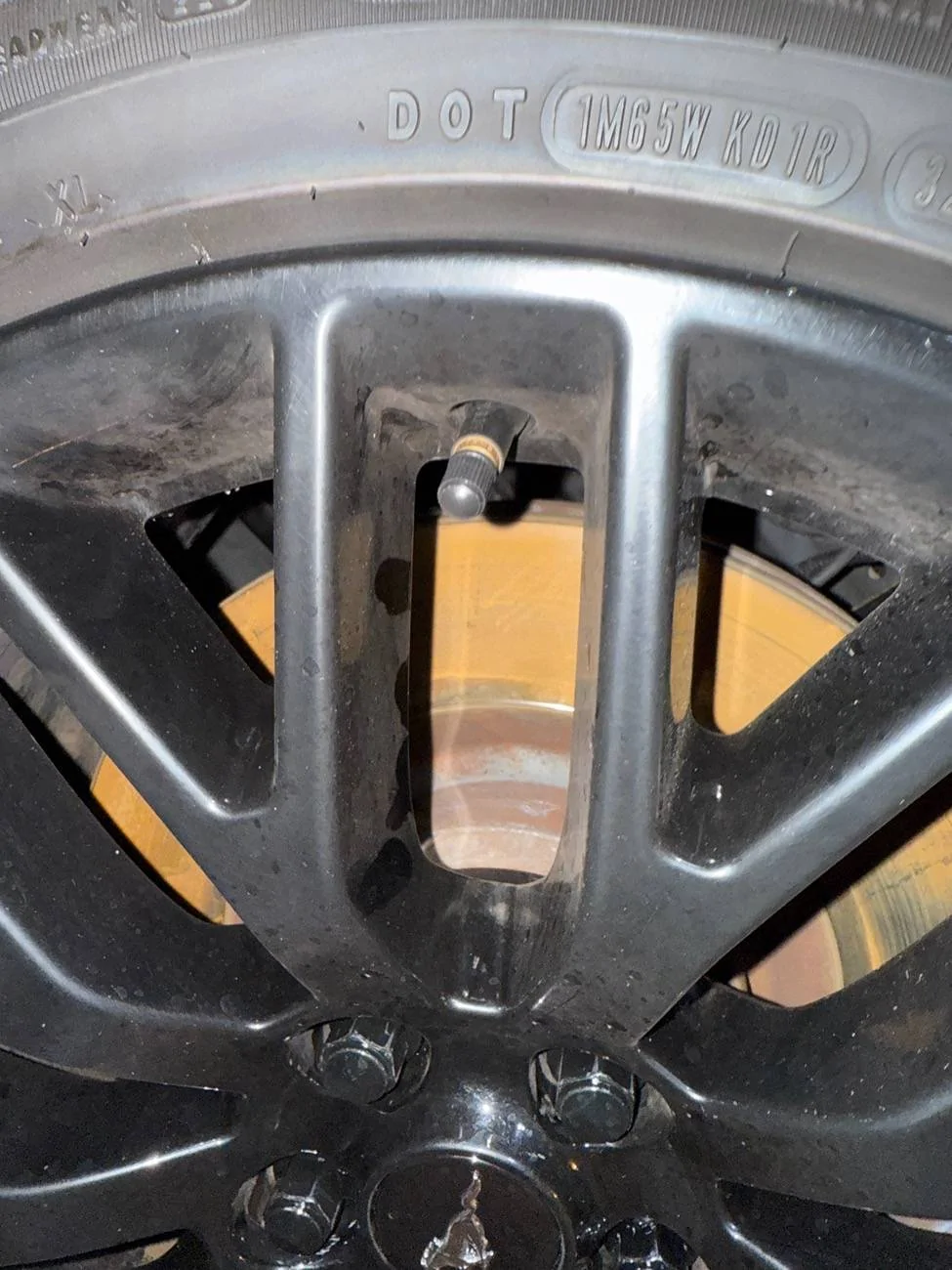

I have a 2021 GT with Performance Pack and magneride. I bought the car used from a dealership and it had 255’s all the way around. Did any mustangs come with a squared setup from the factory or did the dealership mess up and put 255’s on the rear instead of 275’s? Any way to tell if a rim is 9 or 9.5” wide without taking the tire off?

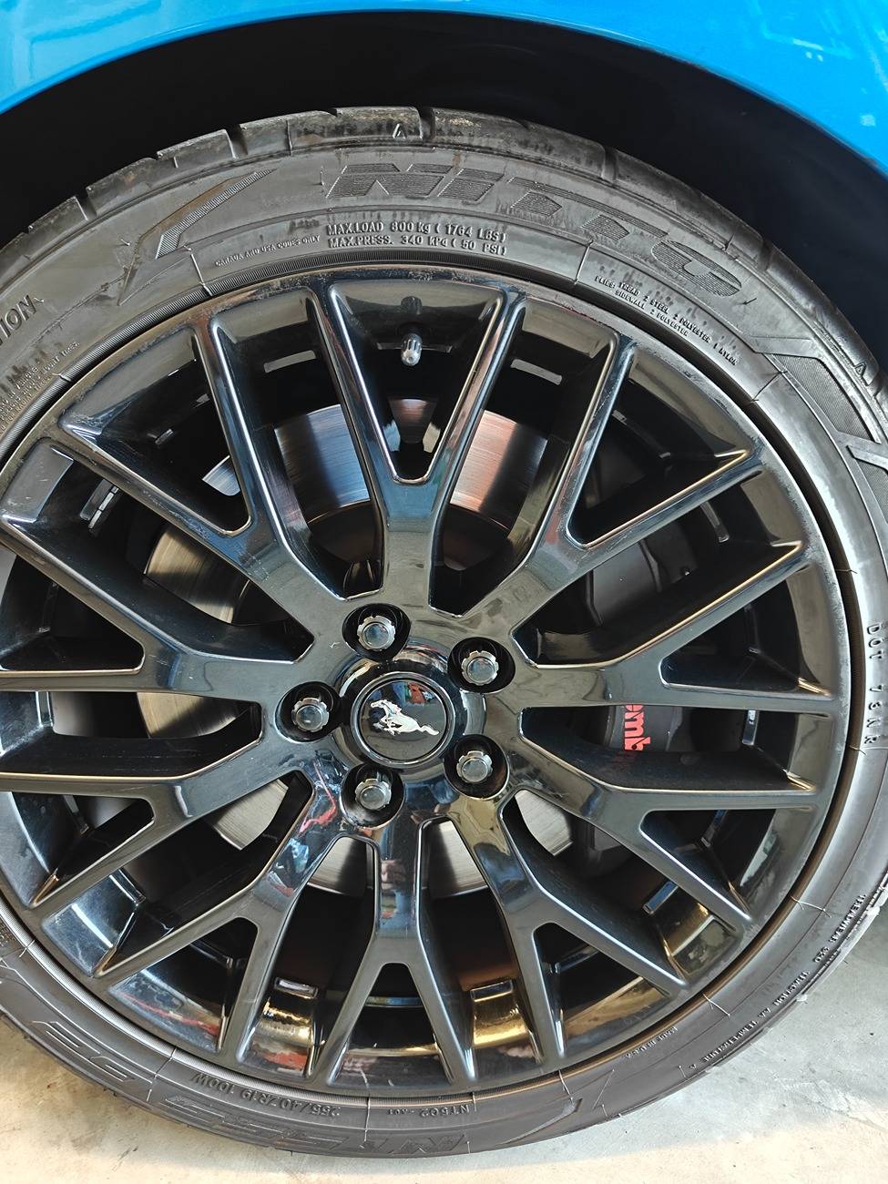

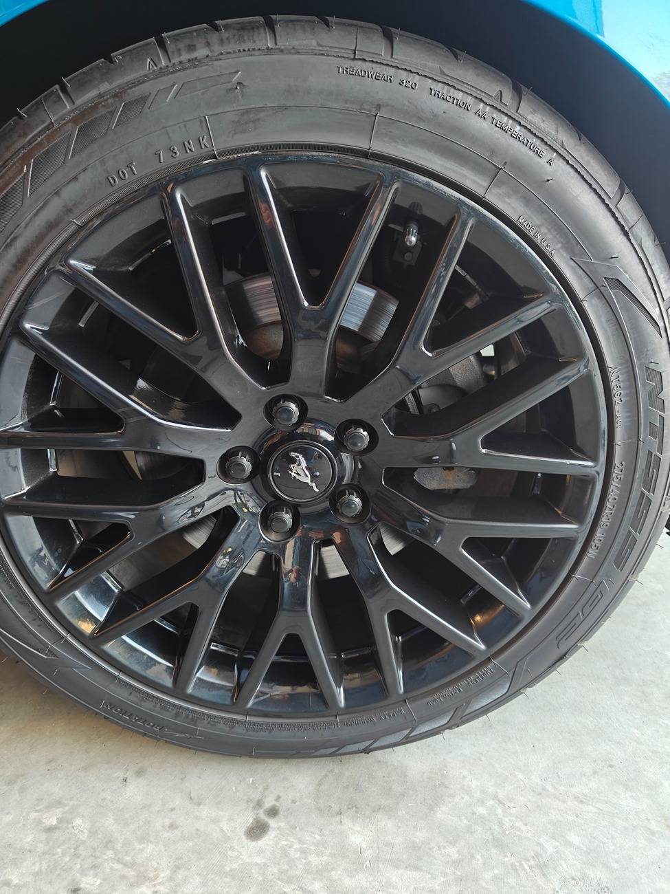

Anyone who know a better way please chime in. Here is how you can tell at a glance. Look at the spoke. The air nozzle sits in the smaller "V" on the 19x9 rim and the nozzle sits in the larger "V" of the 19x9.5 inch wheel.

I can’t thank you enough!! I have the valves in the V on the back and in the larger port on the front. That is awesome you giving me that info. Saved me time and money. Now I know I have 9.5’s, I can get myself some tires. Thanks for all the replies and the help!
