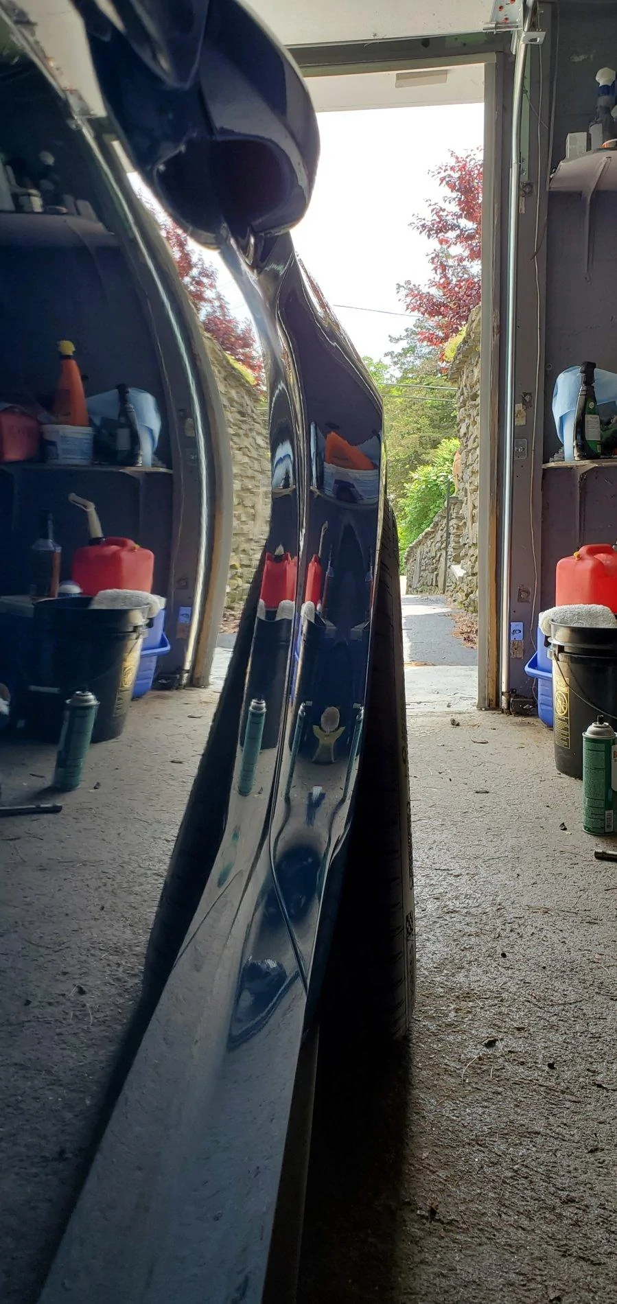

So everyone seems to be getting 25mm spacers for these wheels to get it flush or maybe 1-2mm of poke. I picked up some since my front wheels are really tucked under there and I got like 3/4 inch of poke in the back, its ridiculous. How is this fitting on other peoples cars?

Subframe is aligned with Steeda kit. Both sides are even. These are MY19 PP1 rims with the MP4S tires 275/40/19, maybe thats why? I don't know if they run wider than the Pirellis that came with the 15-17 cars. It doesn't look as bad in the picture but there is a LOT sticking out.

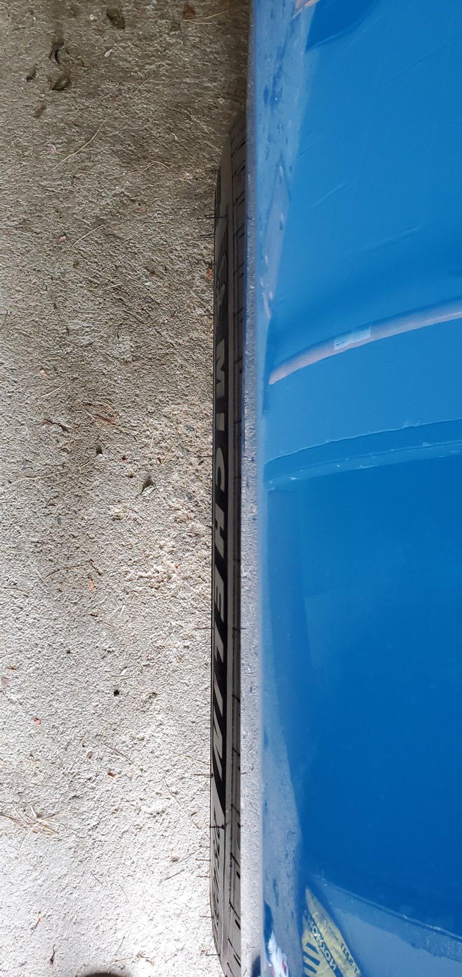

i run 23mm rear and 25mm front and i run a 285/40 rear tire and a 255/40 front
im also lowered on bmr min drop springs .. running as+3,s -1.5 rear camber -1.8 front ill have to get a rear side shot i have no poke at all

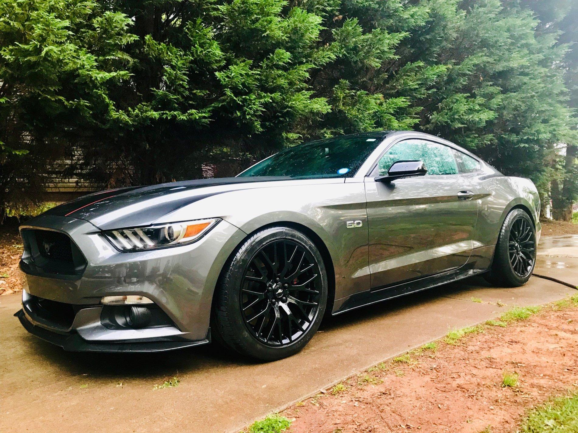

Stock PP1 wheel and tire setup, BMR springs, and 25mm billet hubcentric spacers all around from CJ's. I drive very aggressive mountain roads and it doesn't rub at all. I am still trying to find a set of used 9.5 front PP1 wheels to go square.

Looks good! The difference is definitely the MP4S tires they're a lot wider on the rim than the Pirrellis.

Man, I may have to try those some time. I plan to report back whenever I step up in tire size. It seems like nowadays newer cars are coming from the factory with the fender lips rolled in which is good.
