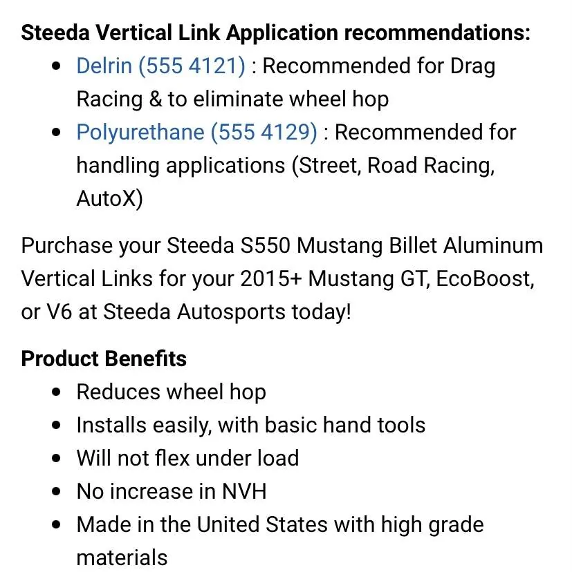

Delrin and spherical are supposedly better for drag and poly is better for street/auto cross/ general hoon
