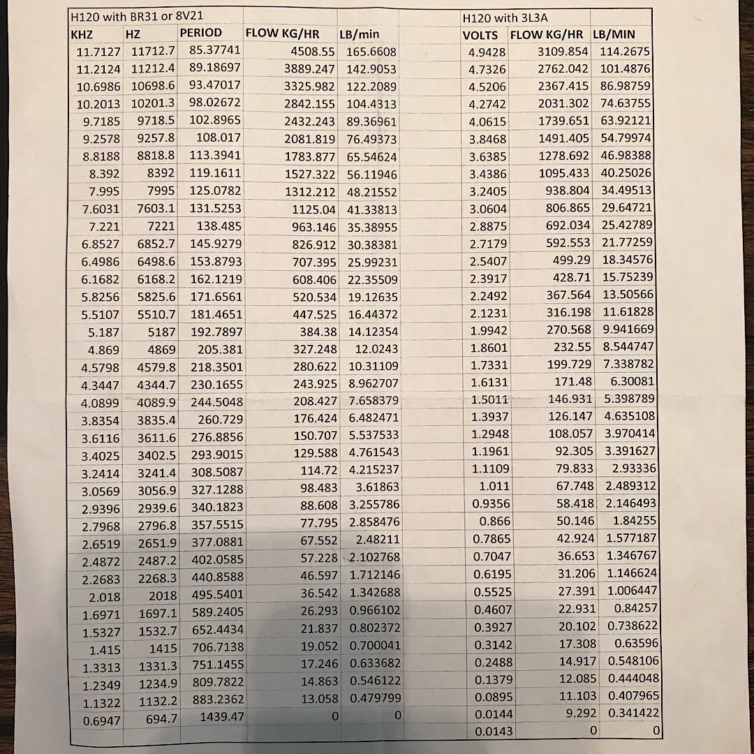

Just got a great deal for a tune required kit for my 16 Mustang. The seller sold the car but doesn’t have the transfer function for the maf that they send you does anyone have it? But my main question is I’m in Florida and this car see a shit ton of rain do you guys close the bottom on the turn signal vent so water doesn’t drown the filter? If so what do you guys use to seal it off. I saw someone on here the the gt350 snorkel on here gt and open up the hole for it on the air box tonfeed it fresh air from the grill like stock how many other of you have tried this. Summer temps are coming fast in Florida and I don’t wana kill power with super high iat’s . Thanks all
Not sure what you are looking for. You use your OEM MAF for the Tune Required PMAS. I ordered the CAI/Lund combo and they used my car info. I never drive in heavy rain so i can't comment on that other than having NEVER heard anyone having issues. I hosed my car down good the other day with a high pressure washer and the filter never got a drop.

I also have the PMAS tune required intake with a Lund Flex Fuel Tune. I used my factor Sensor. I’ve never had my filter get wet from rain or washing. Also, IAT’s rise at low speed or idle but not nearly as much as you think. It’s really not an issue.
