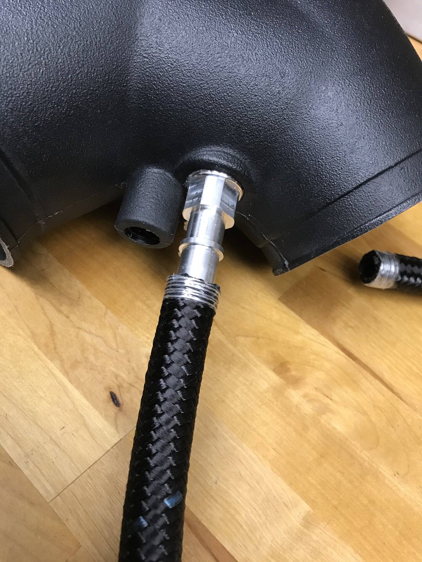

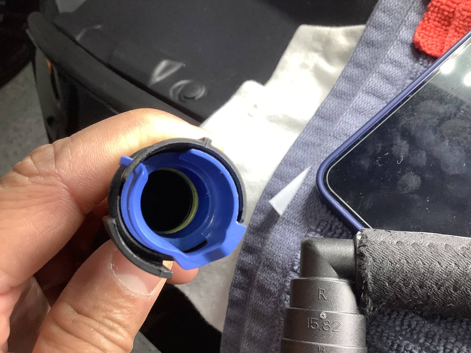

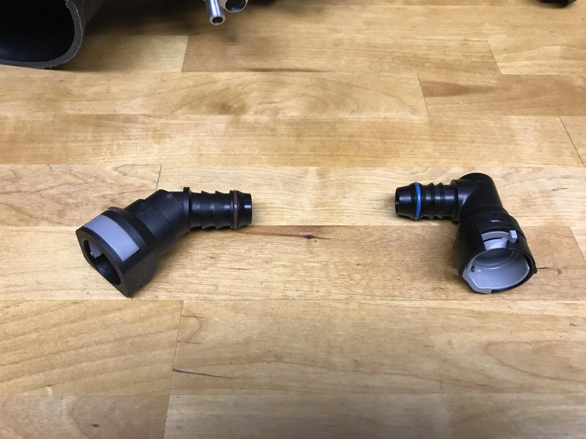

I’ll take some more pics of the supplied hose from PMAS GregO. PMAS sent a short section of hose with similar connections to the ones in your pics. Believe it or not, the angled nipple on the PMAS hose won’t lock into place on the nipple in the intake tube because the I.D. of the fitting is smaller than it needs to be. Re,o ing 1/4” from the nipple,and chamfering it again could correct this (might even give a little more clearance too). The factory connector does lock into place, as it’s not obstructed like the PMAS fitting. SMH

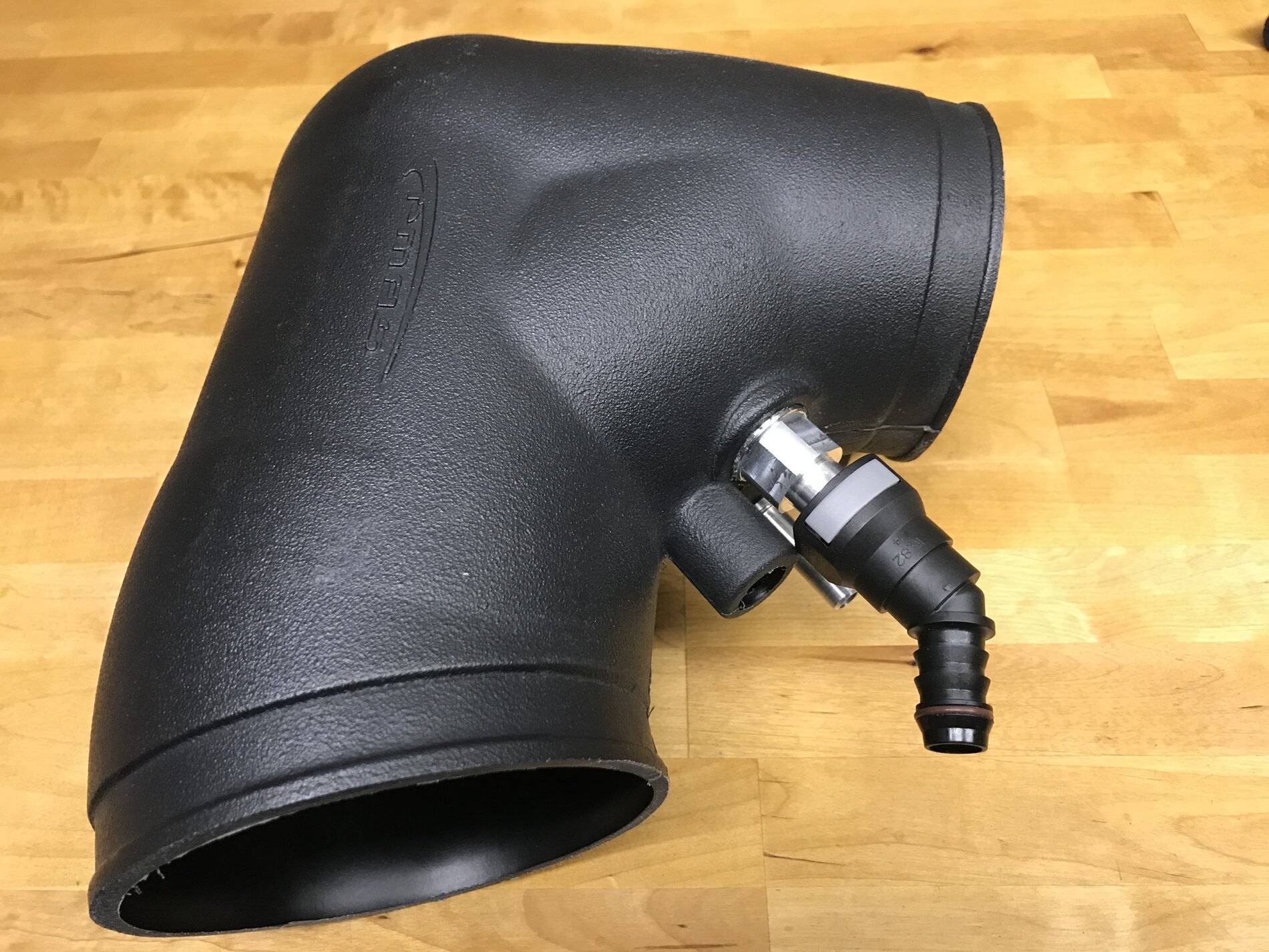

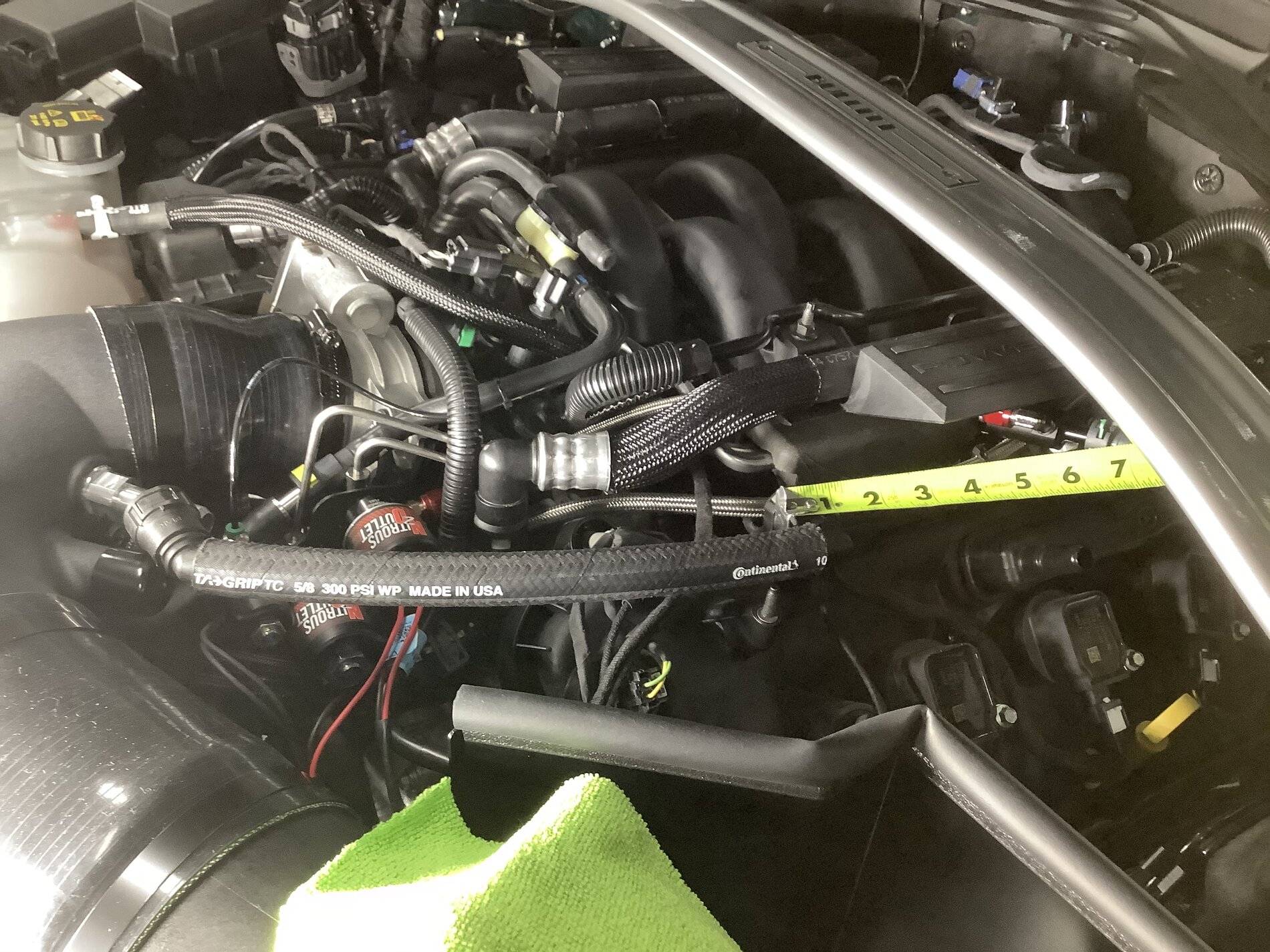

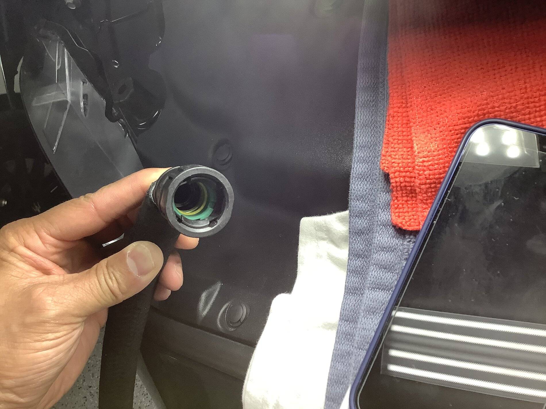

GregO, here are the pics of the hose that came with my PMAS. As you can see, the PMAS hose is short by 7-8” and the fitting has a lip inside preventing the fitting from locking onto the nipple in the intake tube, whereas the factory fitting is unobstructed. The kit is not exactly plug and play for 2018+ GT350 intakes, which explains the shorter line And fitting issue. I’m assuming that on pre 2018 models, the fitting on the drivers side valve cover is toward the front of the valve cover, whereas mine is located in the middle of the valve cover.

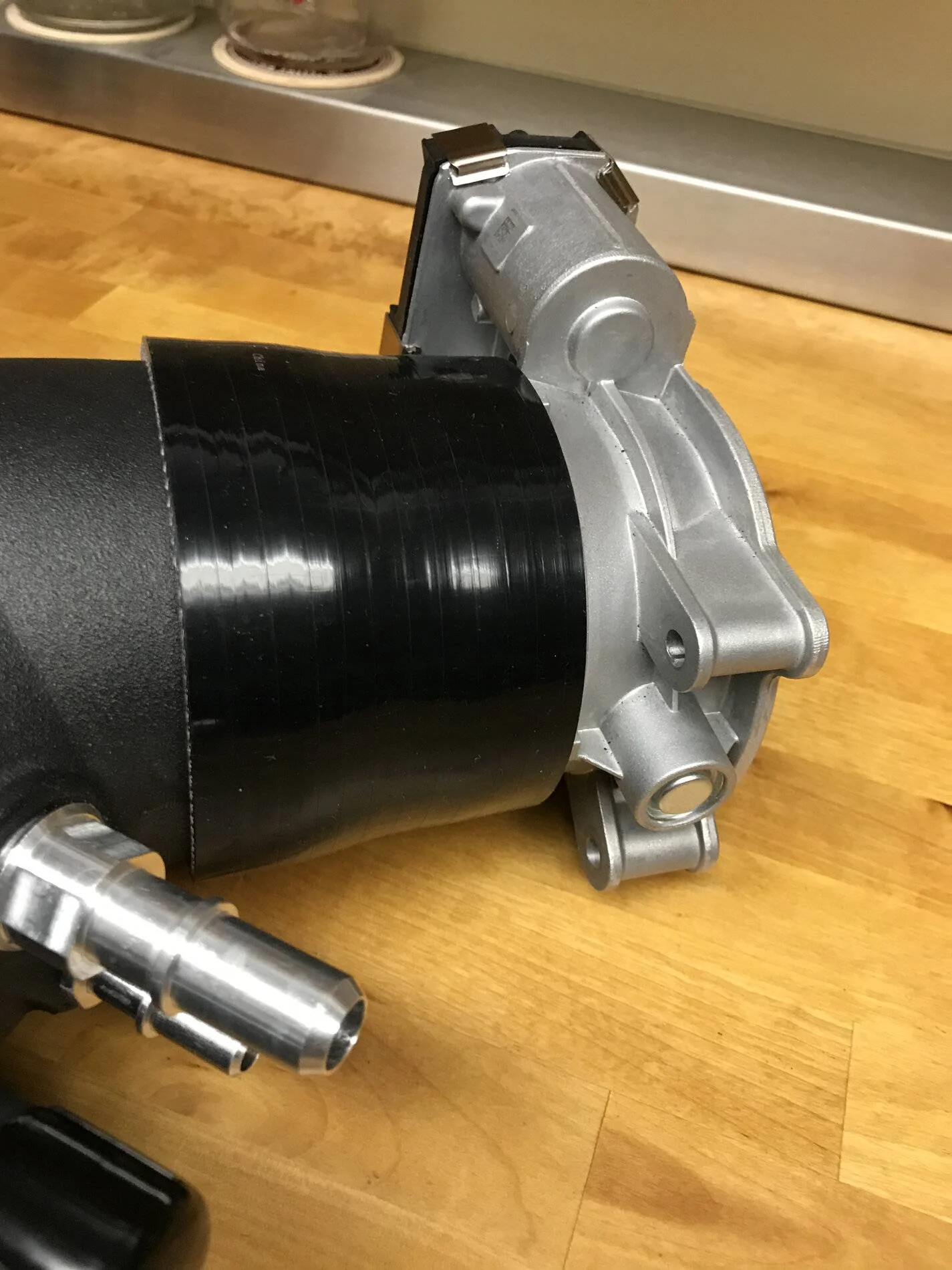

PMAS sent you the wrong TB coupler. That coupler is for a 80mm TB not the 87mm GT350 TB. I can tell by the way it’s stretched out over the TB connection.
It should look like this;
