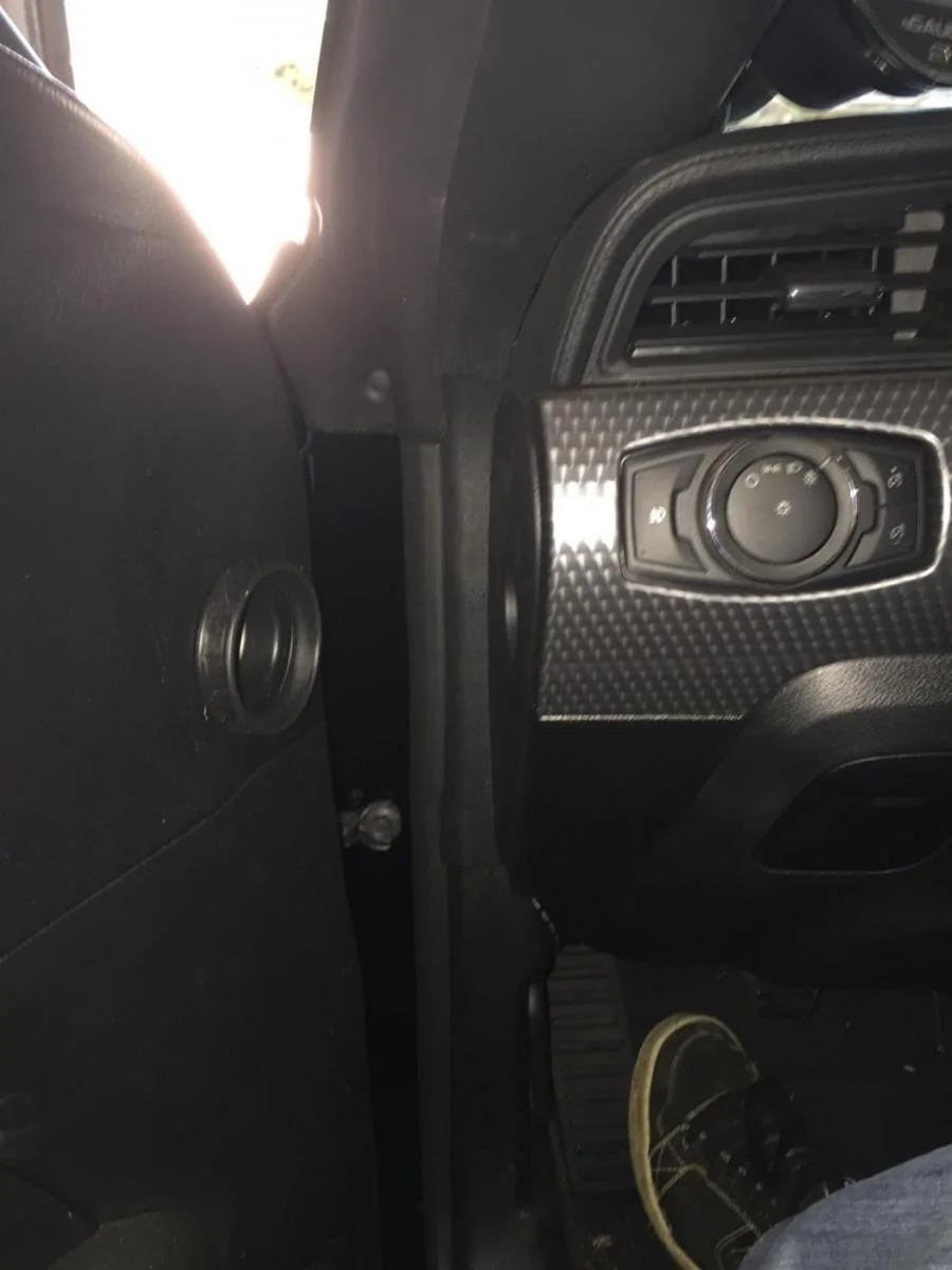

I'm trying to run the cable from the obd2 to the back of my ngauge mounted on the left portion of my windshield but I can't tuck the cable into the the car to make it hidden. Can some of you guys post pics of your set up and how you hid it? Thanks

I took the plastic off my a pillar and the plastic off the bottom left of the dash an fished the wire up thru that way. The dash pad is soft enough to get the wire between it and the a pillar

I didn't pop anything off and gently massaged it in there. I wish I could post Picts w my phone to here

Just read somebody talking about running the cable under the weather striping.
This.
Removed the trim from the left side of the steering wheel, it should be three panels you remove, the a pillar, and then you will see where you can tuck it behind the dash and up to the garage.

i just run it down the left side over the steering wheel , then cross it back over the steering wheel
