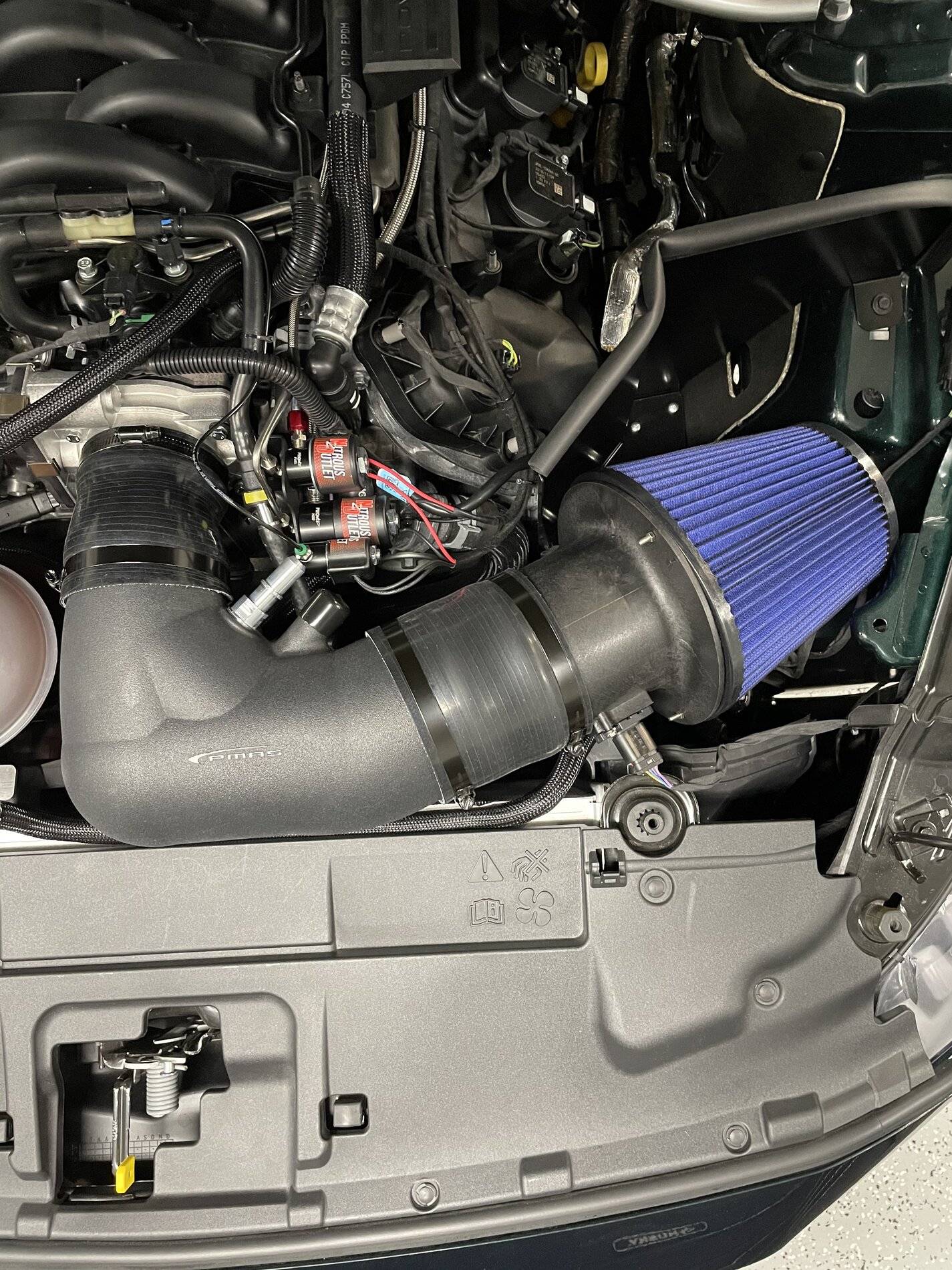

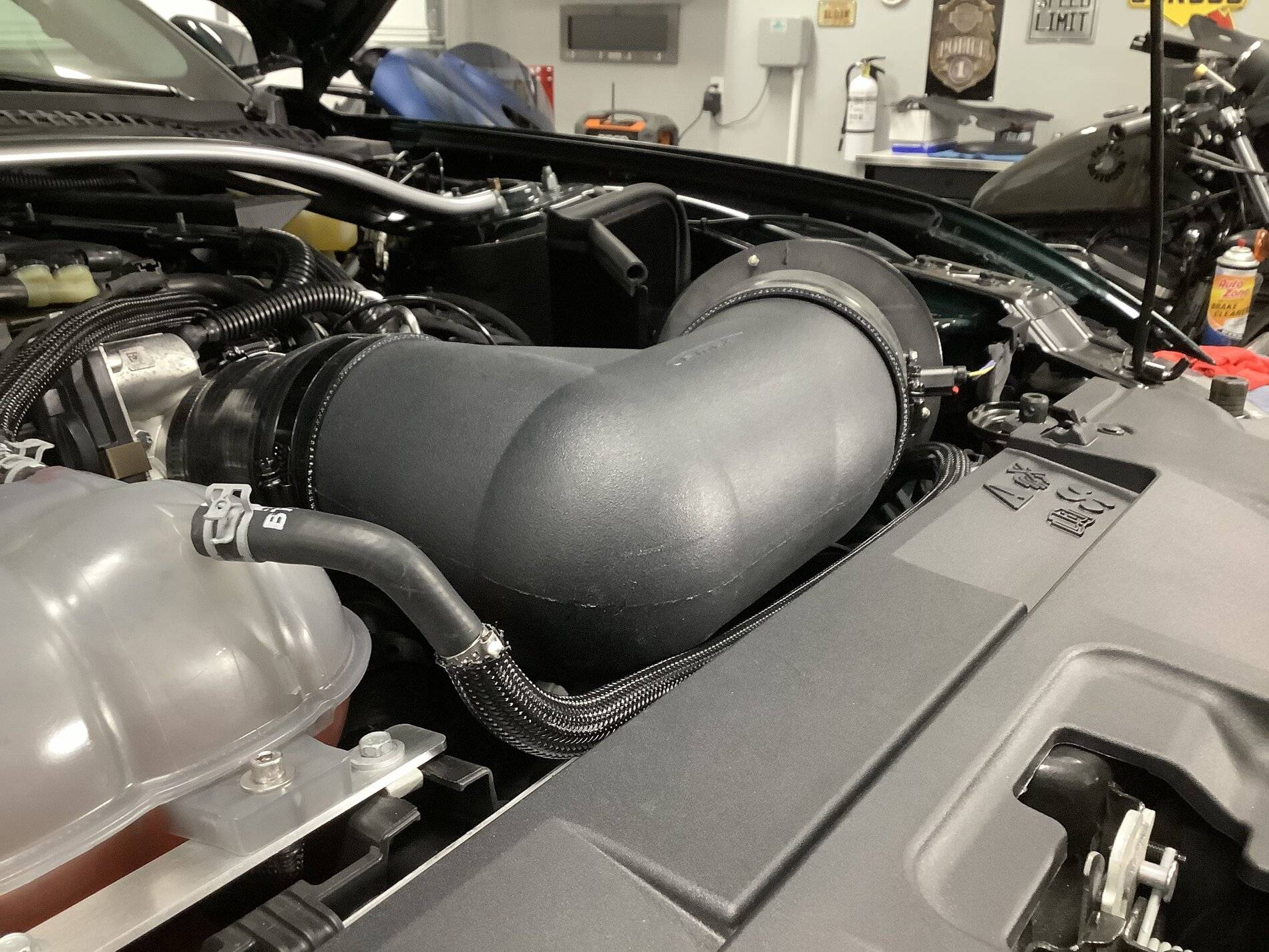

I actually have that coupler too. The one shown in my pic is the one with 20* downward angle. It’s a little longer to push the intake tube out to give more clearance for the solenoids. PMAS’s product description says the coupler was intended for GT and GT350 models.

So the purge solenoid isn’t really an issue.
Are you open to using a longer pc. of .625” SAE 30R7 or 30R14 hose, retain the OEM QC 90 elbow and ditch the OEM fitting connection to the PMAS quick connect nipple.
Cut .625” hose to desired length with quick connect 90 on valve cover end and slide hose onto PMAS nipple with a spring clamp or worm drive hose clamp.
This way the Coyote OEM designed pcv flow circuit is as designed by Ford. Air pulled after MAF and before TB into left side, thru engine block out right side, back into intake plenum behind TB via pcv valve.
Yes. I’m open to this too.
Those solenoid locations have really been the devil in the details.
PMAS needs to do better than stretching couplers to that extreme.

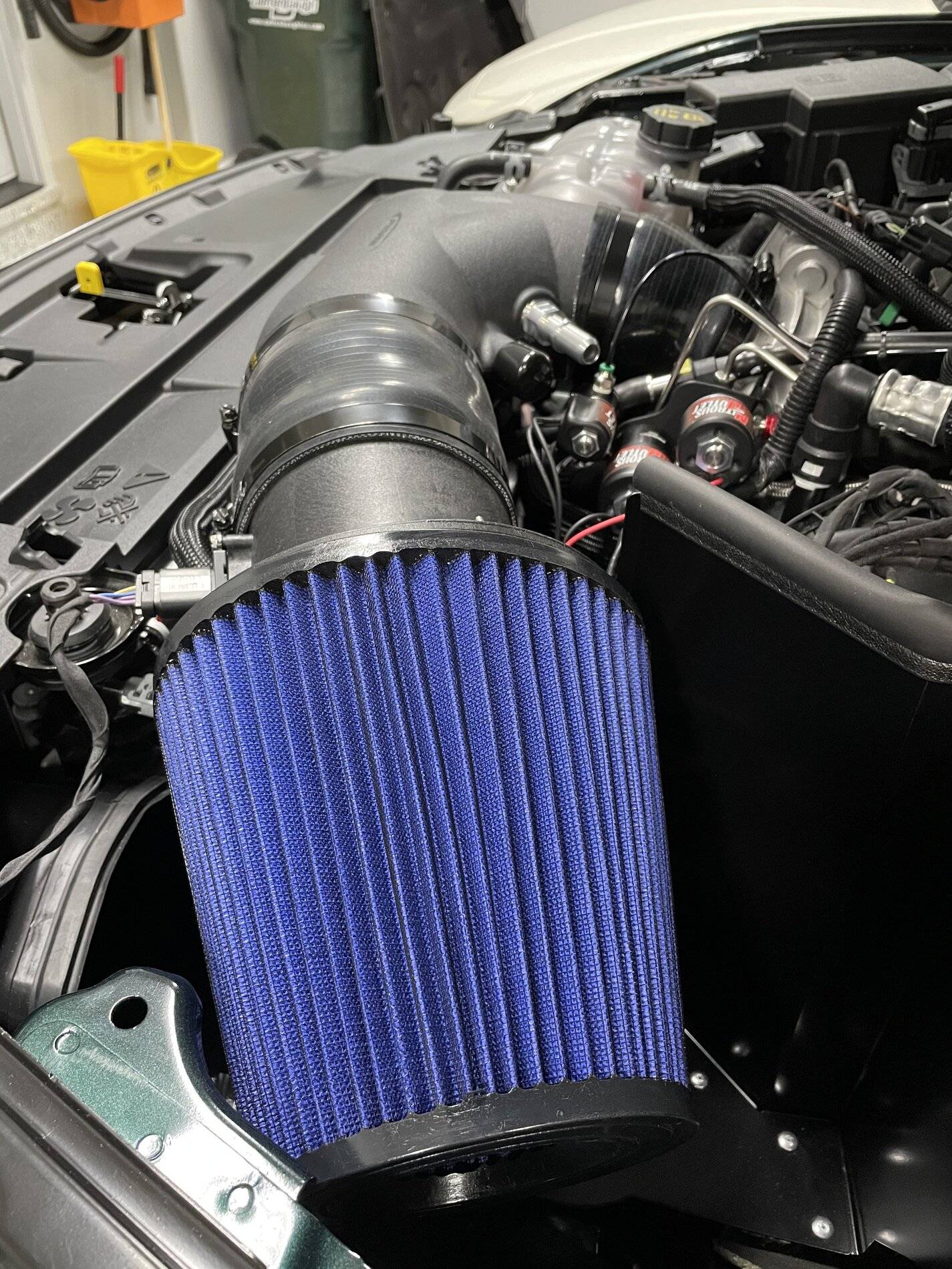

I said to heck with it and ordered the dual breather filter kit from LMR. I removed the Ford Performance oil restrictor in preparation for the filters which should arrive tomorrow. I will be blocking off the intake manifold nipple, as well as the nipple on the intake tube, so sucking unmetered air won’t be an issue. I may add a third filter in the oil filler cap. JPC Racing offers this and calls it their stage 3 breather kit.

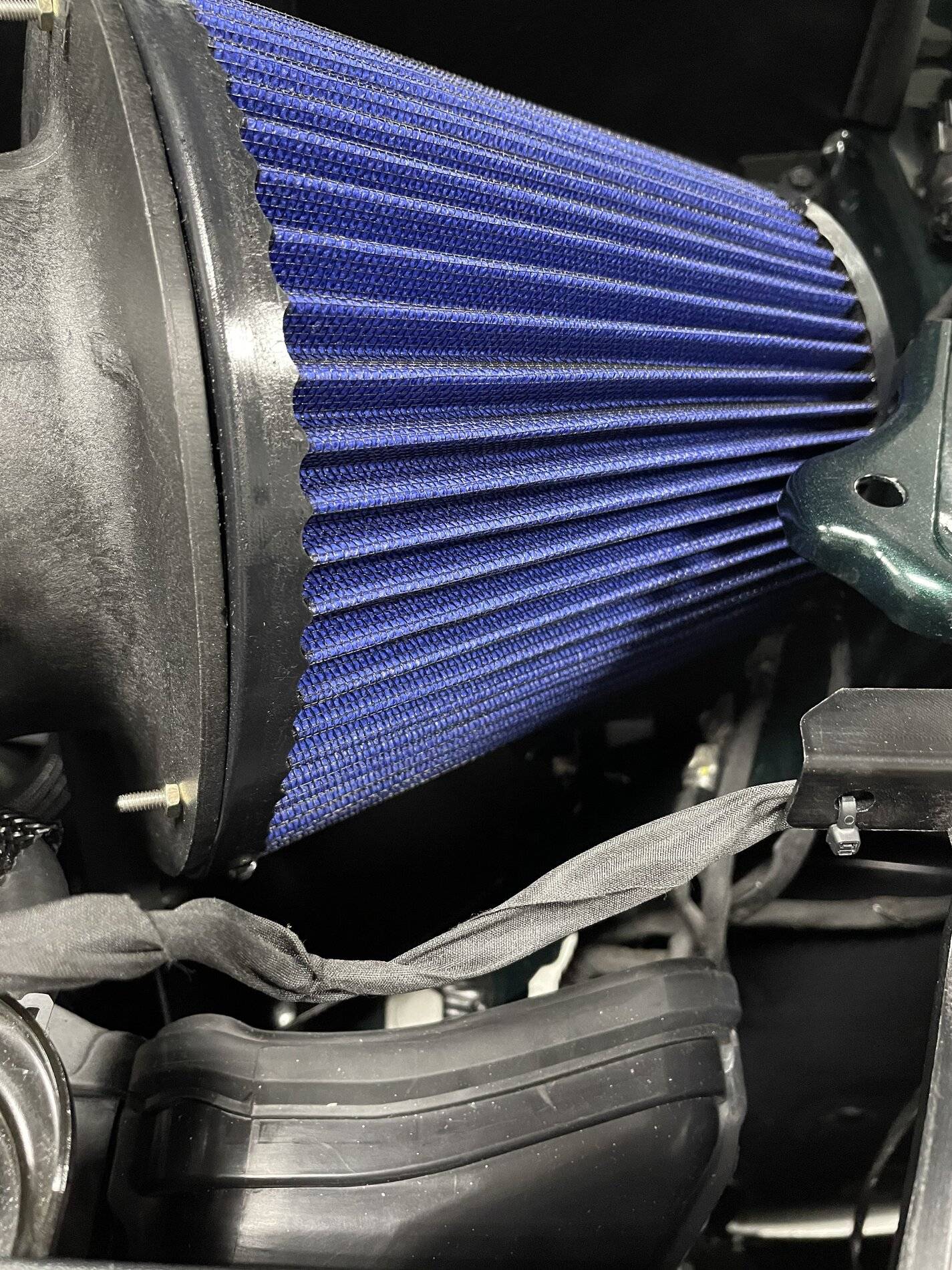

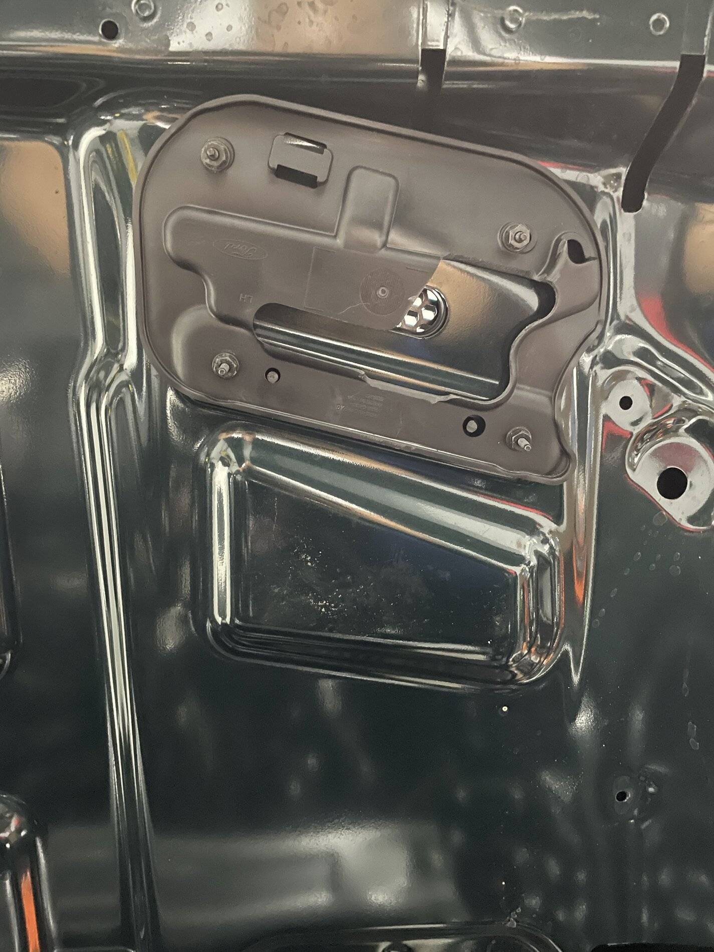

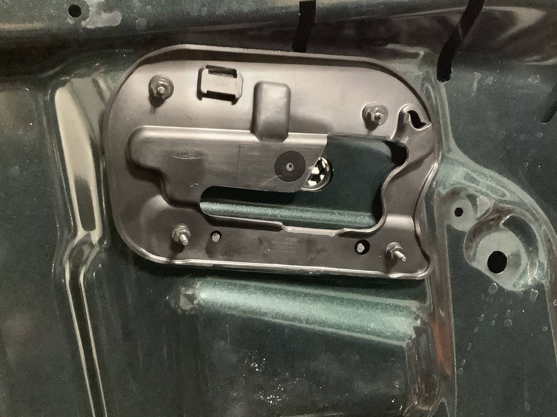

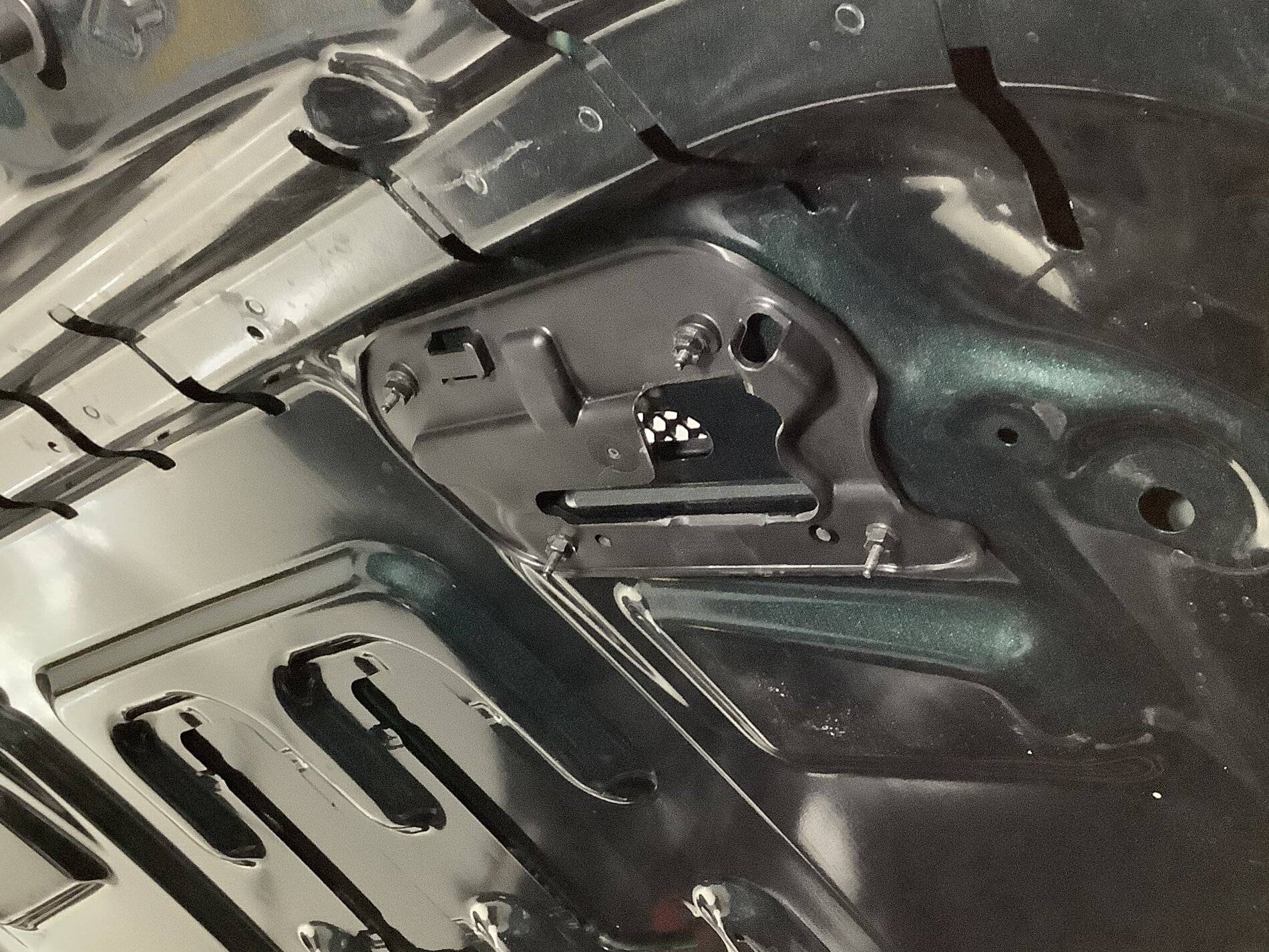

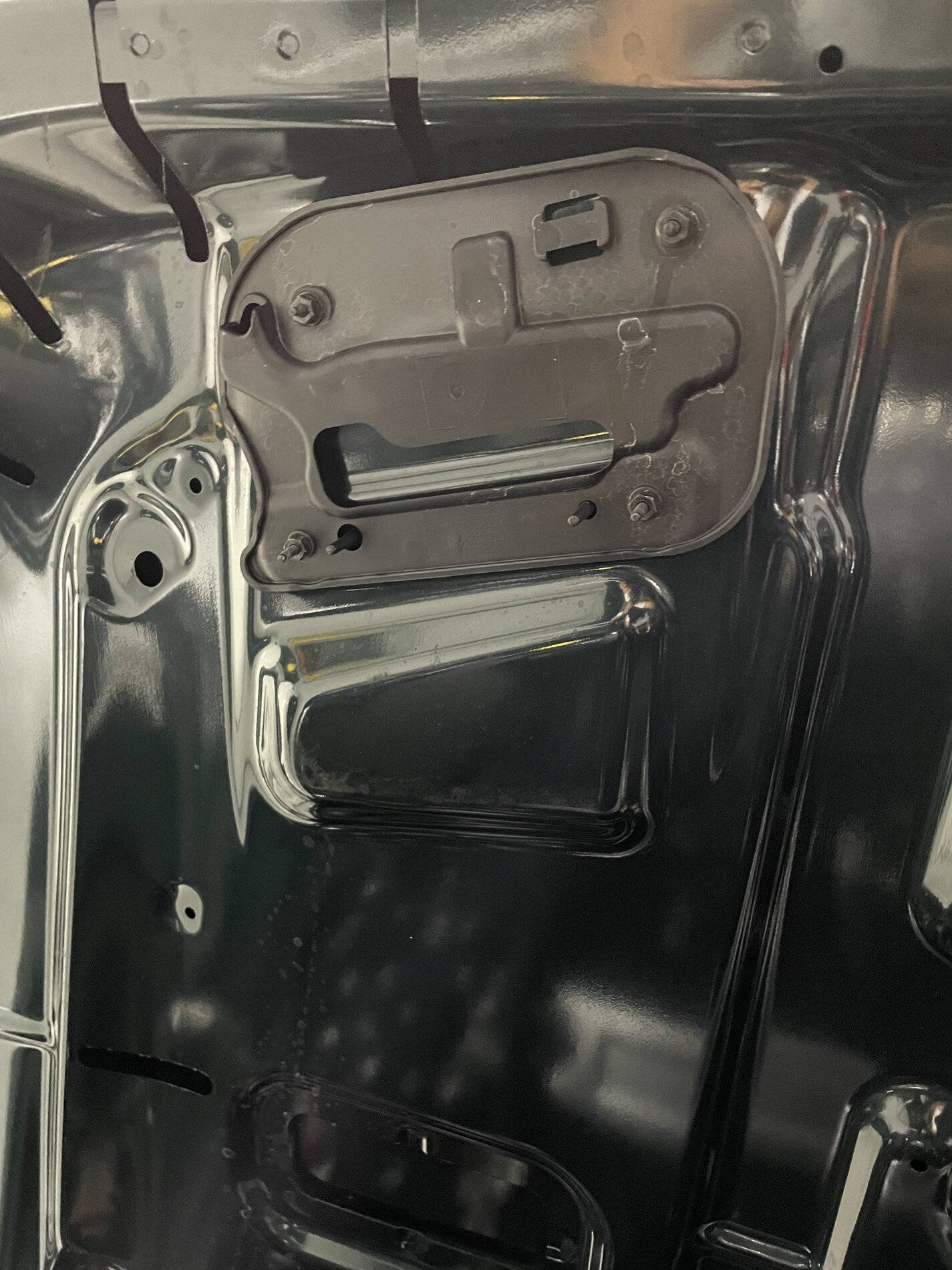

I have to say, the PMAS took some very careful orienting to provide the necessary hood clearance. I ended up having to remove my hood insulator and the driver’s side hood vent to modify it (enlarged the opening), to clear the air filter. As much as the PMAS cost, I didn’t want to close the hood and smash or damage the air filter.
Passenger side vent - unmodified
Driver’s side vent - modified
