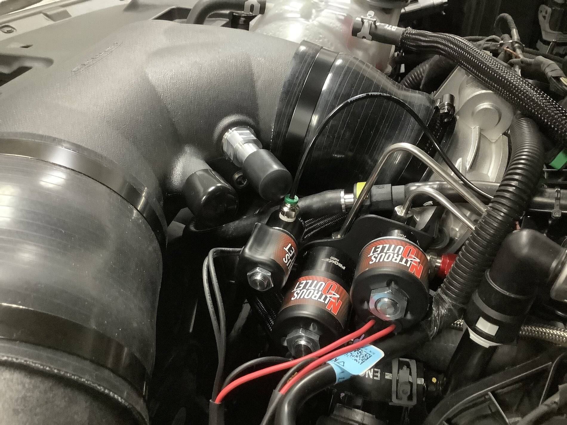

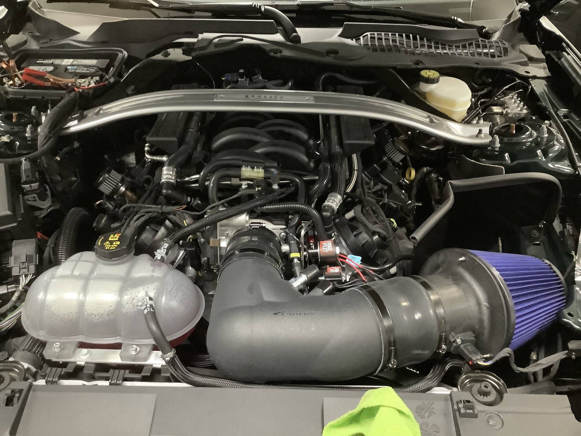

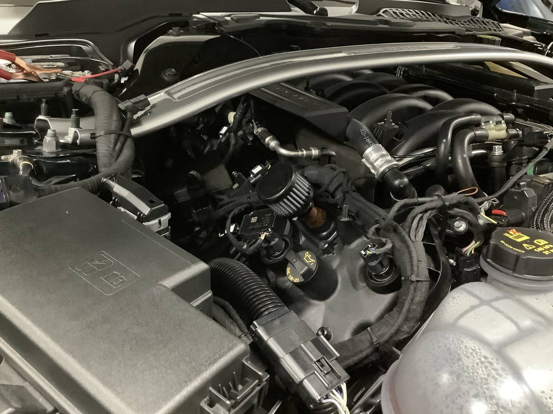

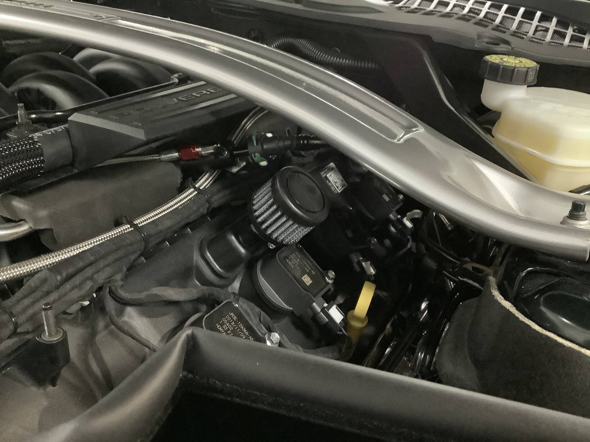

I received the breather filters today and installed them onto both valve covers, along with vacuum caps on the air intake tube nipple and intake manifold nipple. I started the car and let it run for about 10 minutes and I am happy to report that there were no engine codes. I’m sure my neighbors were happy to hear it come back to life too. Haha!
