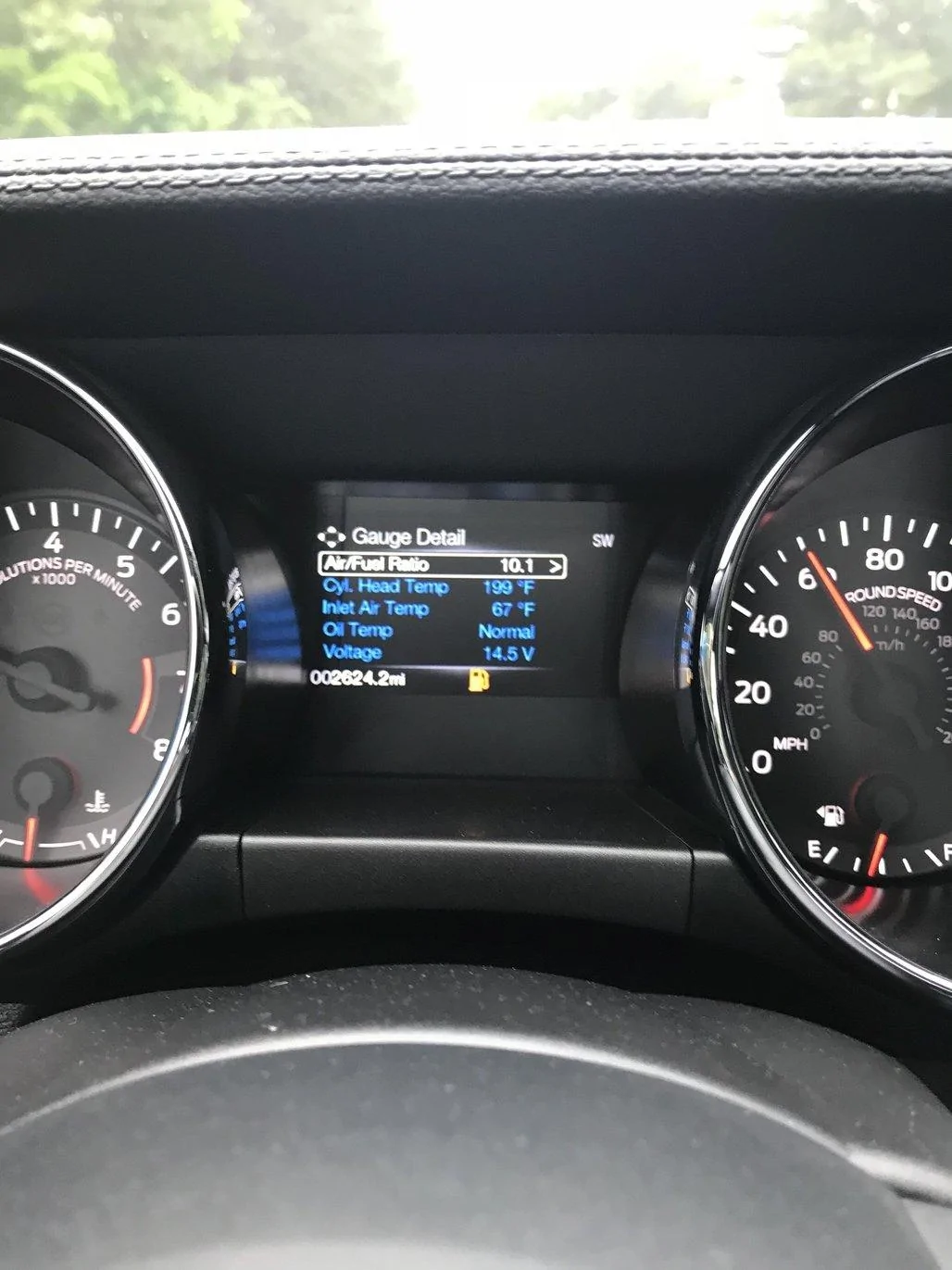

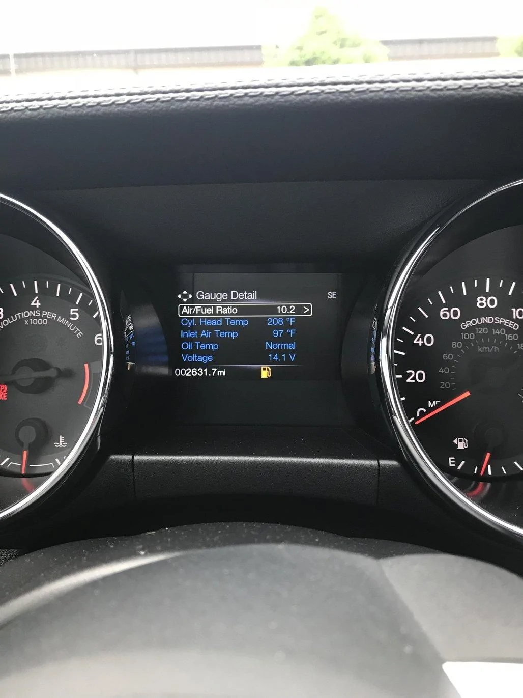

Had some promising results this morning. After warming up the car I only saw a 6 degree difference at 60 mph. prior to the the changes I made I would see a 20-30 degree temp difference while at highway speeds. The second picture shows my temps after getting to work and letting my car idle for 5 minutes. Again, way lower temps.

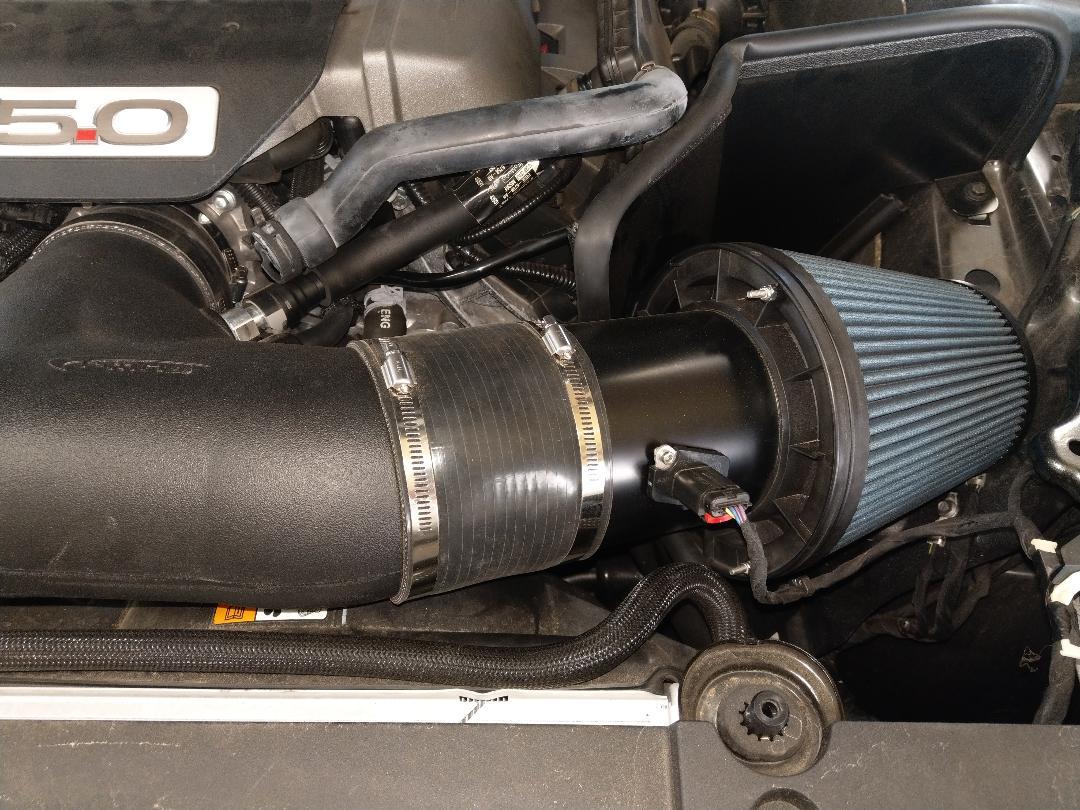

Here is how i have mine positioned. I have zero problems.

lol I changed mine to that position yesterday after someone posted about the MAF being close to the radiator. I did it last night so I haven't had a chance to see if it had any affect on the temps dropping. I am at work now by the time I get off is should be mid 90's so I will take a look. Another thing that I will look at is that on me and Grabbers Photos that the MAF is right up against the rubber couple where you seem to have a inch or 2 or space. Its not much but you manage to drop it deaper in the box and is something for me to try also.

I’ve had my meter in several different positions with no change. I also have the plastic MAF housing. In regards to E-85 fuel economy, I don’t even pay attention to it. I watch AFR’s and the gas gauge. Lol. I average 10.5 to 12mpg.
