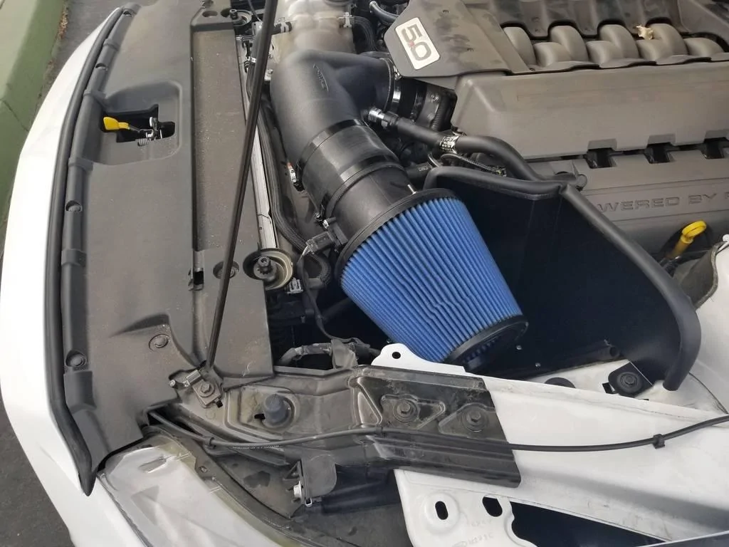

I installed my PMAS with lund tune and have been having an issue with the IAT's. I was aware that Open element typically had higher IAT's and was prepared to deal with that. However I guess PMAS change their heat shield design and this thing sucks heat directly from the radiator. Yesterday temps were 100 in my area of SoCal. Sitting in the parking lot of a store the IAT's read 162. Driving on the freeway at 75mph it went to 138. Driving at 45 to 50 on the streets it went back to 152. Added some pics just wondering if any one else is having issues with the new heat shield design? Also those that have a window mounted Nguage where are you running and hiding the wire?

Im dealing with the same issue with my PMAS. I’m working on an airbox extension that fills the huge gap between the radiator and the PMAS heat shield along with modifying the stock snorkel to attach to the heat shield as well. I love my PMAS intake but thier heat shield design is horrible.

Here is a picture of my GT. The green symbolizes where I’m going to install foam in an attempt to seal against the hood. The red circle is where the huge gap is located in the heat shield where hot air from the radiator is coming from. This is where I’m going to modify the heat shield.

I had that PMAS intake and had the exact same problem. It was unacceptable to me. The general consensus was that airflow was what matters, and not temperature. And that IAT would fall after you got the car up to speed.
And let me just say this, IATs never really fell once it you got up to speed. I could be cruising at 70, and IATs still read 140 on 70 degree day. And this was with the grilled opened up for max air flow.
I ended up swapping the intake out for the injen intake and bored out the injen intake tube.

It was 85 degrees the other day, in traffic intake temps were 130. On the highway they were 118-120 at 70 mph. IAT’s will naturally rise in traffic even with a completely enclosed intake but my goal in modifying the PMAS heat shield is to create positive pressure around the intake with fresh air and not hot air from the radiator like it does now.
When you say “grille” do you mean the portion in front of the radiator or just the section in front of the intake?
I removed the honeycomb in front of the intake, fitted Velossa Tech Big Mouth and had zero issues with heat once the car was at speed. :shrug:
I honestly think most of the heat issues are stemming from soak in the actual MAF housing and then transferring into the sensor directly.
