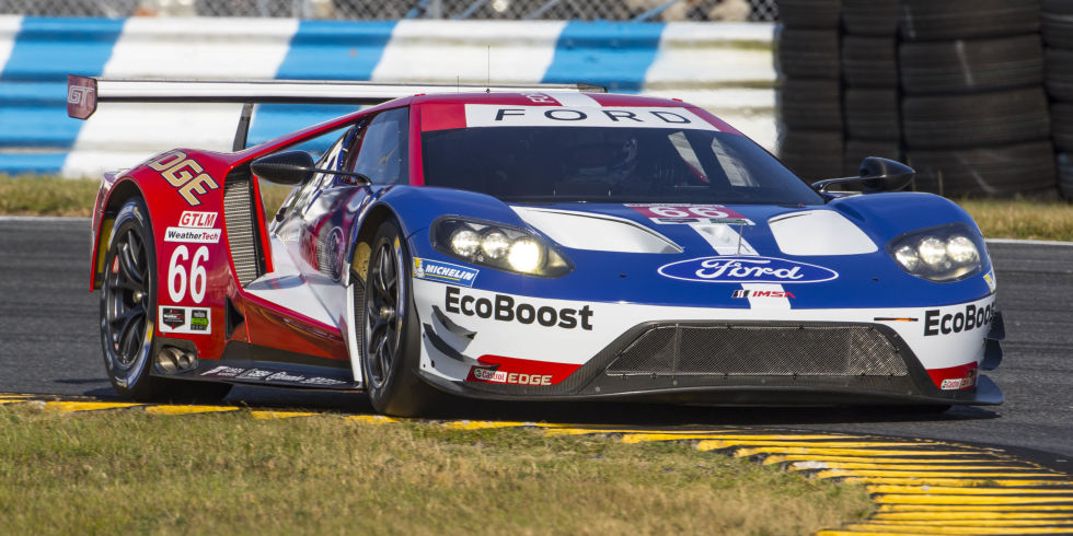

In these high end sports. If there was a real advantage to using a wing over a spoiler. Believe me. Someone would have tried it.
They did and they liked it. Wonder why these guys don't use a spoiler? Because their rule set allows them to use a wing.

Great photos. I'd post a bunch of race cars photos with spoilers. But I'm to lazy and the photos prove nothing for your spoiler vs wing arguement .

The main advantage to a wing over a spoiler is the ability to get the wing up in clean air and off the turbulent air flowing over the body. This provides clean, smooth airflow over all surfaces of the wing to help maximize downforce and minimize drag.
Drag, downforce and weight are the 3 sides of the aero triangle when it comes to designing splitters, spoilers, wings and such. Each side is a compromise. Tilt a spoiler up to get more downforce and you create more drag. Move a wing higher into cleaner air you create more weight in bracing.
If you think they're all for show remember a modern F1 car produces enough downforce at speed that it could drive upside down if it could get into that position first without crashing.
You are missing the point. There is no spoiler vs. wing argument and I never attempted to make one. Someone else made a comparison and you chirped in with your support. Do some research on the subject and find out how each works and why there are used. Basically spoilers reduce lift vs. wings create down force and both do what they do well.
At highway speeds they are for looks only. Even above any real benefit requires hours of testing in a wind tunnel, otherwise they cause drag.
Wings are a different thing entirely.
How different? A small wing and a small spoiler are very similar, with if anything the small spoiler being superior.
I'm pretty sure the statement above. That your replying to was just misinformation. Look at the Corvette Zo6. It uses a spoiler to supply down force. Another example of spoilers being just as good as a wing is Nascar and NHRA funny cars all the way down to door slammers. In these high end sports. If there was a real advantage to using a wing over a spoiler. Believe me. Someone would have tried it.
Your argument was basically that spoilers have to be better than wings, otherwise you would see them on high end (insert sanctioning body that does not allow or use wings) race cars. The pictures show that is not the case at all. NASCAR tried wings and they worked great at sticking the car to the track. They also tended to act as an aircraft wing should the car get sideways at 200mph. Also the fans didn't like the way the cars "looked".
As mentioned in a post above, the highest of high end motorsports, F1, uses wings because the down force they create could allow the car to drive on the ceiling at speed. Let's see a spoiler do that.
