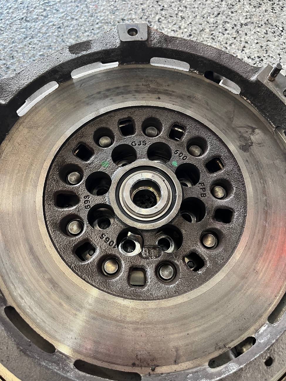

Thanks for all of the input. The bearing is in the flywheel. The ford dealership could not get it out. They used a puller and slide hammer. The shop mechanics told the transmission guy that it is not a replaceable part. Buy a new fly wheel. I bought correct part number from LMR. All parts are being replaced. Slave, pilot, clutch, pressure plate and now flywheel. I’ll try to get the mechanic to show me their internal parts and tech order system that says replace flywheel because pilot bearing is not serviceable. I don’t understand it but that’s what Ford says. Their service supervisor said put in a new flywheel on their dime. I would hope all of these levels of people wouldn’t give away a $700 part if the bearing would come out. I could be wrong.

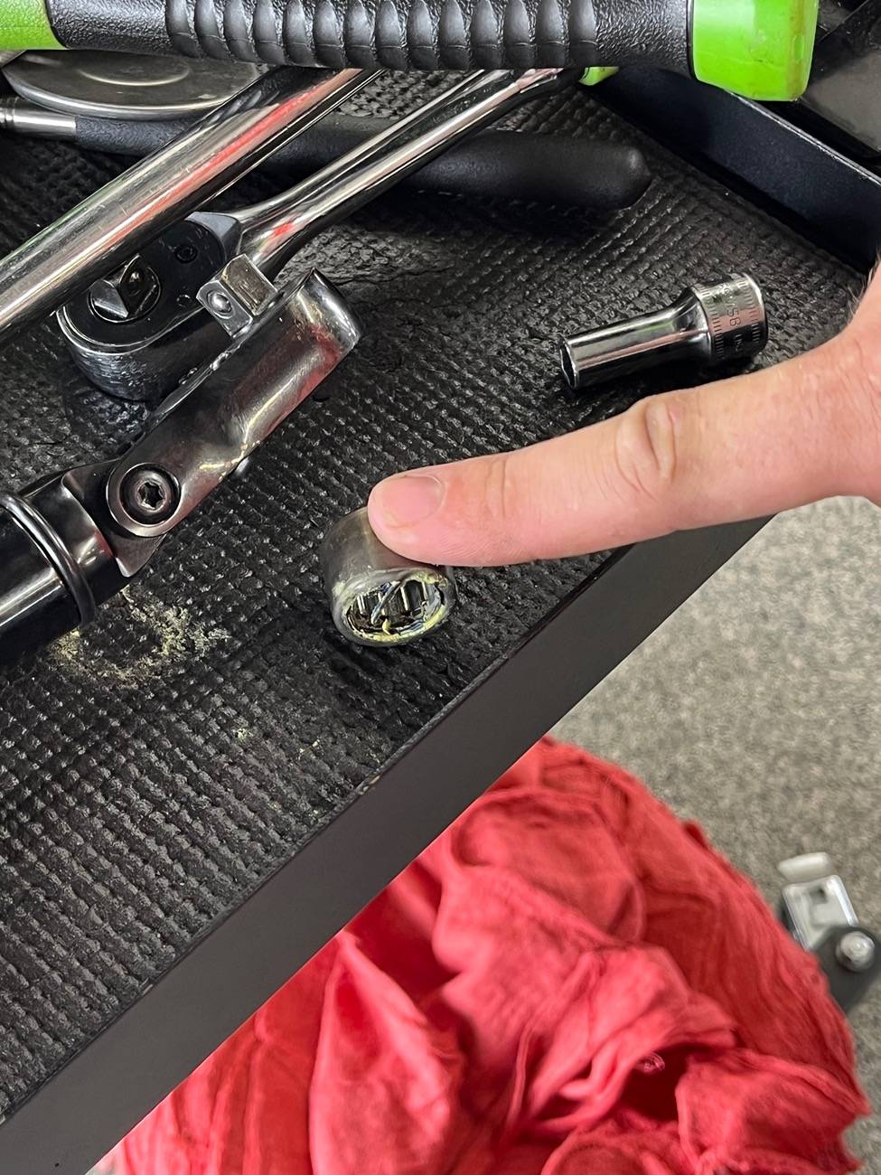

That small piece with a finger pointing to it is what came out from the middle of the pilot bearing. The other pic is the flywheel with the remaining pilot bearing pressed into it
Hello; That is a damaged roller bearing and can be seen it is located in the structure in the top picture. Again, my knowledge is dated as that does not look like a flywheel to me. I do not see the ring of teeth usually found on a flywheel for the starter to engage. Without being told i would have thought it was a picture of a pressure plate.
It’s a dual disc clutch setup if that makes a difference. Probably does.
Hello; I am going to make a guess or few at this point. I suspect the item pictured is part of the dual clutch assembly. A pressure plate. Two clutch disks ought to require two pressure plates with one of the pressure plates needing that sort of bearing to ride upon.

I agree the pic is misleading. That is the flywheel and the teeth are not visible. You can see the surface has some bluing from where the clutch has been riding on it.
