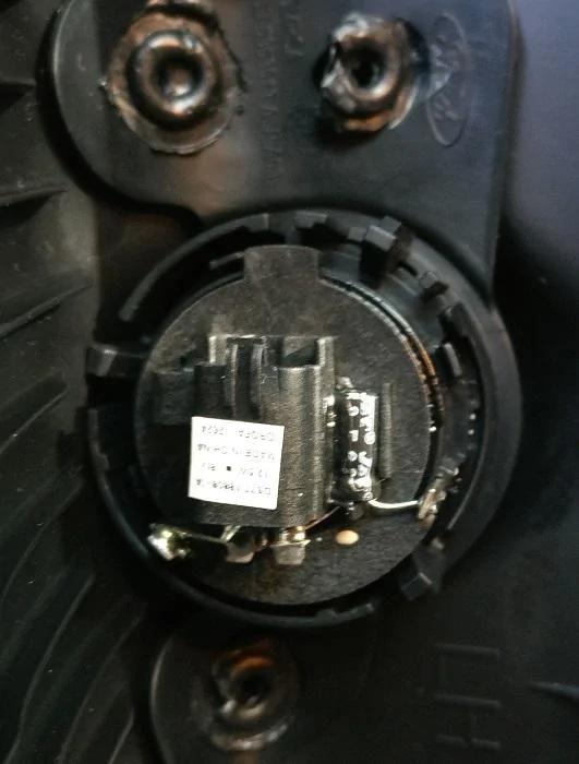

I never found the split but did not search that hard. In the base 6 speaker system the tweeter crossover is just a small capacitor attached to the tweeter, see post #8. I ran a new wire of a similar gauge to my trunk and it took less than a 1/2 hour total for both sides. I did use the factory wiring for the door speaker as replacing that looked like a major endeavor!
That is exactly what I decided to do. I followed the OEM tweeter wire into the dash and can see where it splits off from the door speaker. If you look up under the dash at the door wiring loom and its plug on the side of the kickwell where it goes into the door, the split is a few inches from that. Getting access to that is definitely not a small endeavor. Not worth the effort.
I took the OEM front speaker output and ran it to the high level input for the front channel. Then I ran the amplifier output for that channel to the crossover for the component set. I then re-used the OEM wiring for the door midbass by running the crossover output for that speaker back into the OEM wiring. I left the OEM tweeter wiring tucked away and ran a new wire from the crossover tweeter output up to the tweeter, which is installed in the OEM location. My 5 channel amp and Polk crossovers are under the passenger Recaro seat. I will post up some pics later.

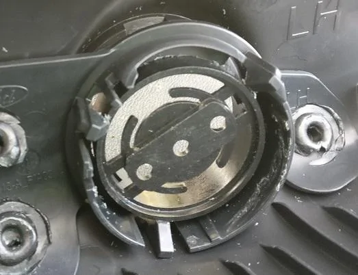

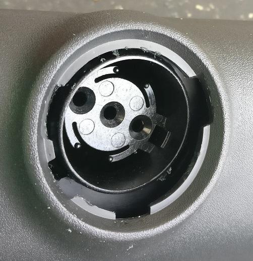

Any 1" tweeter will fit in the stock a pillar. You can either surface mount it with a bit of dremel work, or use the stock mount and get it in behind the stock grill.
I'm on my 3rd set of 7/8" to 1" tweeters (testing) and so far only actually fit from behind (Dayton AMT), 1 COULD mount in the hole with the grille removed and some Dremel work done (Polk DB1001) and 1 won't fit at all (Pioneer TS-T110).
Next up, JBL GTO19T and the Rockford Fosgate Prime R1T-S

Just had the Hertz Mille tweeters installed in the a pillar without any issues. They even have the stock plastic molding on top. new tweeters are 1.14" in diameter.
