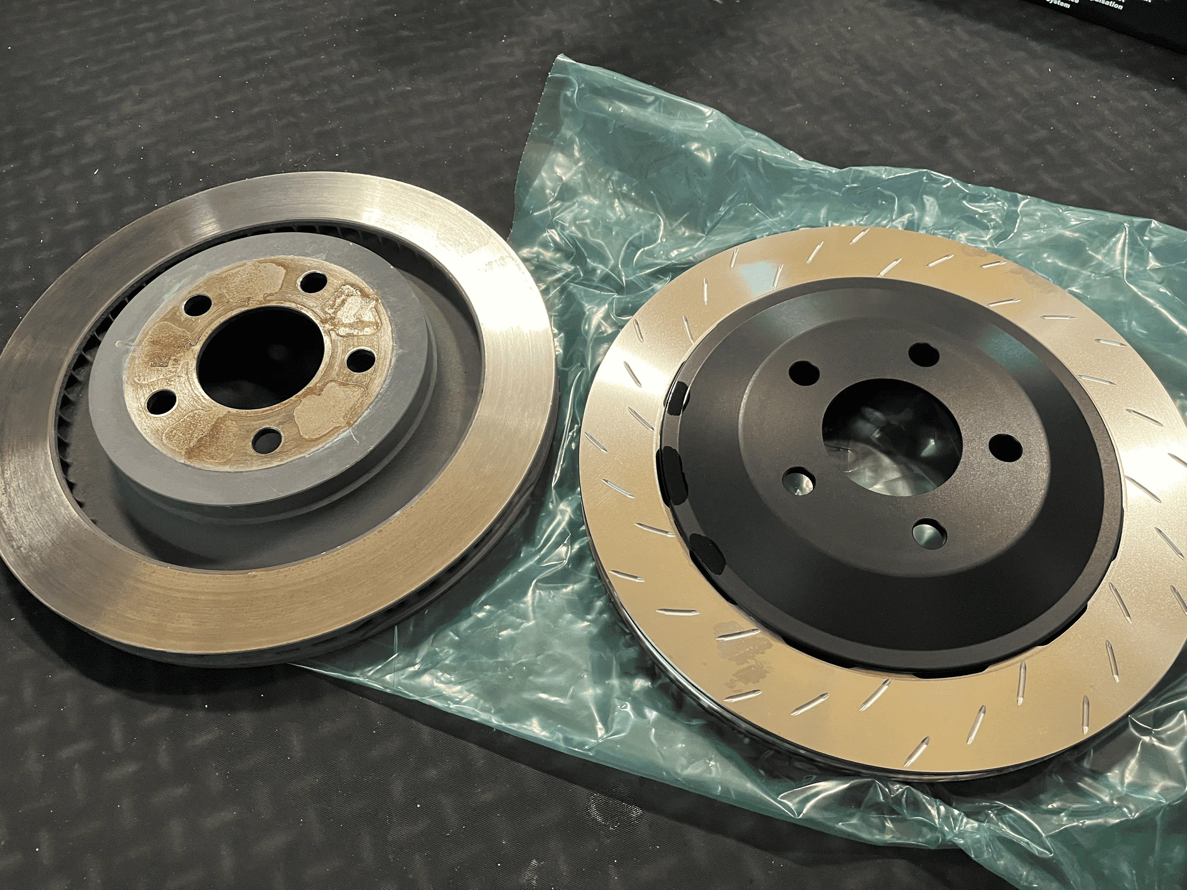

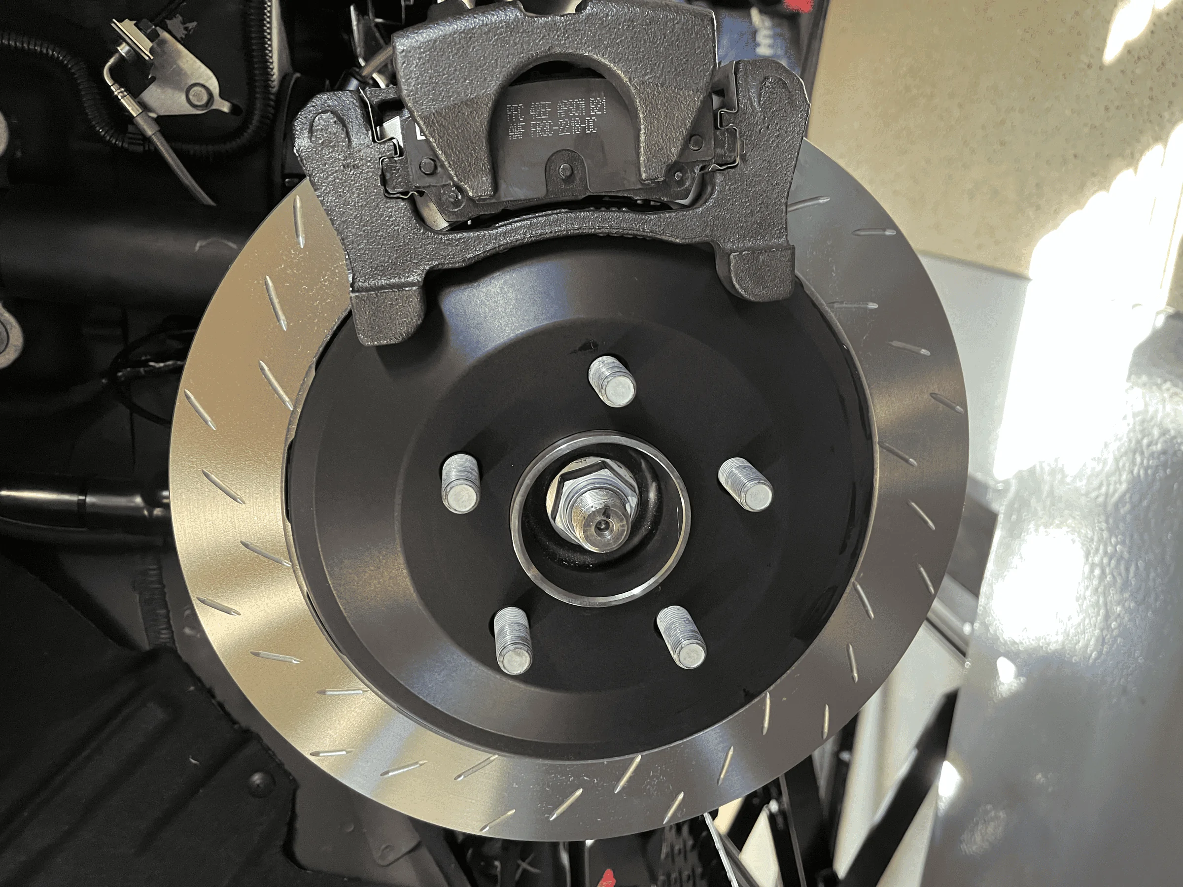

For those of you who track your cars if you are looking for really good, high-end rotors such as A P Racing, Girodisc, Baer or others, Performance Friction is worth considering. Manufactured in USA (South Carolina), unfortunately you have to order from the UK. However, even with 2-day air freight they are still price competitive (or less) and the ordering process is simple enough and shipping is amazing. Thought I'd wait a week or two but there they were mid-week (same week as ordered). Pictured are set of rear rotors for S550 Mustang (I think PP and Mach 1 are same). This set was $912 and no duties since it's US manufactured. My friends and I have run these on multiple other vehicles and their quality, performance and durability are outstanding. Also, no spindles, clips, washers or bobbins to replace when you do a rotor change. Super simple, pop out circular spring, put in new rotor and put spring back in, done.

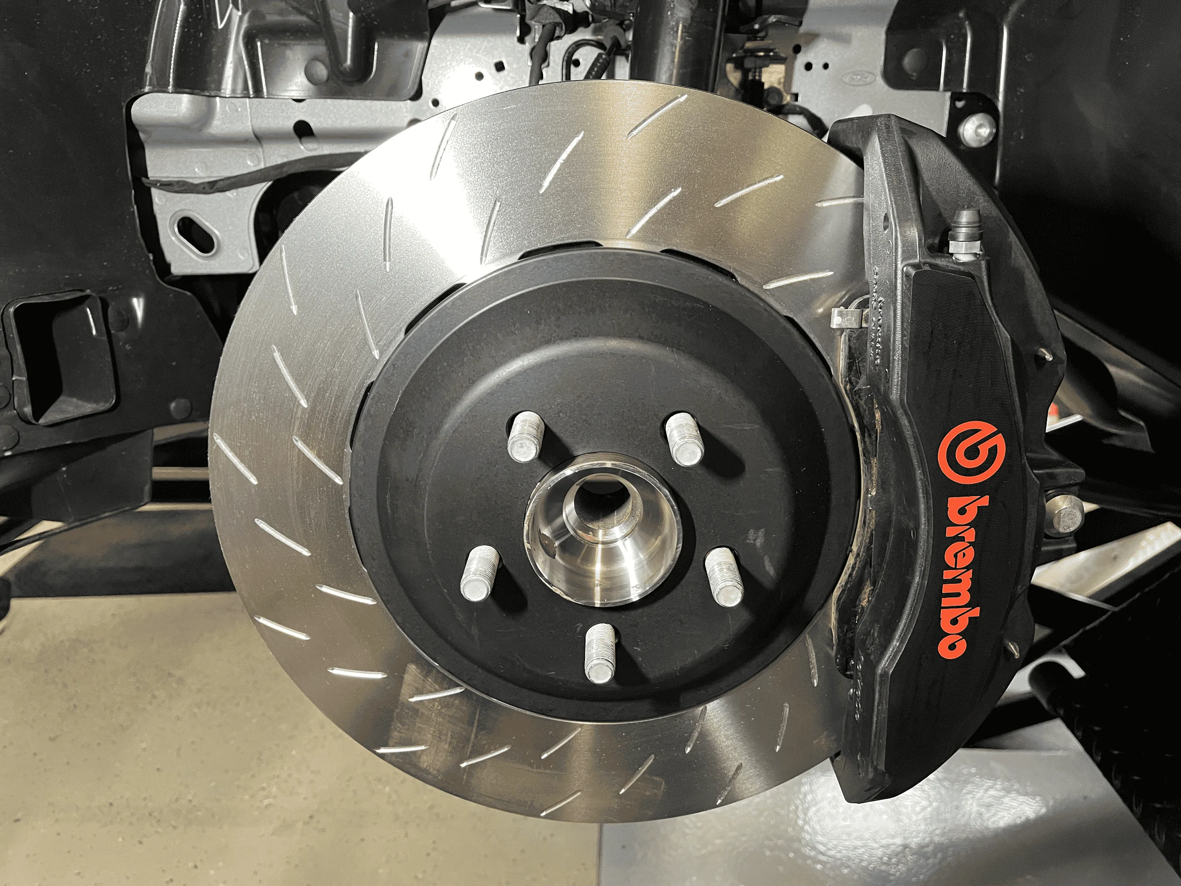

This is what the front rotors look like, if anyone is curious. Didn't weigh the stock fronts but they are a lot heavier than these.
Changing brake pads BTW is such a breeze! Super nice and effortless.
did we confirm that rotor isn't on backwards?
They come with very nice instructions, but some manufacturers do have the slotted part going the other direction. What's more important though is the direction of the internal veins for air flow, and they are correct.

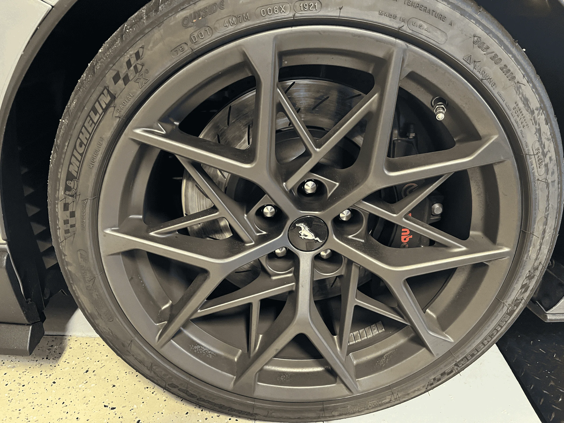

Ran half-day event with JZilla at Road Atlanta today. Weather was great, perfect temps and no rain even though thunderstorms had been forecast. Ran all 4 sessions, the last two with friend as passenger who is car enthusiast but not a driver. This is just a brakes report.
PFC front and rear V3 rotors, Pagid RSL 29 pads front and rear, PFC 665 brake fluid. What can I say, really great. Totally rock solid brake pedal from beginning of session to end. No fade whatsoever and super consistent lap after lap. Never had any doubt coming down the hill from the back straight to turn 10a. Ran much of the last two sessions with good friend who has late model GT3, obviously no comparison on speeds on the straights, he just walks away every time but under max braking no problems staying in there in the braking zone. Hard to see in the picture but that color and coating is almost all brake dust. Stock calipers are really good BTW.
