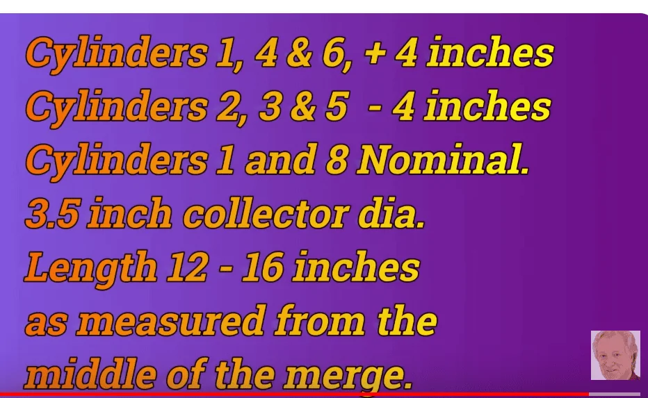

I just watched your header video. My teacher for headers was Ed Henneman (sp)
Everything he was saying in the 60's about tube size I see you agree with.
So now if I take my Ed designed headers that fit my big block Nova and add 4 inches to the primary of 1, 4 and 6 along with subtracting 4 inches from cylinders 2, 3 and 5 I will make more power? What about cylinder 7?
In your video you used a 572 but did not give final power numbers, unless this was the same engine referenced earlier in the vid.

I still would like a clarification.Where does cylinder 7 fit? You are using cylinder 1 twice. I doubt 7 and 8 would be nominal.
Next question do you know why these cylinders need differing lengths? Is it because the intake manifold has differing length runners?
All I know is Ed was/is (Not sure if he is still with us,) a pretty smart guy who has been proven correct over the years.

Mr. Shogun32
My apologies here. I was under the impression that we were discussing the unequal length deal not exhausts in general. Just to clarify I have never seen anything on unequal length headers before.
David Vizard

You still won't answer my question.
