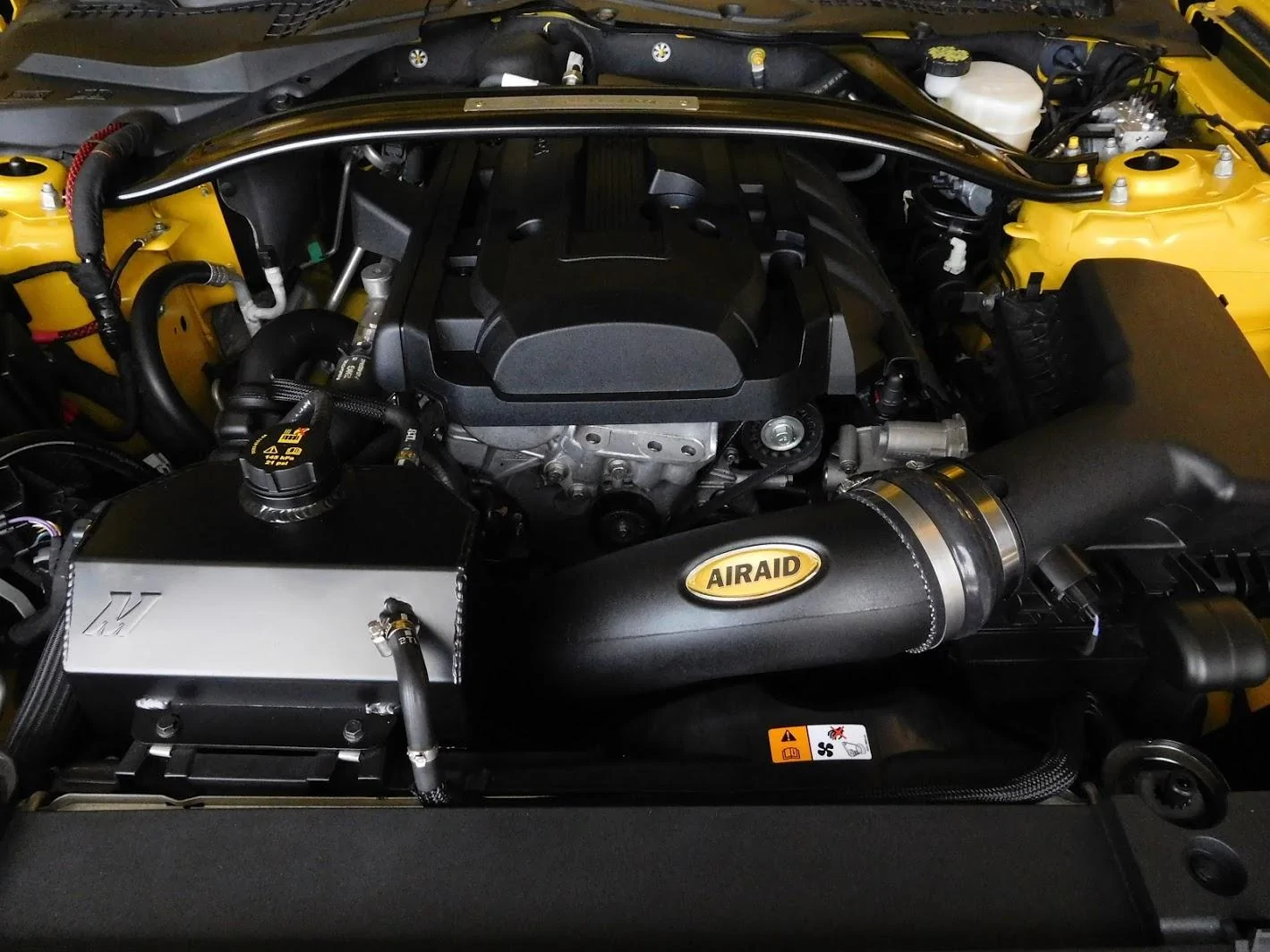

2015 Mustang Ecoboost Premium
Mishimoto coolant tank.

Owltown
Feb 15, 2019
North Georgia
2019 Race Red Mustang GT PP1,
the water tank has changed on the 2019 PP1 to a gray plastic tank
