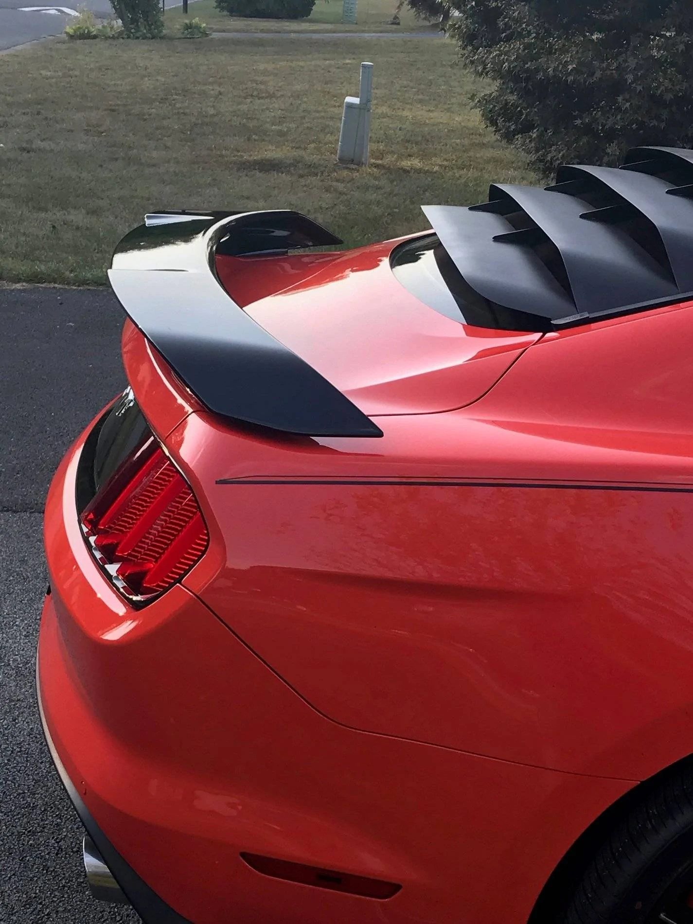

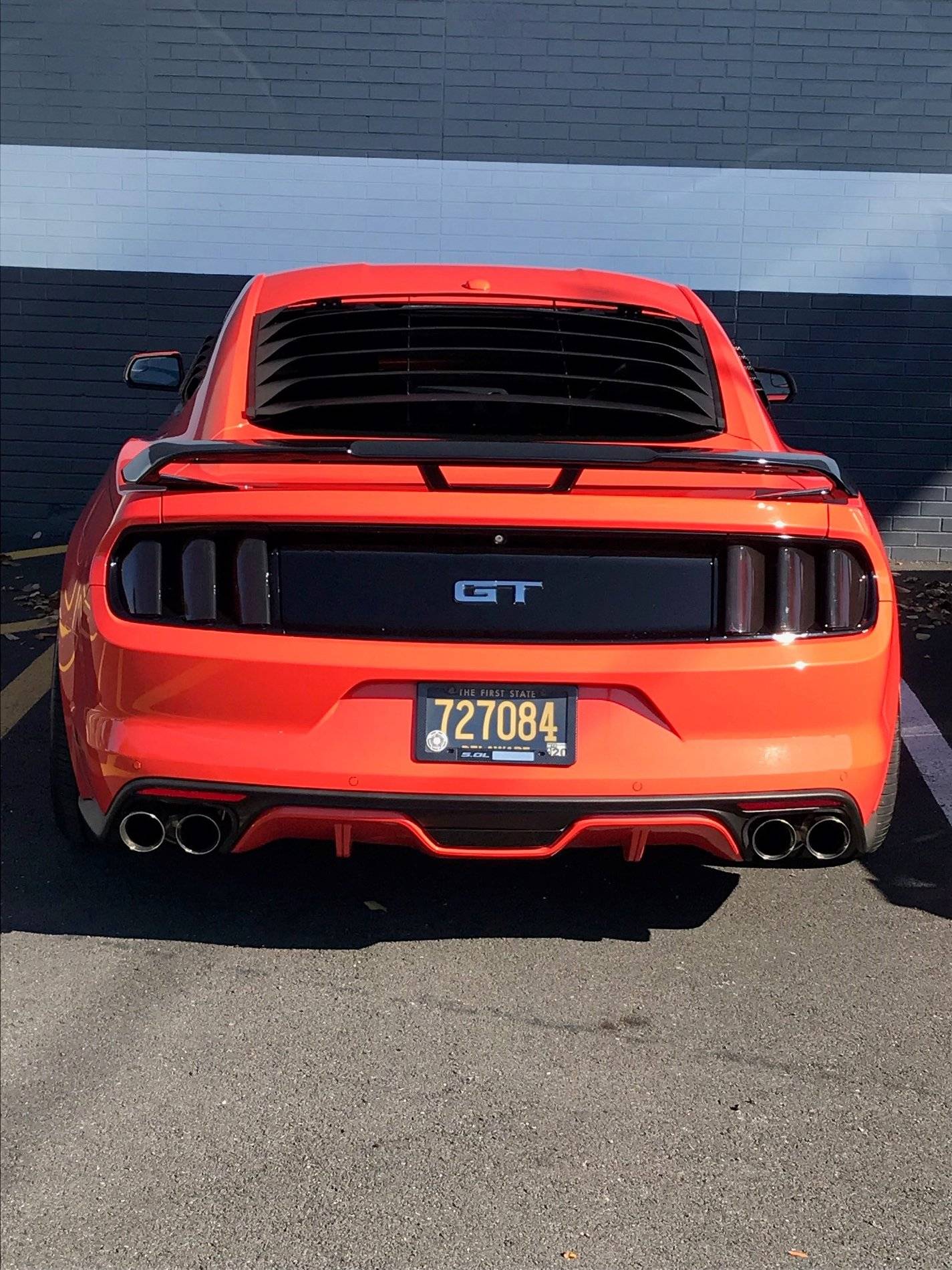

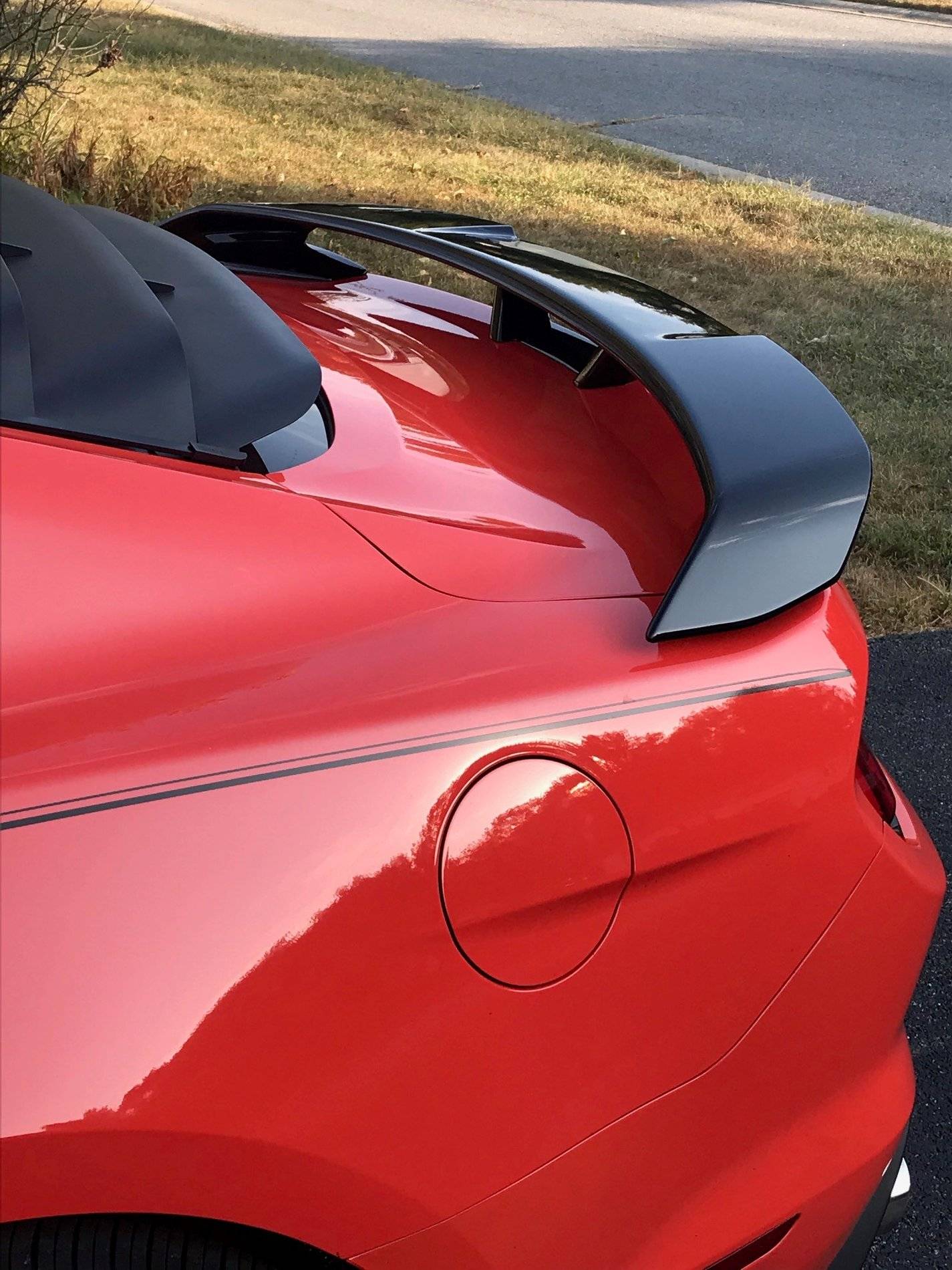

Here's some pics of my pp spoiler install from this past summer. Biggest pain is removing the old blade spoiler and removing the old tape as others have stated. Pretty easy install though.

I can't say I noticed anything at high speeds with the spoiler, I did it for looks as I couldn't stand the small blade spoiler and was looking for factory style options. I don't belong to any lodge.
