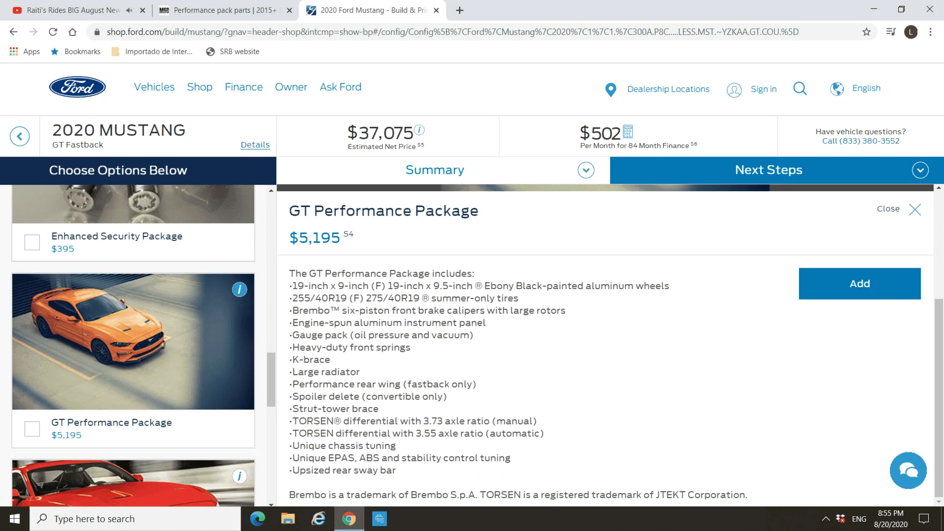

Go to ford.com and select the pp1. Click details and you will get a list with the components.
Not even close....... try again

Not sure what that is suppose to mean? You might want to check the PP2 and have a slice of humble pie while reading

The OP wants to upgrades his non pp to a pp mustang. Thats the list of the pp components. No need for drama.
