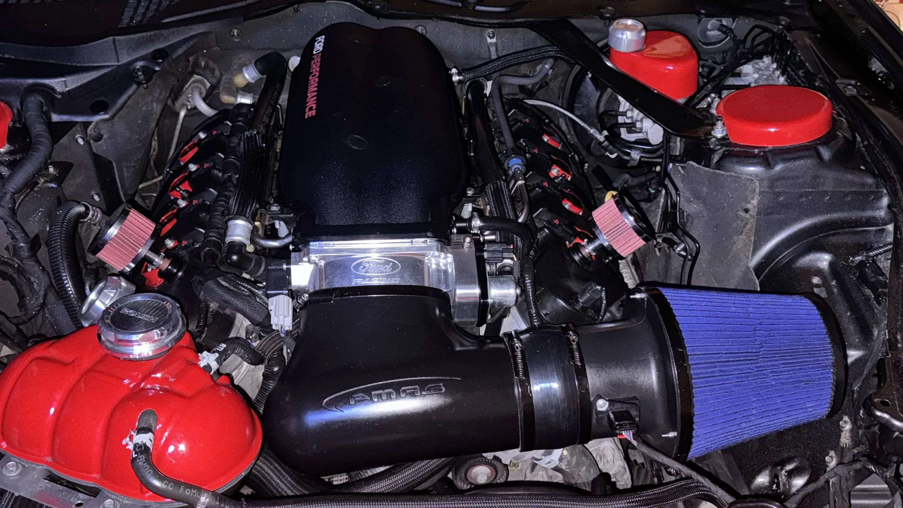

Since i’m running breathers i removed the check valve from the passenger side PCV.I heard from someone today that you should not remove the check valve. Any help with this will be appreciated .This cobra jet manifold and e85 is badass up top.

You did good by getting rid of the check valve.
Great looking engine.
