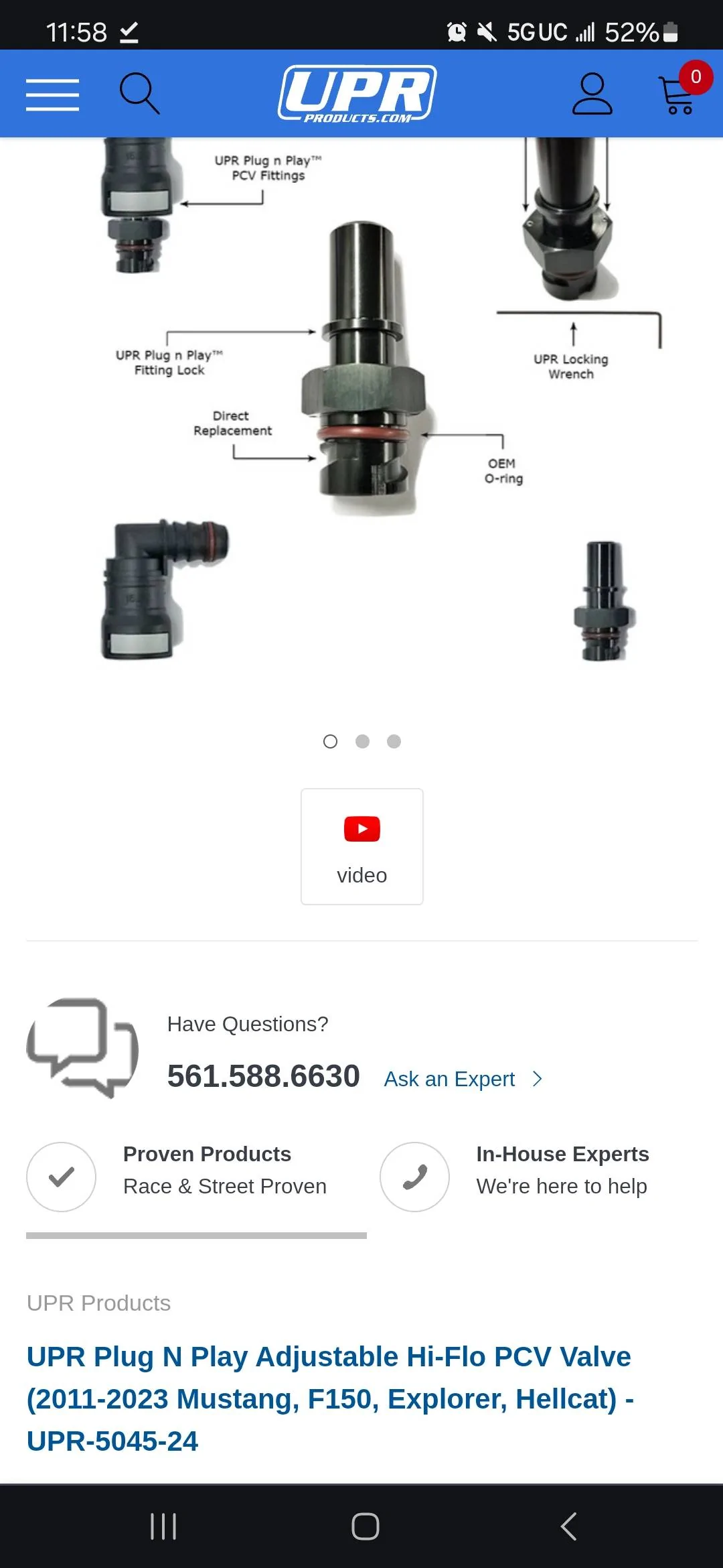

Hey guys I ordered a Hi flow PCV from UPR, does anyone know if I need to run 2 of them passenger and driver side? Or just on the passenger side since that's the one that vents the most ?
Anyfeed back would be great thanks!

You only need the passenger side. Drivers side is for fresh air intake.
Thank you!! This is what I needed to know, thanks bro!

No problem bud. Keep in mind you want the integrated check valve if you're routing back to intake or using a catch can that doesn't have one.
I'm using a UPR with catch can with a vented Breather built ontop and ima put this billet pcv on passenger side and leave the oem on driver side, should be good right?

Depends on how you are running the driver side.
If venting to atmosphere it is best to vent both sides
No the driver side will be connected to the vented catch can and the passenger is also connected to the same vented catch can just the passenger side will have the billet hi flow pcv valve

In that case you have them both vented to atmosphere. Personally I'd get rid of the PCV valve since it has a check valve in it. I'd put a driver side fitting in the passenger side. No check valve.

So wait should I get a passenger and driver side billet hi flow pcv valve is what your saying,?
